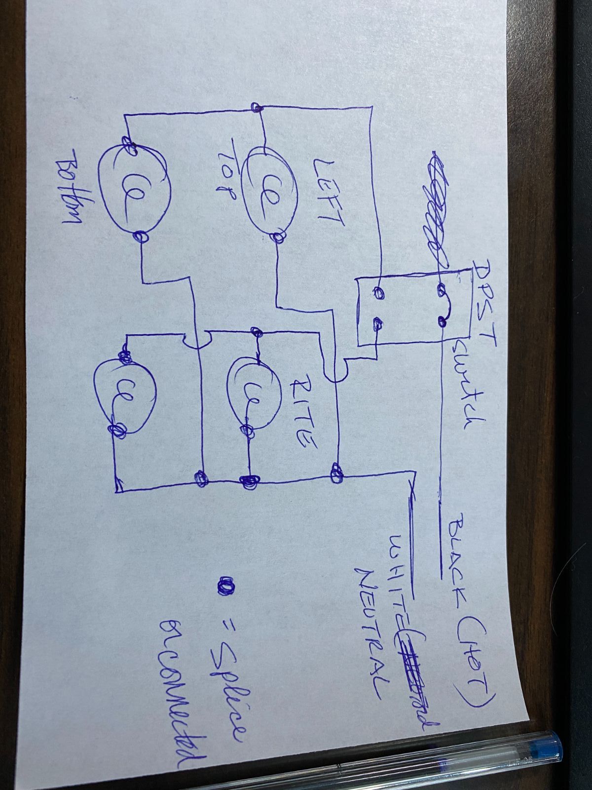

I think this is what you have, if there are 3 wires connected to the switch.
It seems like there is either a bad socket or a loose wire. Unless you can get the light fixture freed from the cabinet, removing the cabinet may be the only option.
Lew, thanks for the drawing!!!! The light that is out, has 3 wires going to it and their connection to the socket seems to be solid. I may be able to access the switch from the opening, for that socket, but I'm afraid of breaking the wiring, leaving me without any lights at all.

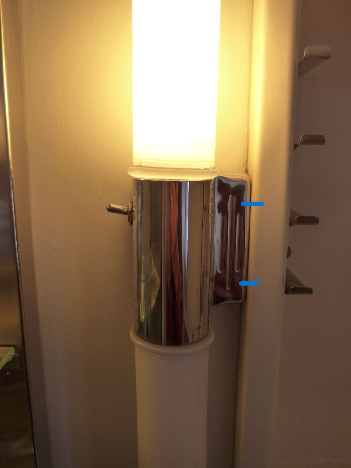

The light fixture is bolted to the cabinet at the face frame.
Looks like I have the Rite/Left labels reversed on the drawing but the basic operation is correct.  @DuckSoup's comment about the socket connections would be my next thought, also. Sometimes the contacts in the sockets get bent over time and don't make solid connections. If you decide to go bend the socket contacts, you might want to turn off the breaker for the bathroom, for safety.
