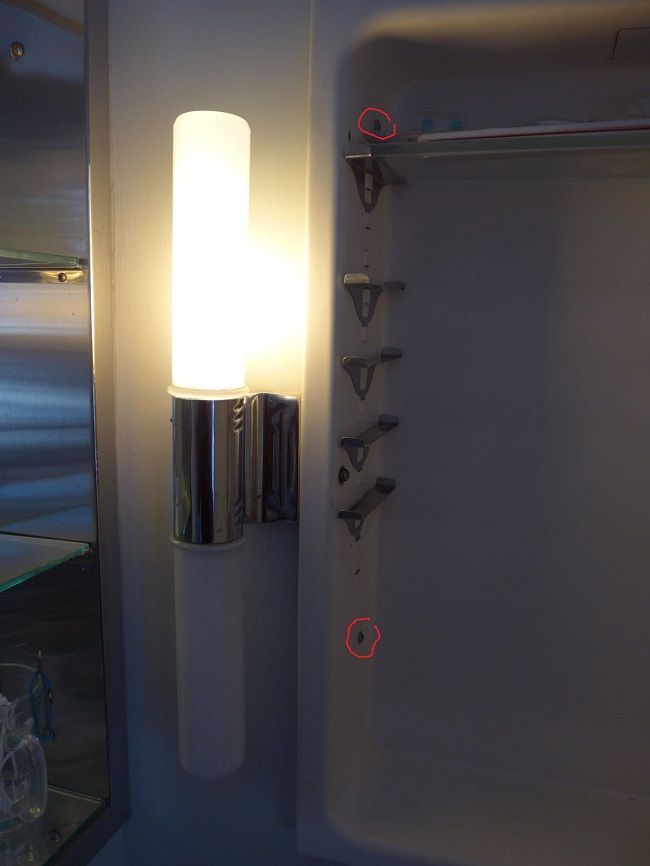

FrederickH Posted January 22 Report Posted January 22 I have a bathroom light that was installed in 1953, when the house was built. In all of the bathrooms, a 4-light medicine cabinet was installed above the sinks. One of the two side lights has stopped working and I can't access the medicine cabinet(has two of the left side lights) to check the wiring and can't remove the cabinet without major damage to the surrounding plaster. I can post a photo if this post is allowed, to show the problem. Any advice would be appreciated. DuckSoup, Grandpadave52, lew and 1 other 4 Quote

FrederickH Posted January 23 Author Report Posted January 23 Here are some photos of the offending bathroom light. They are a tubular incandescent light(4). DuckSoup 1 Quote
lew Posted January 23 Report Posted January 23 What happens if you remove just this screw/bolt? HARO50 1 Quote
FrederickH Posted January 23 Author Report Posted January 23 "What happens if you remove just this screw/bolt?" Lew, that fooled me at first but it's the button catch for the glass door!!! HARO50 and lew 2 Quote
HandyDan Posted January 23 Report Posted January 23 These two screws and two on the other side appear to hold the whole cabinet in. My guess anyhow. HARO50 and lew 2 Quote
Ron Dudelston Posted January 23 Report Posted January 23 I think Dan is right. Are there two screws on the right side also? HARO50 and lew 2 Quote
FrederickH Posted January 23 Author Report Posted January 23 "These two screws and two on the other side appear to hold the whole cabinet in. My guess anyhow." Yes, there are two screws, right and left, but they hold the cabinet in(my guess). lew and HARO50 2 Quote
lew Posted January 23 Report Posted January 23 I wonder if the white glass "globes" unscrew from the metal base HARO50 and FrederickH 2 Quote
HandyDan Posted January 23 Report Posted January 23 (edited) 26 minutes ago, FrederickH said: Yes, there are two screws, right and left, but they hold the cabinet in(my guess). It appears the cabinet is going to have to come out to make any repairs to the wiring. The cabinet may be stuck to some paint but should come out without wrecking any plaster. Edited January 23 by HandyDan HARO50, FrederickH and lew 3 Quote
Fred W. Hargis Jr Posted January 23 Report Posted January 23 I think Dan is right, it probably has to come out and shouldn't damage anything when being removed. You may have to watch to see how much slack is in the wiring as it comes out. HARO50, FrederickH and lew 3 Quote
lew Posted January 23 Report Posted January 23 Just so I understand, you have changed the bulbs but that didn't help? FrederickH, Fred W. Hargis Jr and HARO50 2 1 Quote
FrederickH Posted January 23 Author Report Posted January 23 1 hour ago, lew said: I wonder if the white glass "globes" unscrew from the metal base The globes do unscrew to gain access to the bulbs. The bulb is a new replacement but still doesn't work. HARO50 and lew 1 1 Quote
lew Posted January 23 Report Posted January 23 With the globe unscrewed, can you see any mounting screws inside the chrome base that may connect to the rectangular mount? Fred W. Hargis Jr and HARO50 2 Quote
lew Posted January 23 Report Posted January 23 If you take the globe off of the left, upper light and remove the bulb, you should be able to see the back of the switch. Are the two connectors or four connectors? Fred W. Hargis Jr and HARO50 2 Quote
FrederickH Posted January 23 Author Report Posted January 23 1 hour ago, lew said: If you take the globe off of the left, upper light and remove the bulb, you should be able to see the back of the switch. Are the two connectors or four connectors? I've gotten off the lower socket(pulled down) and could see that the wires(3) go up to the switch. I'm, afraid that if I pull on things that the wires will break and I'm not sure if I could remove the switch through the openings that are there. I did remove the hex nut from the switch side and was able to move the switch in and out a bit. HARO50 and lew 2 Quote
