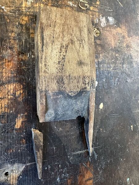

March 21Mar 21 Author comment_373244 Got the iron straight, should answer fine.Cleaned the body if the plane with some steel wool and mineral spirits. Went to the wedge and one of the tangs snapped off. Next step, make a new wedge. Luckily I’ve got a bunch if white oak the perfect size for that. Report
March 21Mar 21 comment_373247 15 minutes ago, Zack said:Went to the wedge and one of the tangs snapped off. Next step, make a new wedge. Luckily I’ve got a bunch if white oak the perfect size for thatBummer. Good to have inventory on hand though. Nice recovery on the iron. Looks good. Edited March 21Mar 21 by Grandpadave52 Report

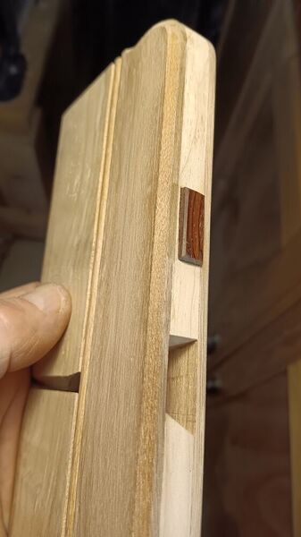

March 21Mar 21 Author comment_373249 The top front of the body is getting caved in from hitting it to loosen the wedge. I’ll probably add a strike button to relieve some of the abuse. If Mr. Rick sees this I’d like his advise for specs on adding a button. Report
March 21Mar 21 comment_373251 28 minutes ago, Zack said:The top front of the body is getting caved in from hitting it to loosen the wedge. I’ll probably add a strike button to relieve some of the abuse.If Mr. Rick sees this I’d like his advise for specs on adding a button.@MrRick , Suggestions. Report
March 21Mar 21 comment_373252 Strike buttons are added on top of plane just ahead of bed cavity. I usually start it about 3/4" from the front of bed cavity edge. The button should be made of a very hard material equal to or harder than Maple. Check the Janka hardness. Should be at least 3/16" thick. Length and width depends on plane surface where you are inlaying it. I make a very tight cavity by chisel. Use Wood glue. Sometimes I use CA.Cheers!MrRick Edited March 21Mar 21 by MrRick Report
March 29Mar 29 Author Popular Post comment_373642 ….and so to the wedge. I have a length of white oak so bowed it’s only good for cutting into short pieces. The dimensions are perfect for this wedge, so it’s the prime candidate.Cut a piece off and worked it to the basic size. Made a template to represent the full wedge angle. The iron and the chipbreaker are tapered, so they need to be figured into the actual angle the wedge needs to be. I assembled the chip breaker to the iron and layed it on a flat plate, set the wedge block on top of it. Put the template on the plate against the wedge block and marked the angle on the block. Sawed off and planed down to the line.Cut a groove in the back for the chipbreaker screw. Marked out the tangs and shaving relief. Cut and tweaked until I was satisfied with the fit.Repaired the handle and installed a hickory strike button. I’ll put some tung oil on it and call it good. Report
March 29Mar 29 comment_373647 Nice work @Zack I wouldn't use Oak for the wedge myself. Though White is better than Red, both are somewhat porous. Maple would be far better. Hard maple, with a Janka rating of ~1450 lbf, is an excellent choice for wedges. Report
March 29Mar 29 comment_373654 Amazing what a talented person can accomplish when they have the desire .looks good to me Report
March 29Mar 29 comment_373655 Excellent save and restoration Zack. Great job on re-creating the wedge. Looks factory original. Looking forward to seeing and hearing about it in use. Report
April 1Apr 1 Author Popular Post comment_373739 A little tung oil and a coat of wax. Done deal. Report
April 1Apr 1 comment_373742 Incredible transformation Zack. Great save and vision to do so. Thanks for recording and sharing here. Great help aid for the next up restorers. Report
