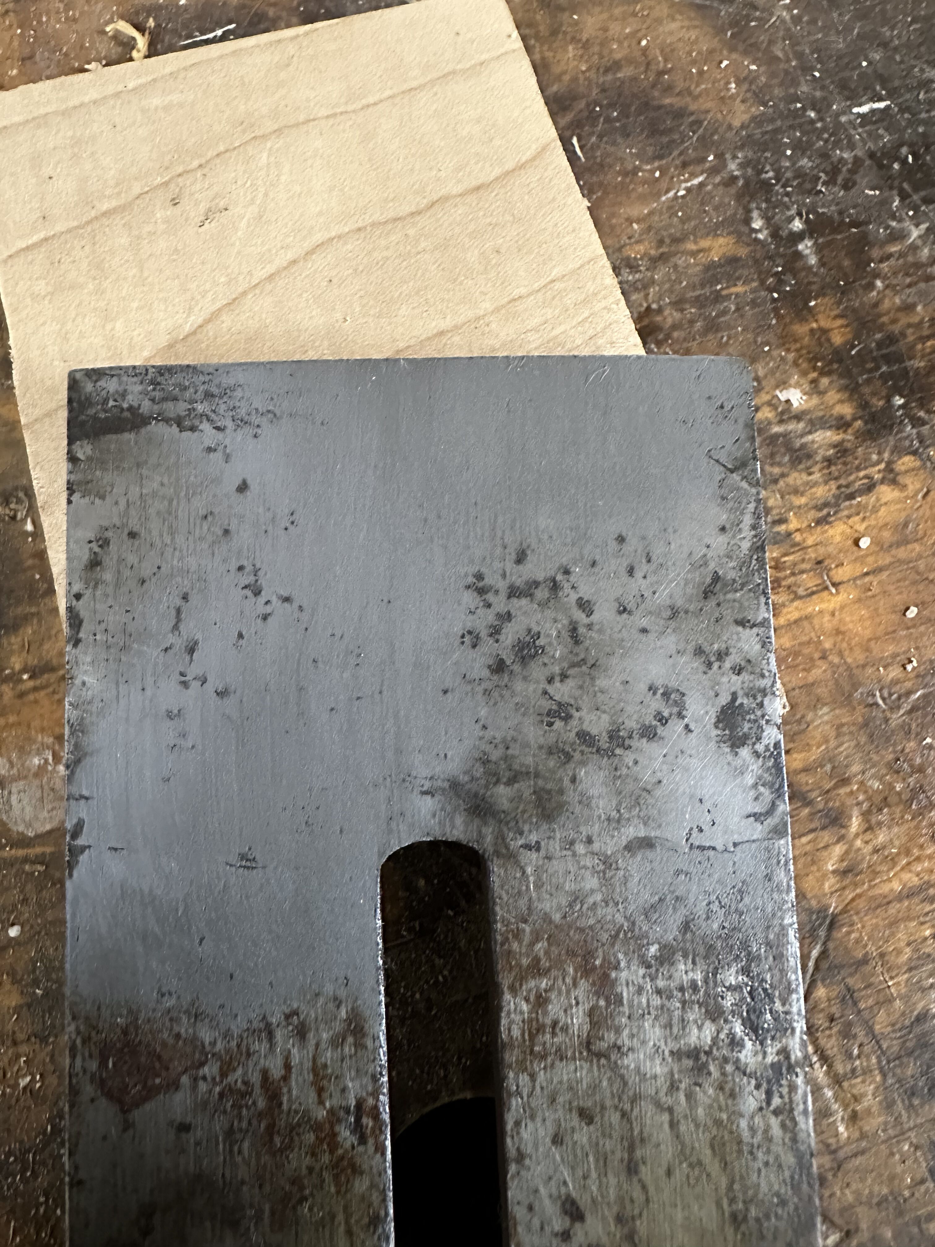

 26” wooden jointer plane. Complete with iron, chipbreaker and wedge. Needs a little work to get it back in shape but pretty sweet. The iron shows Providence Tool Compay and is bimetal, cast iron to carbon steel. Not sure if it’s original to the plane but it’s about right for the period.

Hey Zack, school me on this one, how did ya know?
If you look real close at the side you can see a clear line where the iron meets the steel. The iron is rusty and grainy but the steel is still almost shiny. You can see the same characteristics comparing the top surface to the bottom surface. It was how they used to make plane irons and chisels before metallurgy got better. High carbon steel was a little hard to come by and was too brittle so they would weld thin pieces of it to plain iron. My first clue though was the manufacturers marking where they call it “cast steel”.

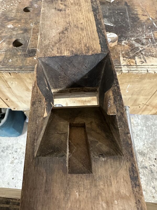

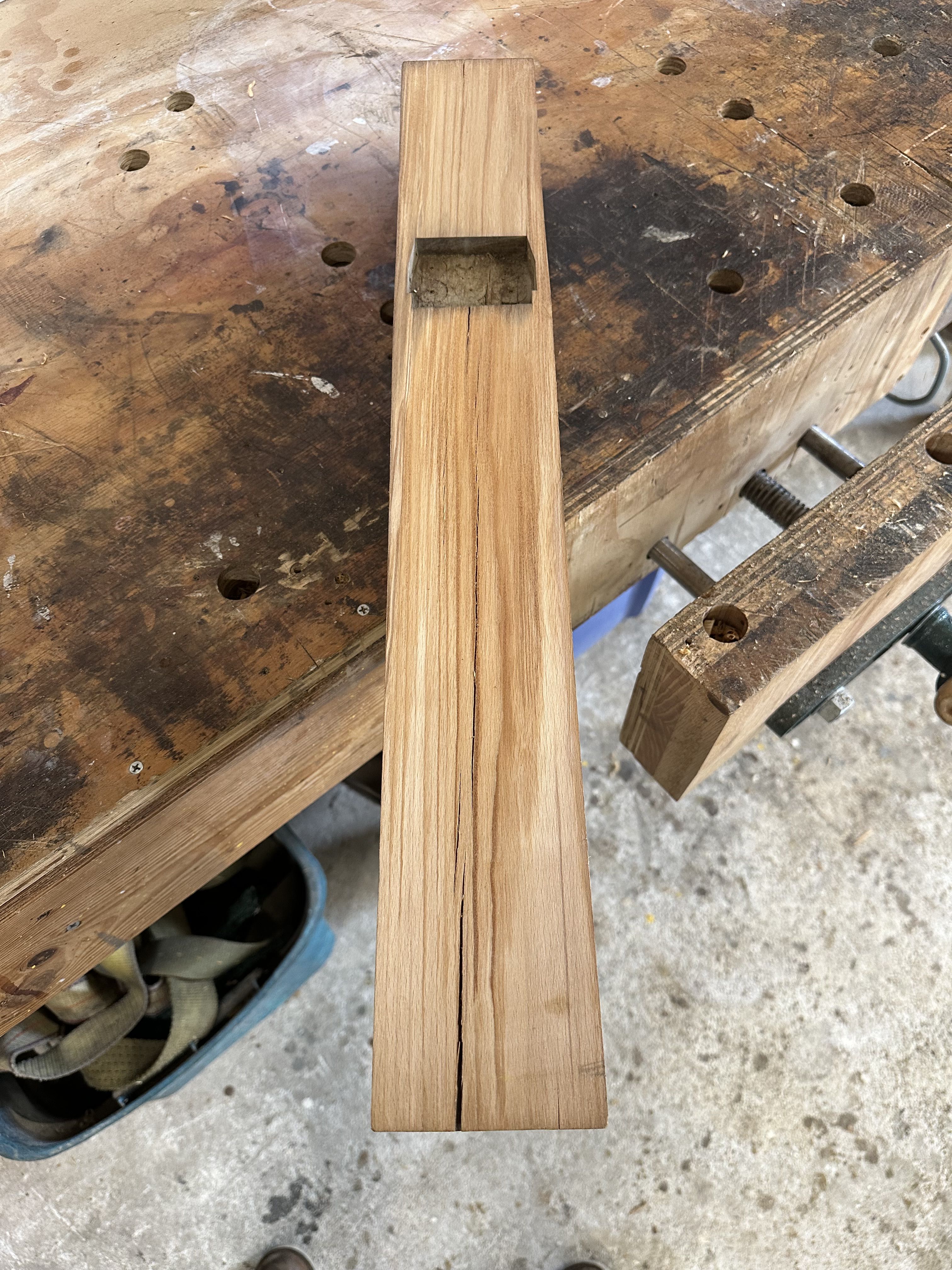

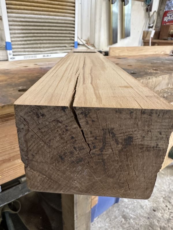

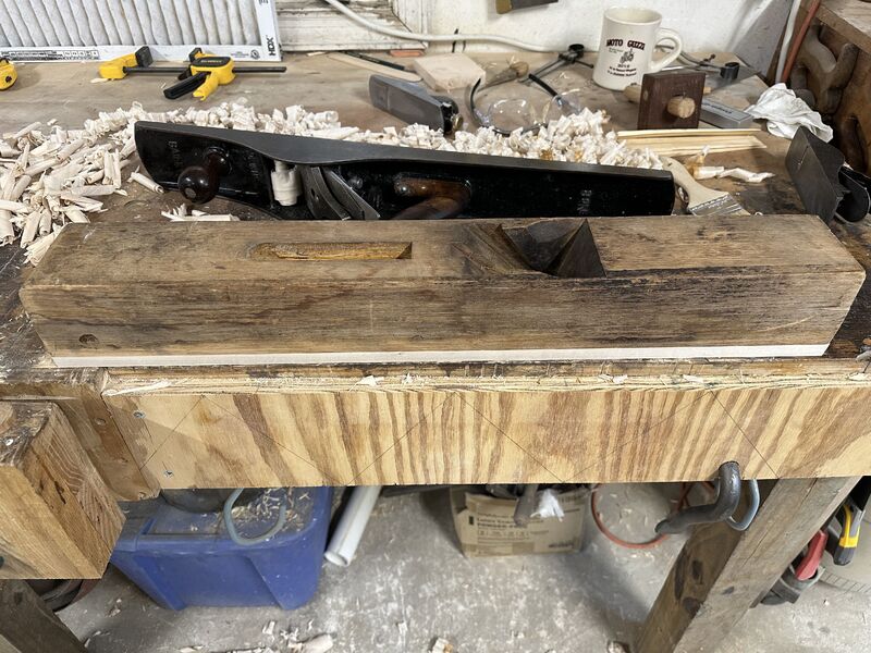

Getting around to re-soling this plane. The replaceable block in front of the mouth was cracked and swollen out, there are also a couple if large cracks running along the sole. Thought I had some before pics of the bottom but guess not.
 I’ve got it planed down flat now. Probably took 1/4 inch off to get it true.
 I’ll cut the center out and insert some hard maple and add another piece of maple along the entire sole to bring it back to the original size. Also need to repair the handle.

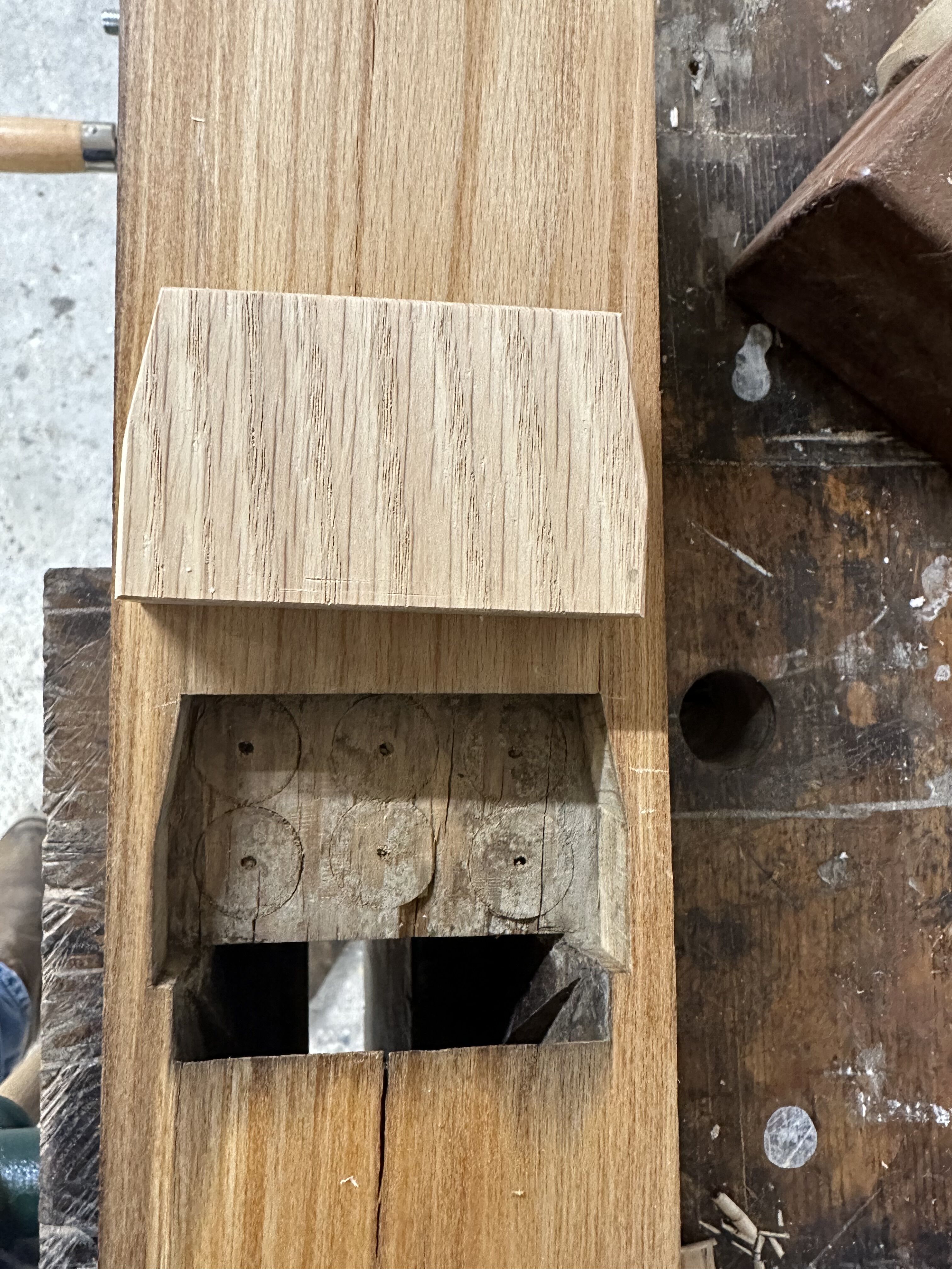

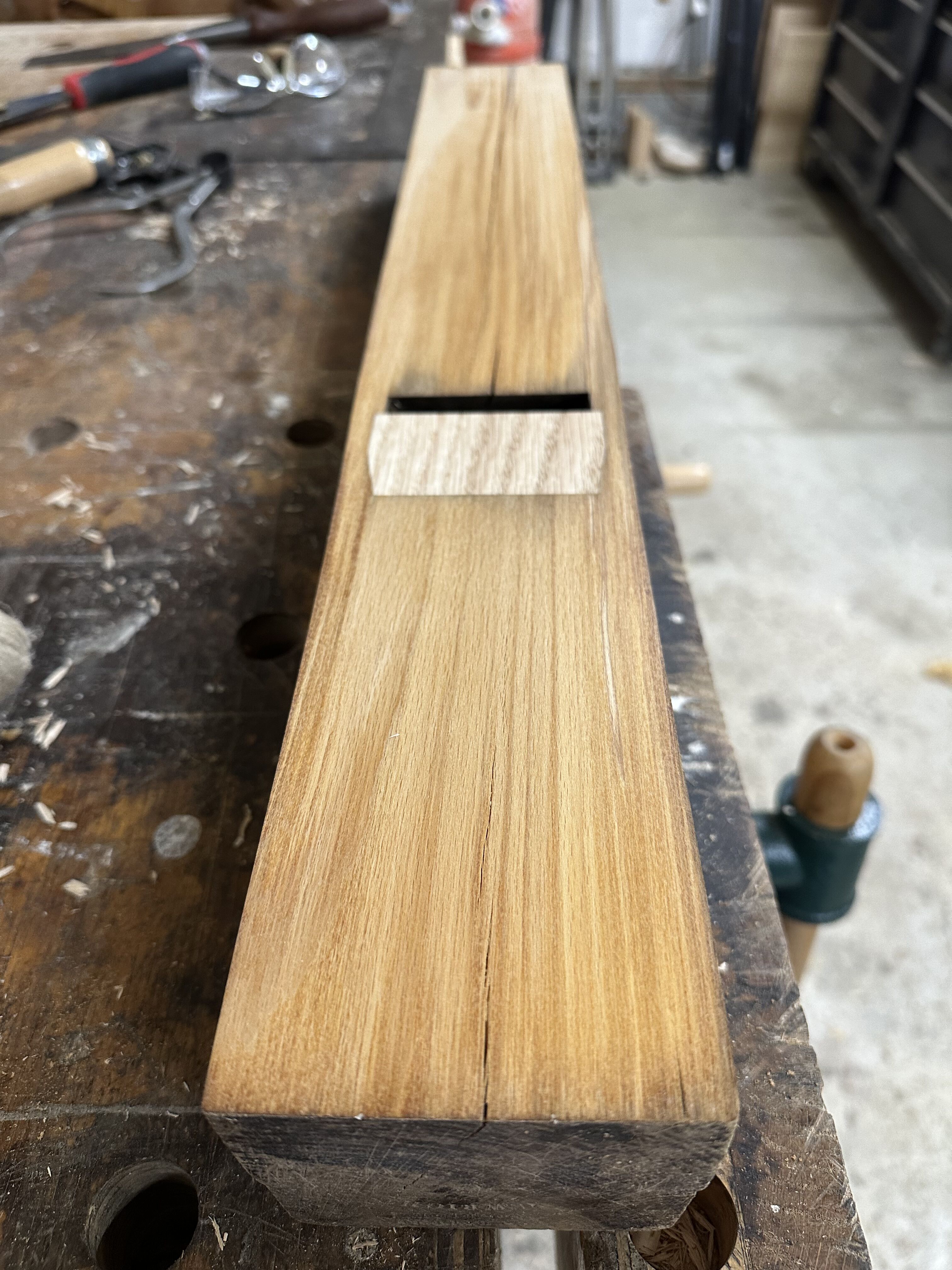

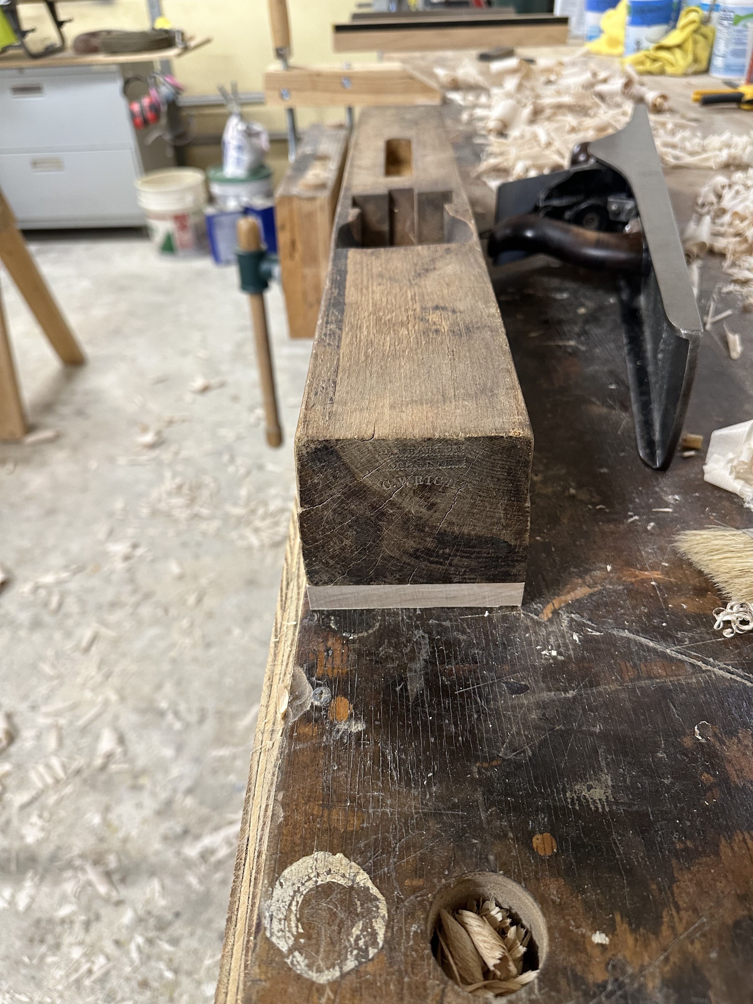

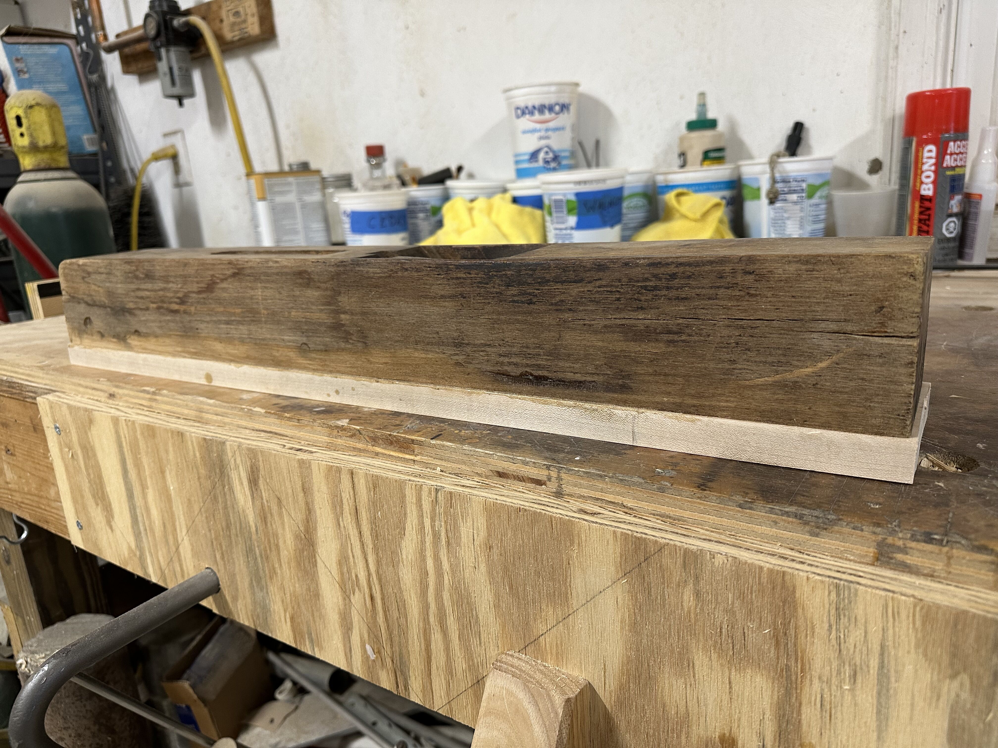

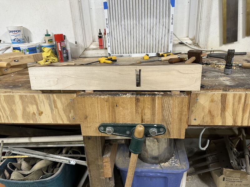

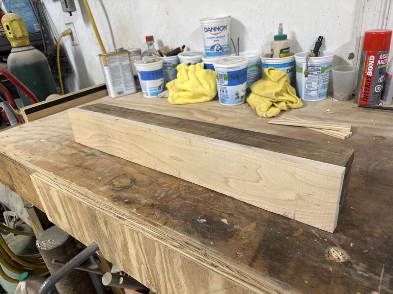

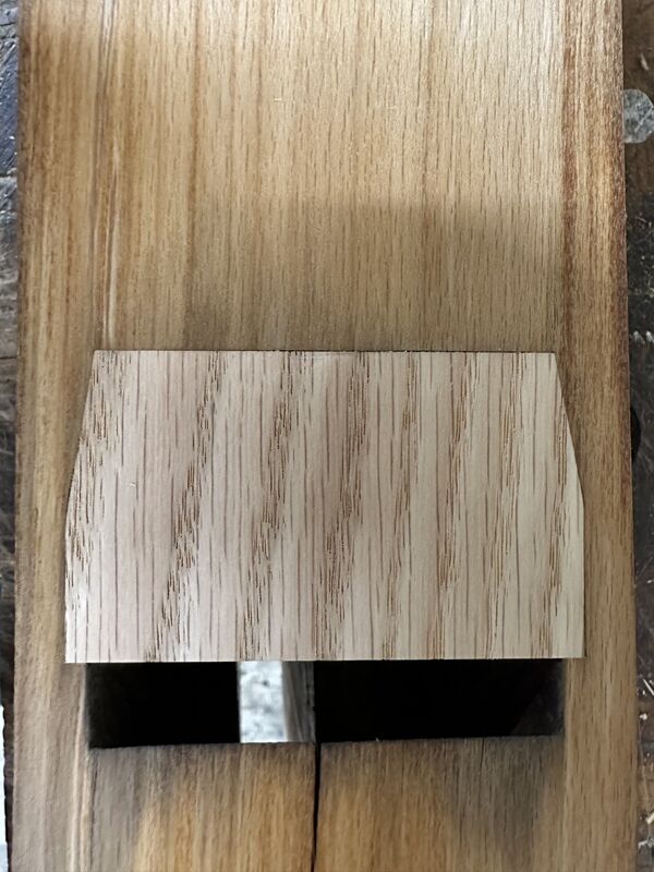

Thanks Dave. I filled the biggest crack with epoxy and I’ve got a piece of hard maple I’m going to resole it with. I’ll plane that down and get it back to the original thickness and recut the mouth. I have a desk I’m making for my daughter and her fiance. I want to use this plane for flattening the top.

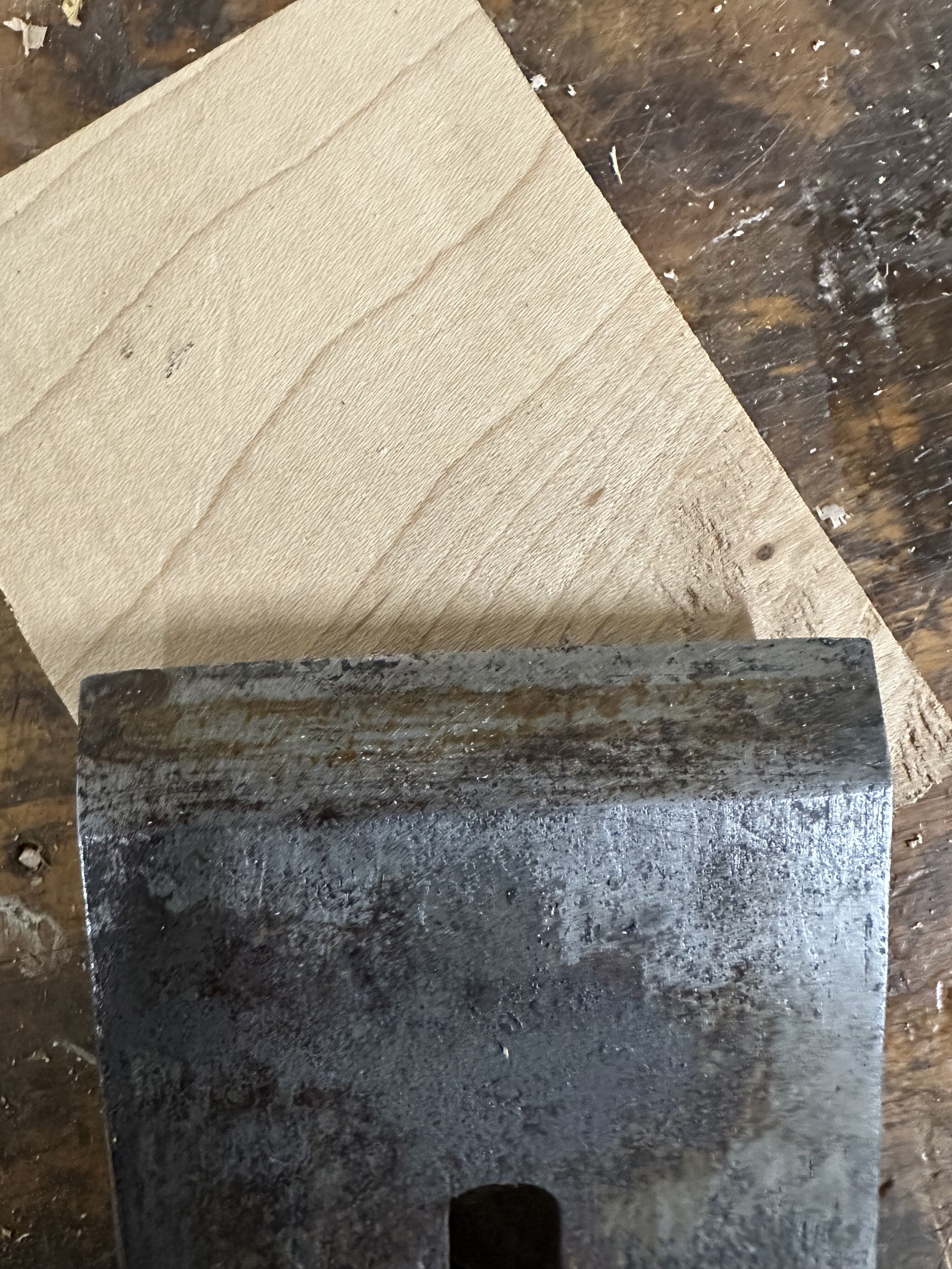

IMG_8441.thumb.jpeg.f141c68591750084cda8ed20900fa42d.jpegIMG_8438.thumb.jpeg.e89675c4579876e9b1ef60237d19e613.jpegIMG_8442.thumb.jpeg.72c525aa468c0394583d6026fcf137f5.jpegIMG_8439.thumb.jpeg.0653315ad3d4602bcf088540624124fe.jpegIMG_8440.thumb.jpeg.d9ba8e4ea22b119168d193a2743cb86a.jpegGot the sole blocked, planed, flat and level. Should be back to what the original overall thickness of the body was at 3 1/2 inches. IMG_8443.thumb.jpeg.ae6e1f0fe5dea185bd72e2059960b01d.jpegIMG_8444.thumb.jpeg.052fe3bae268eb690ebed34eb9608e34.jpegRecut the mouthIMG_8445.thumb.jpeg.5cdf5aa5ef7a176438d3698cccf08983.jpegIMG_8446.thumb.jpeg.3a9bcd96c4db42de4215a30bba9c208f.jpegIMG_8447.thumb.jpeg.2b88b461a8e48b74d4ad481e61718b03.jpegWorking on getting the iron back into shape. Has some fair pitting on the flat side at the edge. I’m not a big fan of the ruler trick for flattening irons, but it’s appropriate for this one. I’ve got some work to do here.
