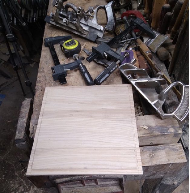

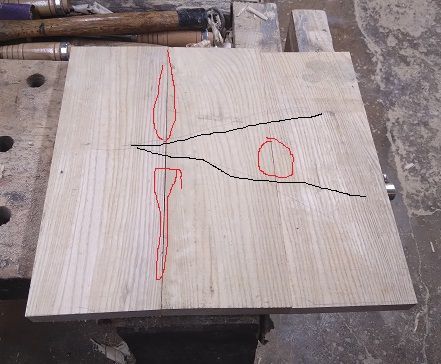

2nd panel?

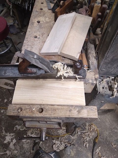

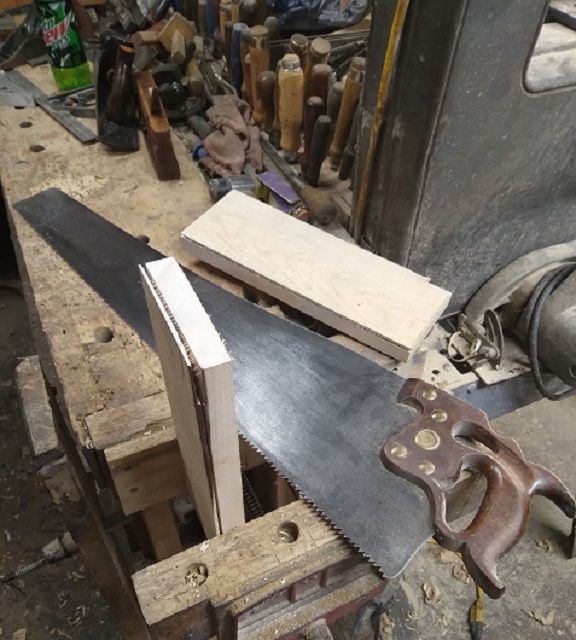

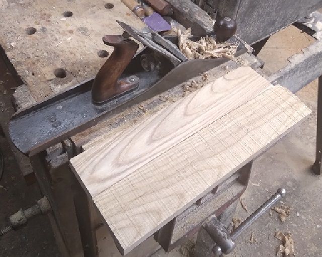

Arranged for best grain match..seems it will need a jointer?
We have ways..

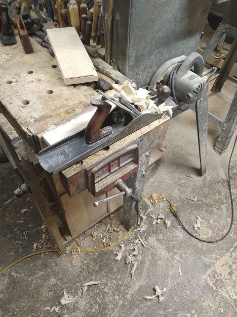

Stanley called the No. 6 a Small Jointer...took a while until..

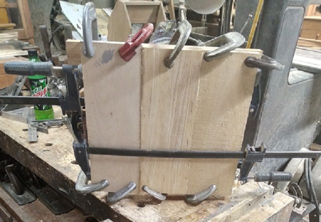

Spread some glue. vise is both a 3rd hand and a caul...letting this sit a day or 2..
Meanwhile, I need to start milling up 2 frames to house these panels..and then see about building a box to hang the doors onto...
Stay tuned....
Both panels are out of the clamps, and trimmed down to 11-1/4" width...:TwoThumbsUp:

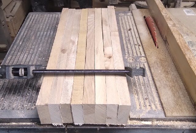

8 Blanks for the frames were milled up.:Cheer:
Cut to just over 14" in length, some a bit longer...width is 2"....Thickness was buzzed down to ~3/4" thick..clamped together to get them all used to their new size.:TwoThumbsUp:

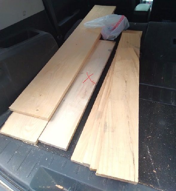

Road Trip, today...Friend that I buy lumber from...also has a Lunch Box Planer...thought I'd take the panels and the rest to his barn..run them through a few times.....
Hmmmm....
Panels wound up badly sniped...but in the areas that did not matter...
Will replace about half of them..as the do not match the others..so..
For $10, and the use of his Mitersaw...the one with the "X" is still a tad too thick...and is NOT Ash...save it for the next Project..the 2 wider planks USED to be one plank, that we had to cut in half..at 5' per....and a re 3/4" x 10s....the others were cut down from 2 planks...a 10'er and an 8'er...

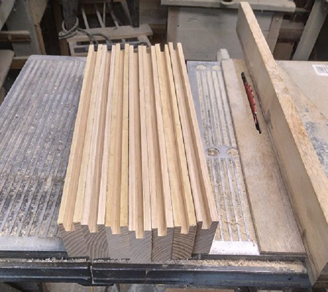

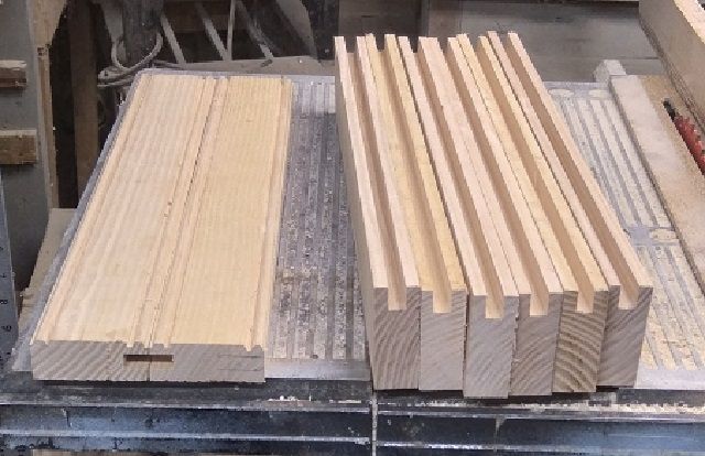

Decided to just make new frame parts...hauled the 2 pieces that USED to be 8' long to the shop...cut 4 blanks at 15" long.....then ripped those down to 2" widths, to get the 8 blanks I needed....:TwoThumbsUp:

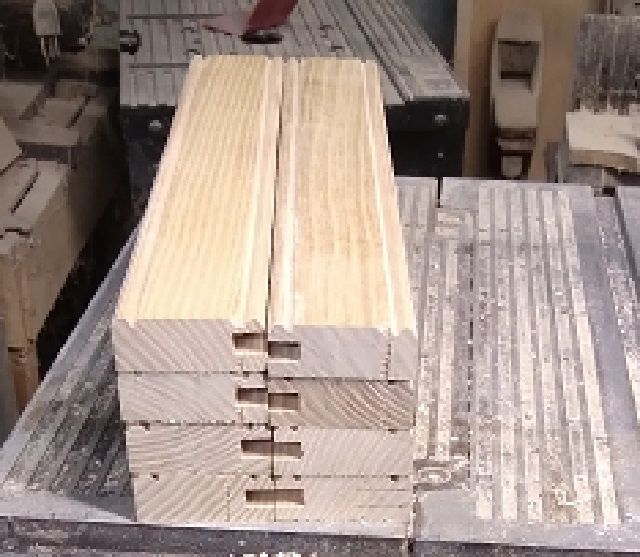

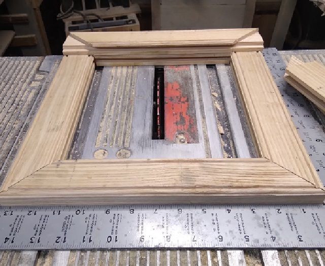

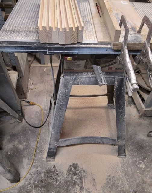

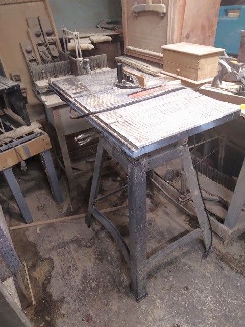

Next. set up to mill a groove on...:SaluteandRun:
one edge..4 passes on the tablesaw.  Made a mess, too..( not the first of the day, either.:rolleyes:.)
Wait a minute, I said 8 parts, right?  So where is #8 at?:WonderScratch:

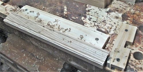

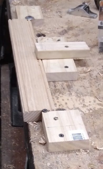

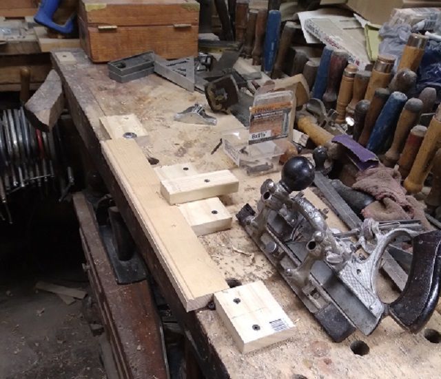

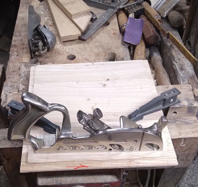

Sitting over on the bench...in a simple jig..and getting a couple beads done..:Cheer:

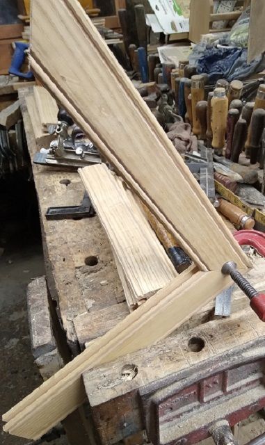

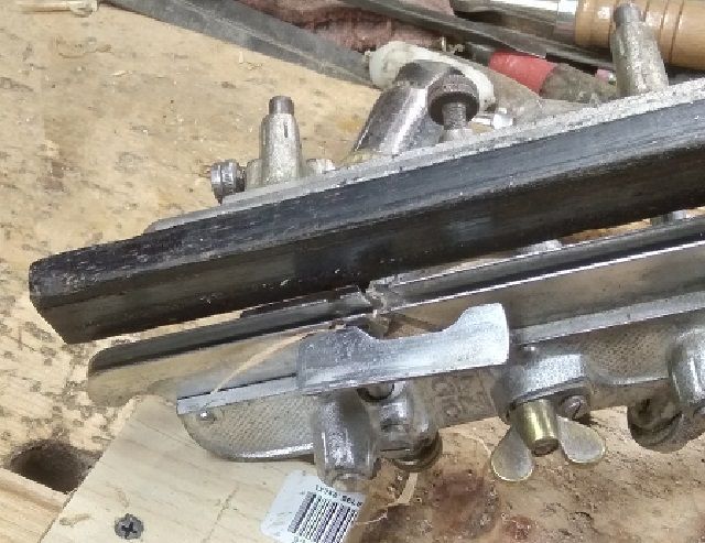

One on each edge......Stanley #45 with a ..
No. 23 cutter...makes a nice mess on the floor, too...:ChinScratch:
Kind of stringy, too..one or two passes, stop, pull the strings out, and back to work...more than 3..it jambs up..:PullingHair:
Managed to get 2 done, before the cramps started up..even with the Fan set on HIGH...:DevilLaughing:
2 done, only 6 more to do...pencil marks?  were to help layout the fence for the grooves..:OldManSmiley:
I did set up #3 in the jig...both..stopped there, for today..:GoodNight:

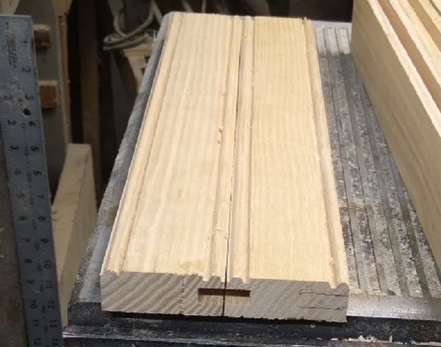

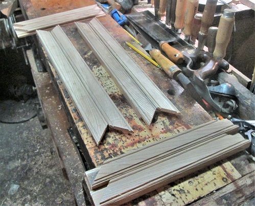

16 beads are now done did...:SaluteandRun:

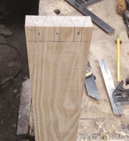

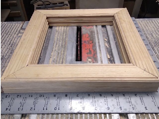

Put the jig away..need to figure out how to connect these in to frames for 2 doors...to where the outside looks like a Miter Joint..:ChinScratch:
But..when you look at the inside of the frame's corner....:JawDrop:
They will look like this...have a couple things to correct...and still have 7 more corners to make...:Cheer:

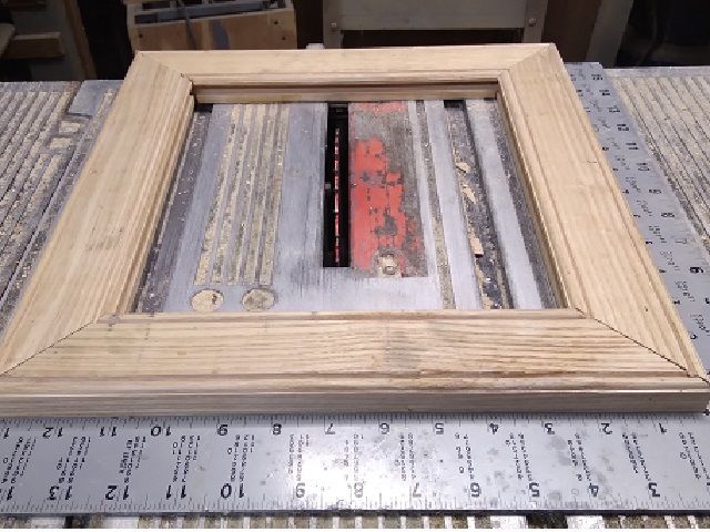

About an hour in the shop, today...one frame dry fitted...:ChinScratch:
Working on frame #2..:Cheer:

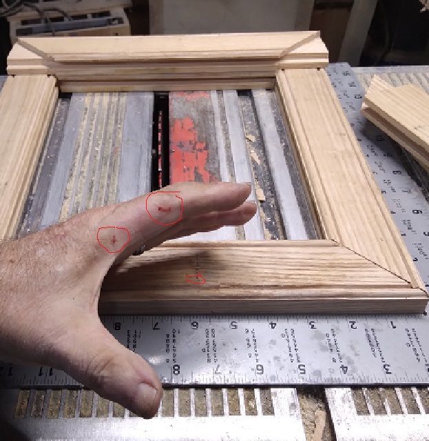

And found out about the fresh DNA...:(
Chisel got me twice, never felt either of them..I guess it is sharp enough..:JawDrop:
And...finally...soaked clear through (even with the fan set on HIGH!) kind of sore...:BangingHead:

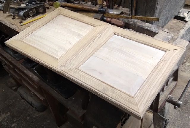

Both frames have now been dry fitted up..been measured for the raised Panels...10" x 10-1/2"....need to work on trimming and raising 2 panels...tomorrow..:GoodNight:

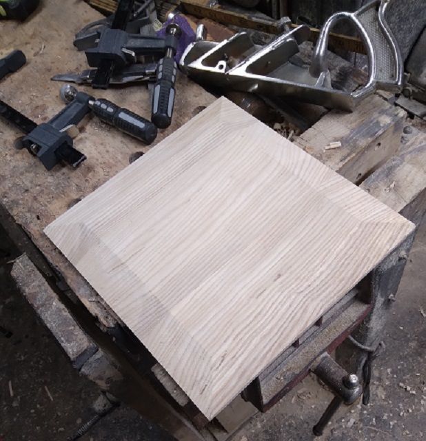

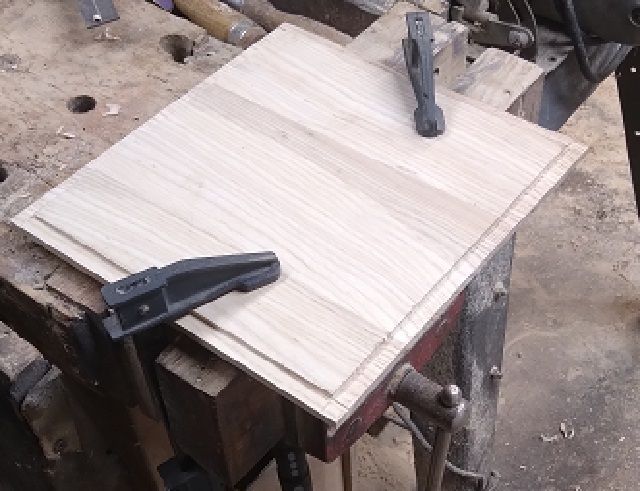

None the less, both panels were trimmed to size, the "good face was given 4 bevels..
And a rebate was run on the inside...

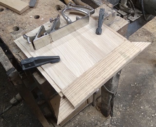

Will need that Sargent No. 79..as the rebates were to fat...dry fitted one panel...
Needs the burn marks sanded off..

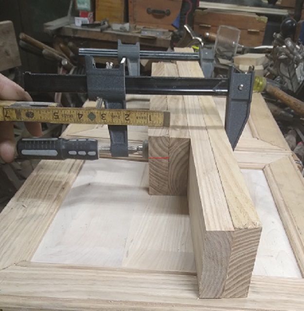

Work holding set up..:TwoThumbsUp:
As all those Rebates are not deep enough....rather FAT ...so..:SaluteandRun:
Yes...that plane will work just like that..depending on the grain directions
Test fit?  3 or 4 times, until..:ChinScratch:

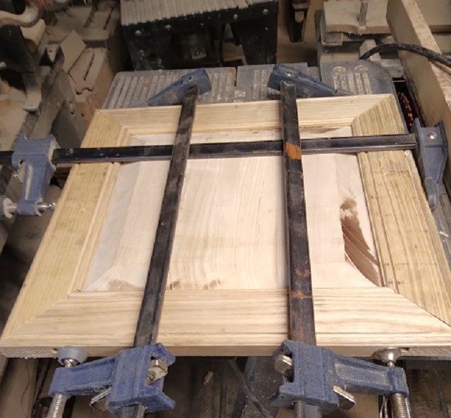

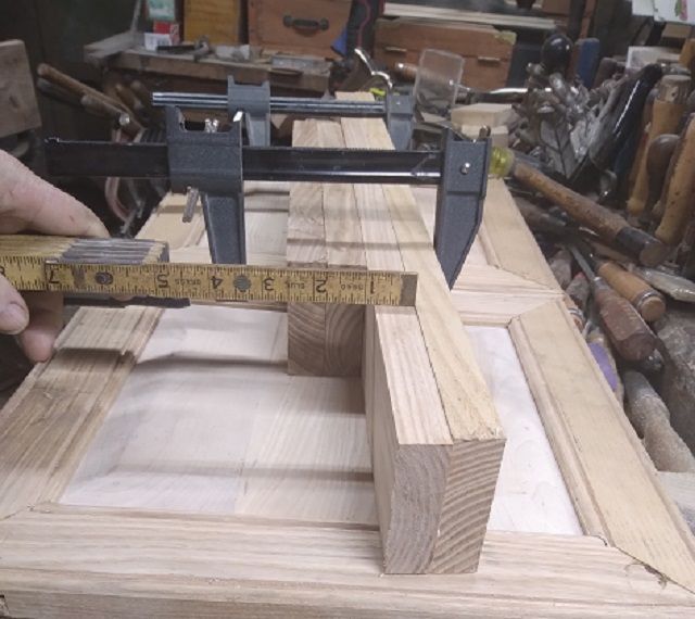

Fits all the way into the groove...had all 4 rebates to do...and plenty of dry fits...until..:Cheer:

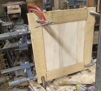

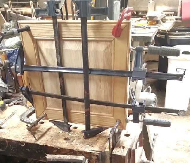

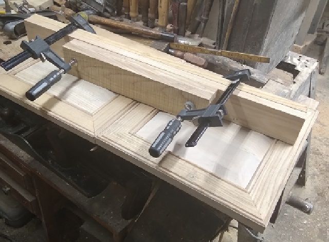

Glue & Clamps showed up...this is a view of the Inside of the Door...:TwoThumbsUp:
And..this is the outside of the door...due to the clamps, this is sitting on it's side...will "rotate" 90 degrees once the clamps come off...
Yard mowed, hedge trimmers run, Laundry Detail...and this...I think I be working way too hard...for a Friday..?:ChinScratch:

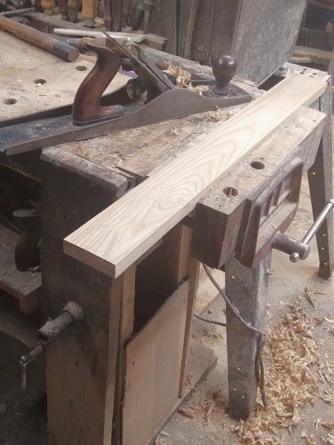

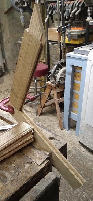

Needed 4 boards..:Tapping:
2 longs and 2 shorts...to build the cabinet's "Box"...long ones were from one board..but I needed a second board for the short ones..:SaluteandRun:
While the 2 long ones were close to the correct thickness..:TwoThumbsUp:
The 2 shorties were not..:BangingHead:

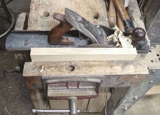

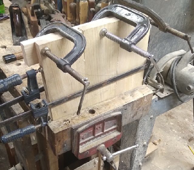

Edges were in need of a good jointing, too..:ChinScratch:
We have ways..:ph34r:.Boards were clamped up and sat for a while...hoping to pull one curved board into flat...but, since I already had 1/4" extra to work with...:TwoThumbsUp:
A "Before & After"   :OldManSmiley:

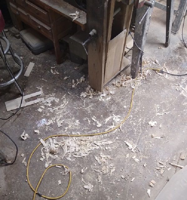

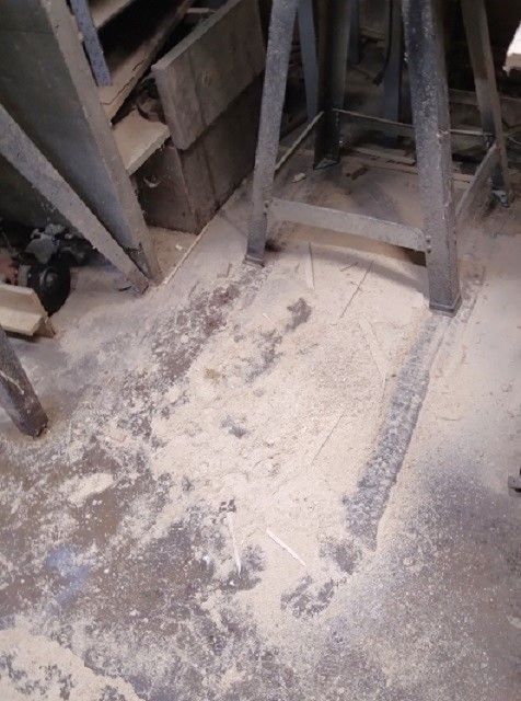

Edges were also jointed..all of them..:ChinScratch:

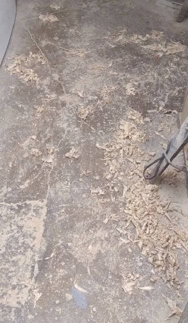

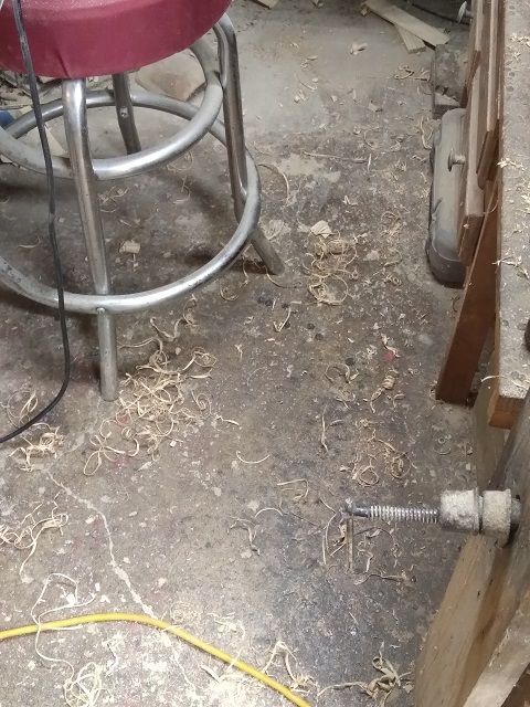

Notice the floor?  Yep, was that kind of a day...for about 1 hour...:KooKooClock:

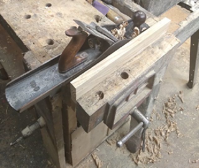

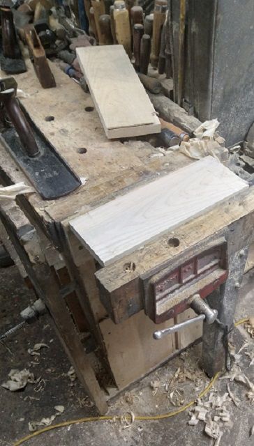

Even the 2 long boards were worked on..:TwoThumbsUp:
Plane was made during WW2, BTW..a Stanley No. 6c...:SaluteandRun:
was able to get all 4 boards done, without too much of a mess..:rolleyes:

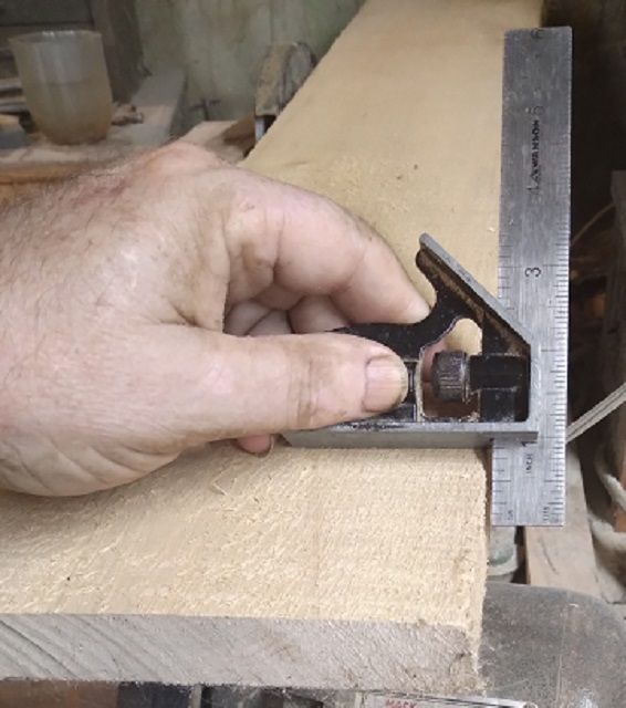

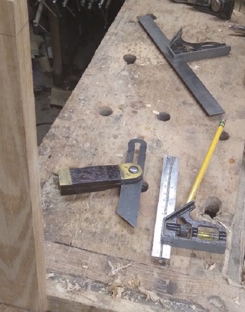

Got a few toys out..:SaluteandRun:
And started a wee bit of layout work..:TwoThumbsUp:
To be ready for the next time in the shop...:ChinScratch:
