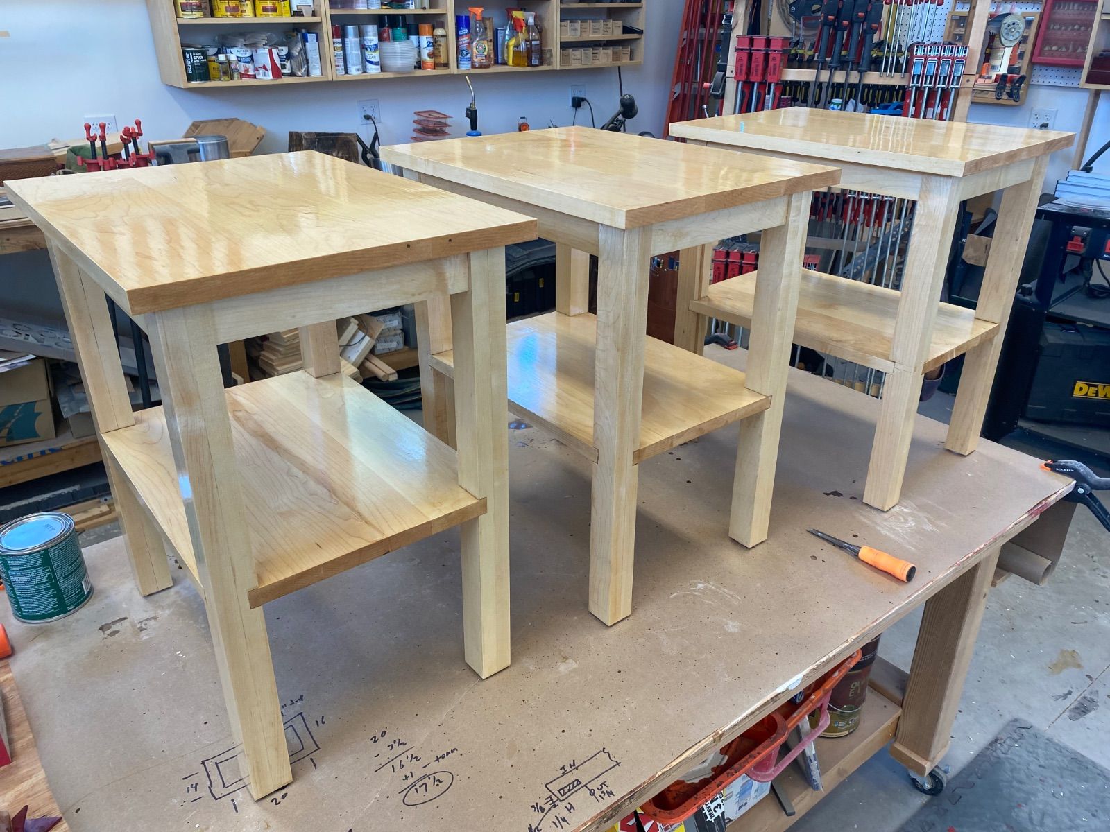

all done, 3rd coat on the tops looks good.
there are a few imperfections on the underside.....well, it's hand made, what did you expect?  unless you drink all the wine, out of all 3 bottles, you won't be on the floor to see them, so let's move on.
stick on felt feet applied, will deliver wednesday.

On 5/27/2024 at 5:49 PM, Gerald said:
120? How did you get away with stopping at 120? You are making me tired for the day.
ah yes....we all "know" you have to sand to at least 220, maybe 320.  do you?
the finish on these was Spar Urethane, 2 coats everywhere, 3 coats on top (as they take lots of wear), with light hand sanding of the prior coat at 220 between coats, gives the next coat something to grab onto and knocks down any fuzzies.
well, as the pics show, the tops came out very nicely.  with 3 coats of poly, you actually build up layers on the surface that hide any sanding imperfections that may exist after sanding with 120, so there is no point in sanding any finer, the coats of poly will hide those "defects".
don't believe me?
grab some scrap lumber, sand one to 80 (that's where i started, got rid of planer marks and such), sand one to 120 (where i stopped), and one to 220.
now grab your jar of poly and apply finish coats as you normally would, and as i described above.  2 coats should look nice, 3 really nice.
if you are using some other finish that does not sit on top of the wood, then yes, you might want to do a little more sanding, as the finish will not fill in the defects/voids you might still have.
hope this helps.  no point in doing more work than you have to.
