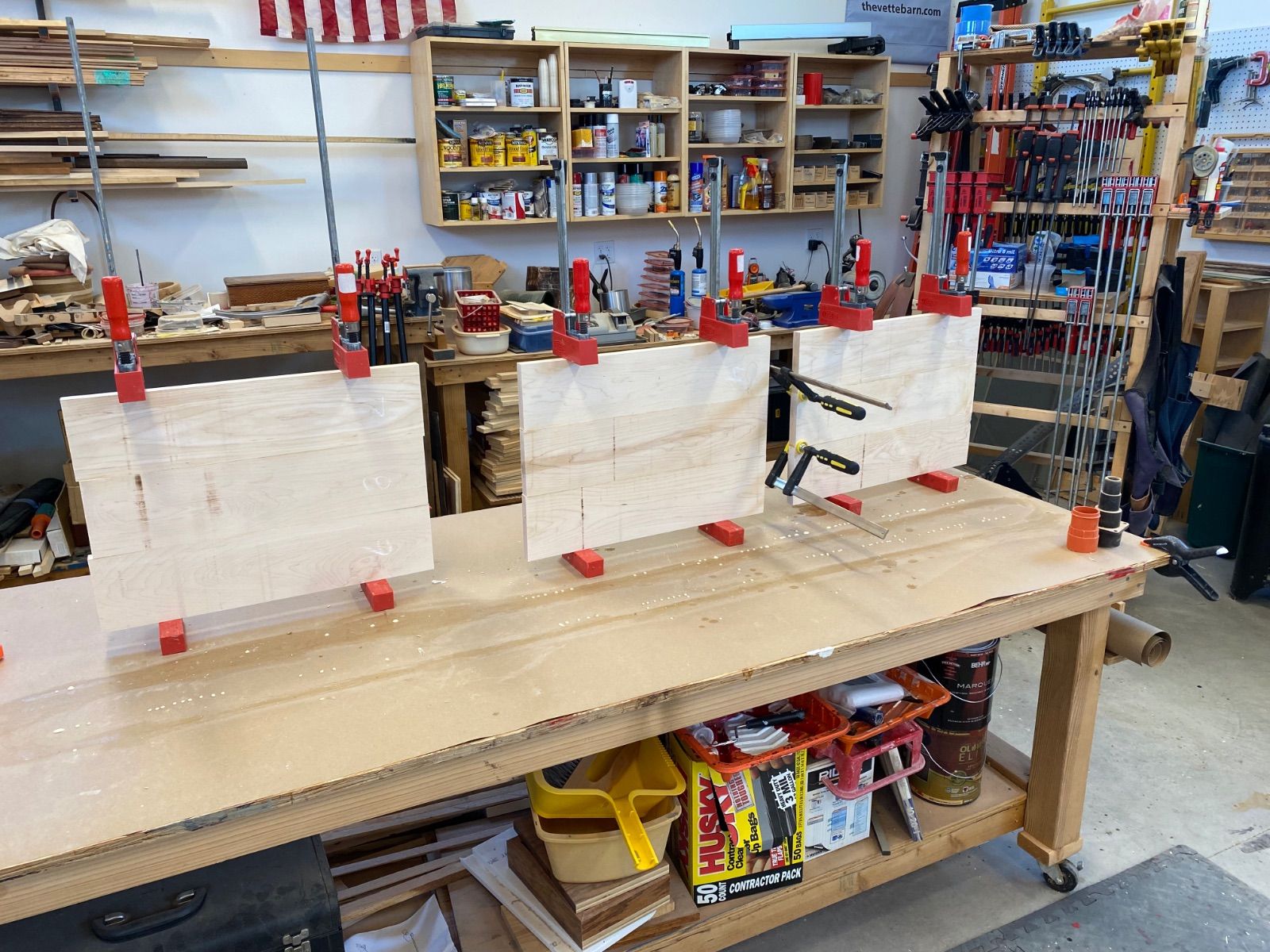

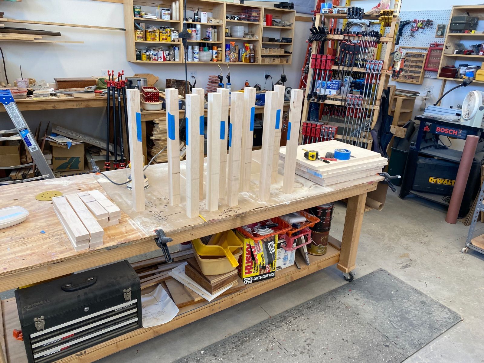

May 24, 20242 yr Popular Post comment_336083 I had previously posted in some other threads about making some communion tables for my church, including showing the prototype. see below. after those in charge had a chance to study it, try it out, and see how it fit into the overall scheme of things, I got the go ahead to make 3 more just like it, so work began this week. first, glue up some blanks for the tops. then glue up some blanks for the lower shelves. and today, glue up some blanks for the legs (12 total) i'm busy this weekend, so more will be done next week between other thing i got to do. 24" high, 16x22 top, 1" overhand all around, 1-3/4" square legs, 2" deep skirts, bottom of lower shelf is 10" above the floor. all solid maple, 2-3 coats of spar urethane. 29 clamps for the legs seemed like the right amount. still have LOTS of sanding to do, as well as trim the legs to size (over sized the glue up at 1-7/8" square). i'll update this as i have more to show. Report

May 27, 20242 yr Author Popular Post comment_336229 Hours of sanding, jointing, planing, cutting, little cussing, we have 3 tops, 3 lower shelves, 12 legs, and 12 skirt pieces ready to go. but i'm tired, so i'm calling it a day. tomorrow will cut the mortises, then cut the tenons, then cut the dados (for the lower shelf to fit into), and then start gluing things up. i think i'm shy on enough clamps to do all 3 at the same time, so i'll do 2, let them cure 2 hours, and do the last one. after that, time to recess the figure 8 connectors on top of the skirts and attach the tops. then finishing. probably thursday will start. coat 2 on friday, if needed coat 3 (top only is expected) sometime saturday. let them cure real nice a few days, deliver next week. for those counting parts, the 12th leg is over by the mortising machine. Report

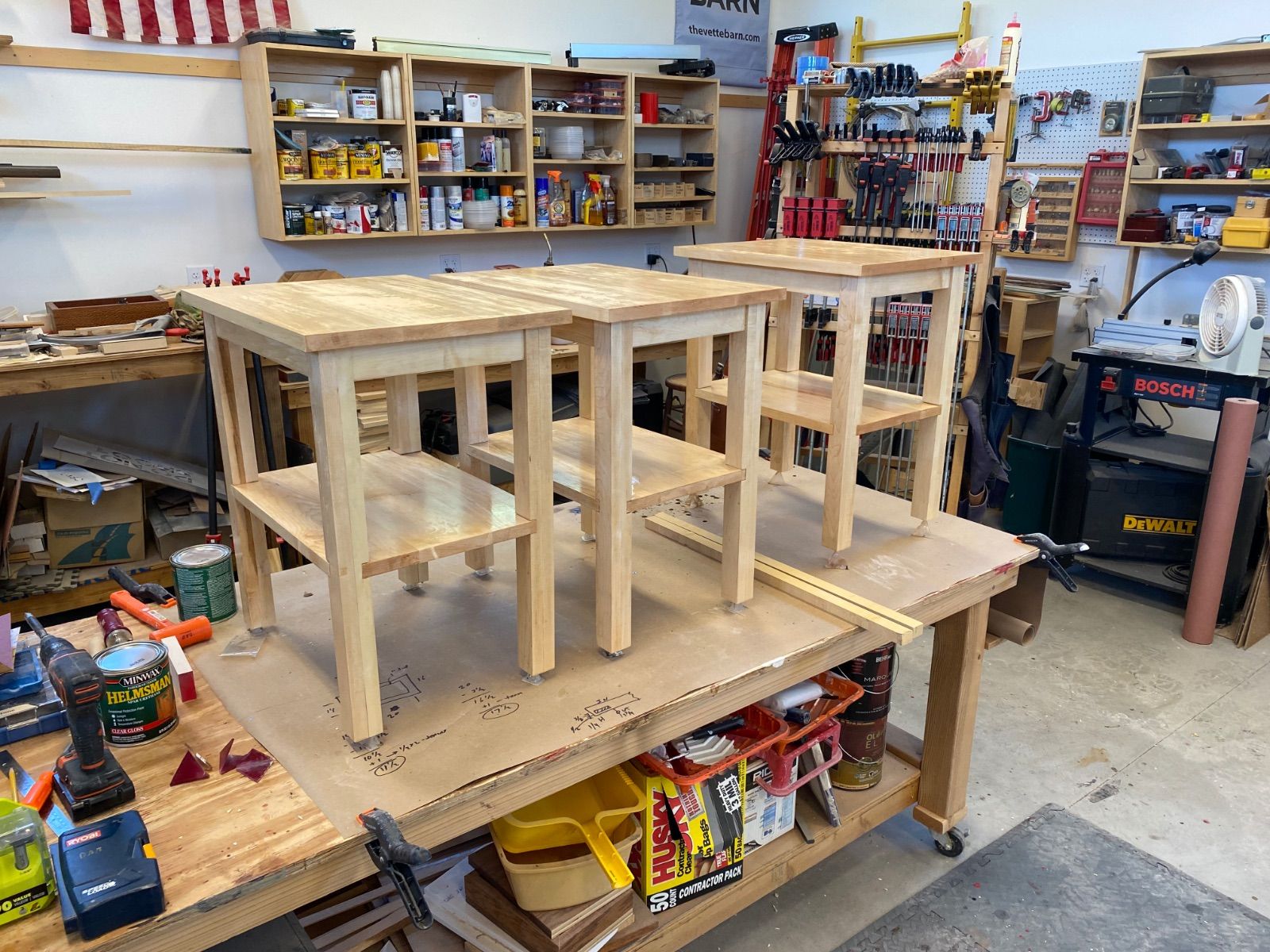

May 28, 20242 yr Author comment_336277 more work this morning, got one gluing up, have lunch, check on it around 1pm, then glue up the second of 3. made one boo-boo, got it patched, cut a dado on the wrong side of a leg. and have no spare legs....sigh.....patch matches pretty well, might show it later. Report

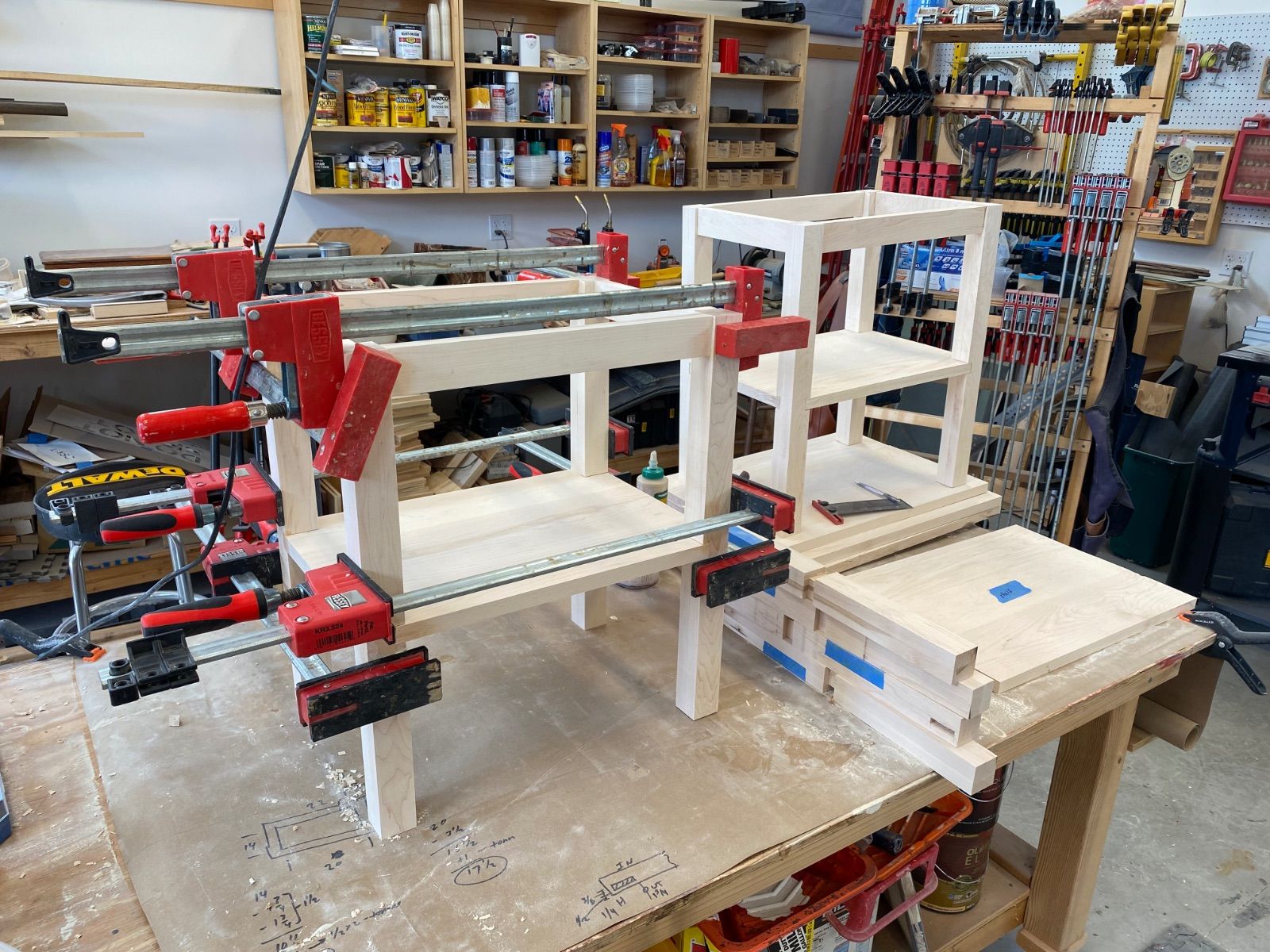

May 28, 20242 yr Author Popular Post comment_336281 tab A, slot B.....wash, rinse, repeat... one glue up done, another in clamps, the last awaits until later, give it about 2 hours to cure up. Report
May 30, 20242 yr Author Popular Post comment_336360 first coat of poly on this morning, another tomorrow. Report
May 31, 20242 yr comment_336406 Those came out great DAB ! How did you mortise in the lower shelf ? Paul Report

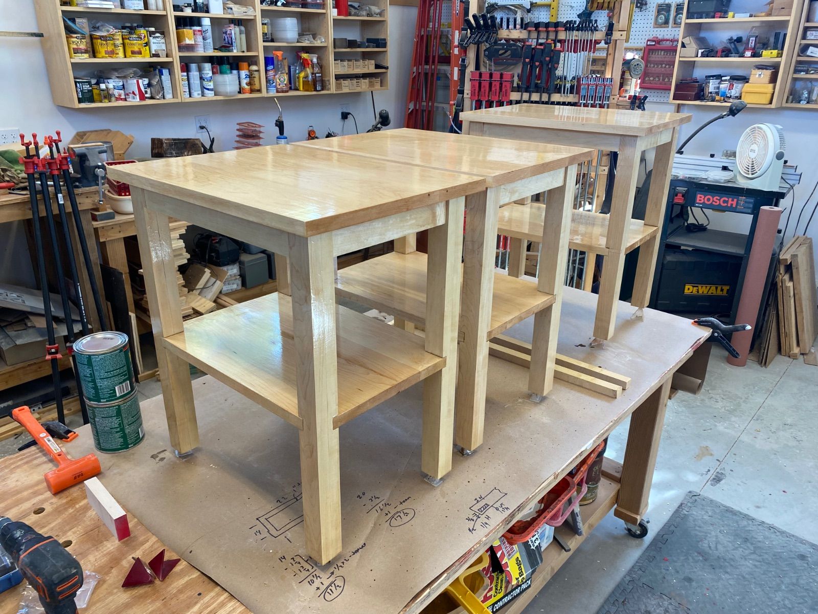

May 31, 20242 yr Author Popular Post comment_336413 coat #2 on this morning, likely a 3rd coat on the top only tomorrow, as it takes all the wear. the lower shelves are cut away at the corners and then let into matching dados on the legs. Report
June 1, 20242 yr Author comment_336497 third coat of poly onto the tops only, looking good. will let dry a few days, deliver wed am. Report
