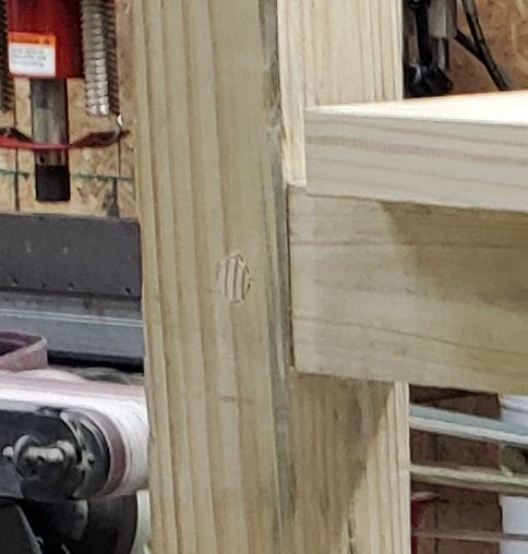

March 9, 20242 yr Author Popular Post comment_331344 I attached the horizontal 4x4 with a pin. JT Report
