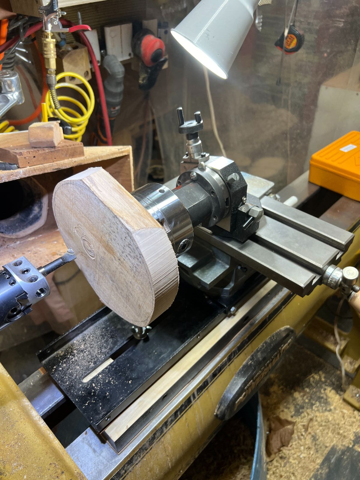

Got all the parts put together and tried the bits that came with the boring head got a lot of vibration. Remounted the Rotating Deck as I had in mounted on a aluminum plate to get it straight to the vise ways ( this due to the mounting holes in deck not matching holes in vise) .
Second concern the bits in boring head will not work as the wrong grind. I ordered some HSS rod 12mm to make bits.
And last I noticed in the video the Cross Side is much smaller than the one I have which just means some manipulation , but that will happen on each piece anyway.
The bit in the video was strait on.  I noticed he had a little play in his set up.  I would devise a method to take up any slack before each cut.  Bungee cord?

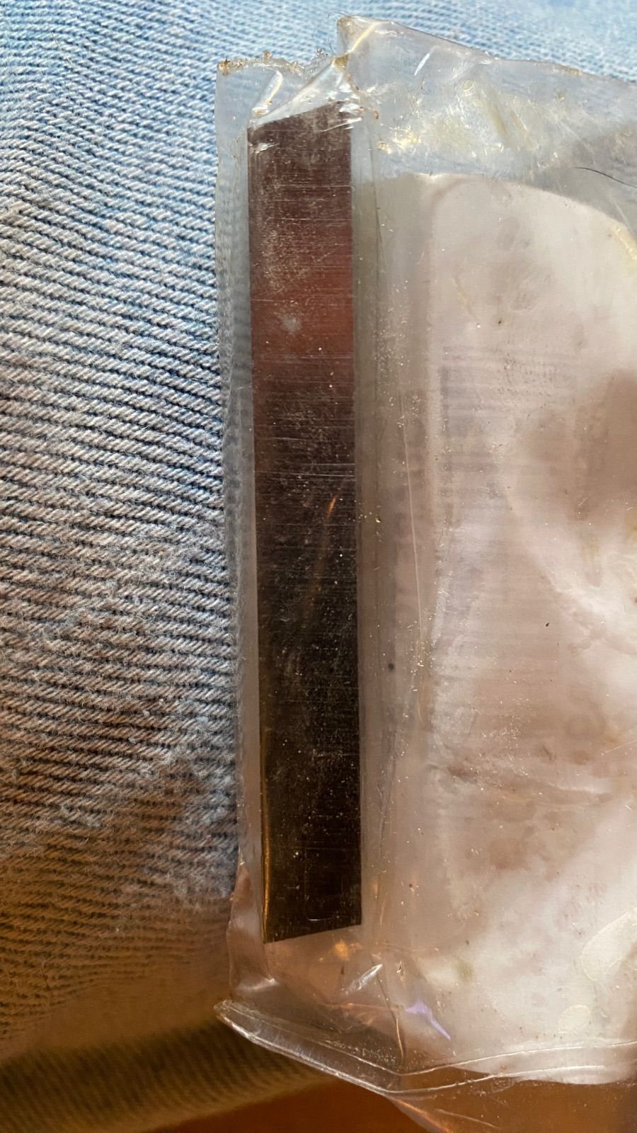

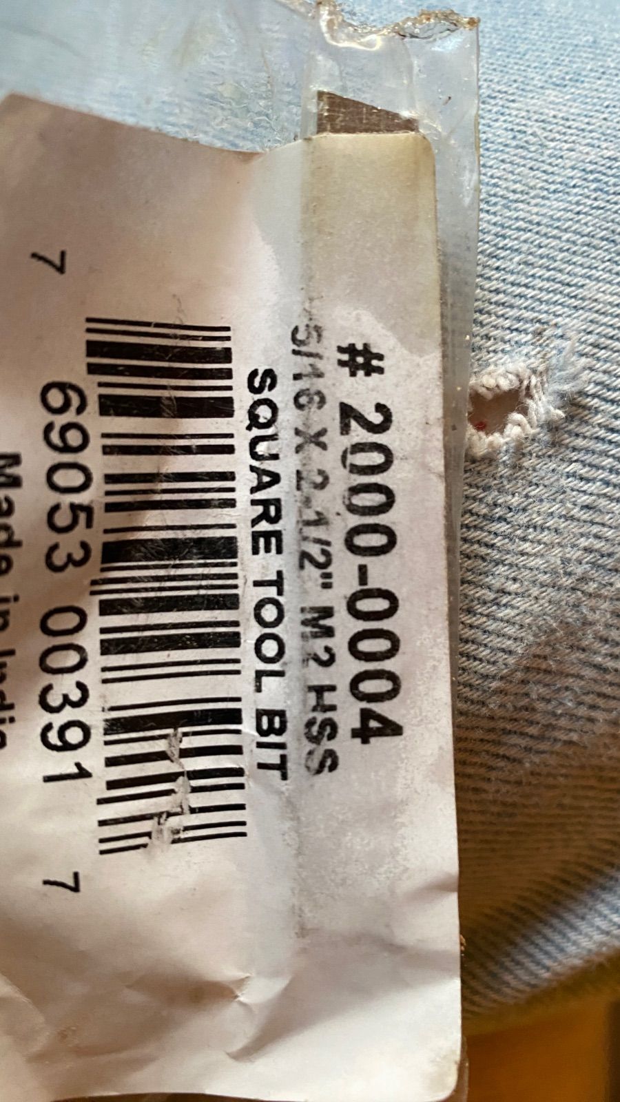

I got a bunch of these by mistake. If you can use a couple let me know
Old straight router bits will work if reshaped.
Thanks Lew I have some square HSS bits.  Dan the thing about router bits is the head is 12mm and 1/2 in shaft will not fit in it. I thought I saw a round bit with a flat and then pointed end in video. Of coarse the end can be any shape you want but the cut will reflect the shape somewhat . Just cannot see this leaving a ogee or other shapes even if the round bit was shaped that way.
Have not tried again since I took the Al plate off but I think that was the vibration problem.
