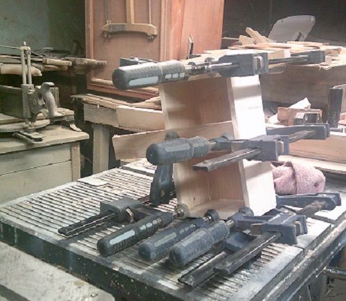

February 18, 20242 yr Author comment_330138 A glue up happened..First I needed a bracket made.. Might be a bit rough to install this afterwards.. Goal being to keep the long sides from bowing in when the clamps are done..let this sit overnight.. Then, today, these clamps came off, all 4 sides and the top and bottom of the box were planed and sanded clean, and square.. Next, a 1/4" plywood panel was cut to size, glue was spread around...making sure it was the bottom edge of the box.. There is a caul across the middle, because .. There was glue on the bottom of the bracket as well...will let this sit a while...then maybe work on a lid? Will add strips around on the underside of the lid...more wood for the hinges and latch to grab onto.. And maybe add these,, Might see about a label? Stay tuned... Report

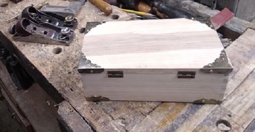

February 20, 20242 yr Author Popular Post comment_330299 Lid has been fitted to the box...and hardware installed.. Need to go and buy a few brushes,,, Hinges? Top of the box? Open the lid?Fancy Tools need a Fancy Case, right? Question now is....Brand the Logo on the inside of the lid, or on top of the lid? Hmmmmm? Still learning HOW to use this phone camera....hardest part was keeping me fingers out of the way.. Work area? There IS a "ZOOOOM" button, somewhere? Stay tuned..might get a finish on this box later.. Report

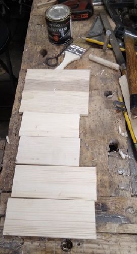

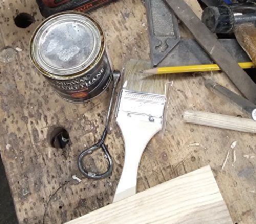

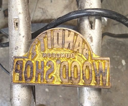

February 22, 20242 yr Author Popular Post comment_330391 Hmmm, coat of stain dried a bit lighter than what I wanted... Maybe add a bit more? Line down the front face is a knot... Twins? Added some foam to the bottom...as for under the lid.. Branded.. Not sure I would call this a Branding "Iron" when it is solid Brass.. I guess THIS is the Branding Iron...takes 20 minutes to get to the right temp. And, about that long to cool down. This might be the next step...will see how it turns out... Doubt IF I will add a chain to the lid... Next! Once the varnish has dried... Stay tuned.. Report
February 23, 20242 yr Author comment_330527 Varnish is on.. Still learning how to use this Phone Camera..end view? And have a start on Box #2... One corner done...might take awhile.. Report
