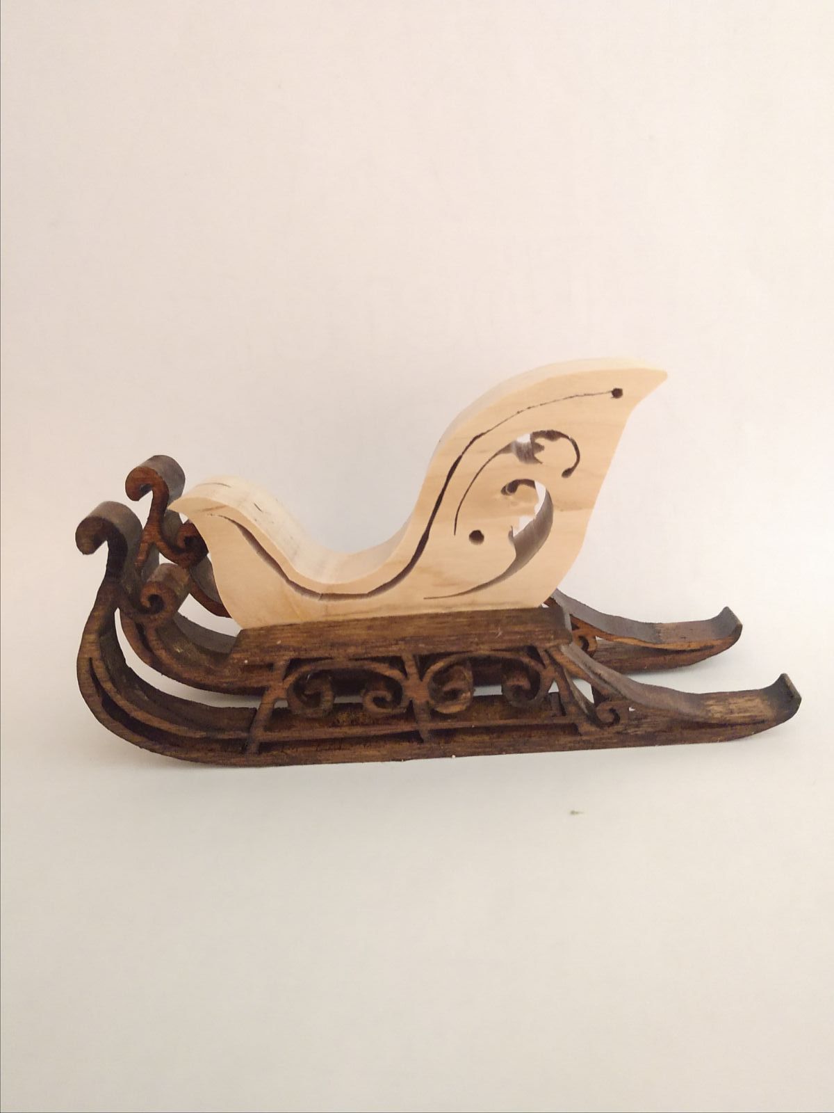

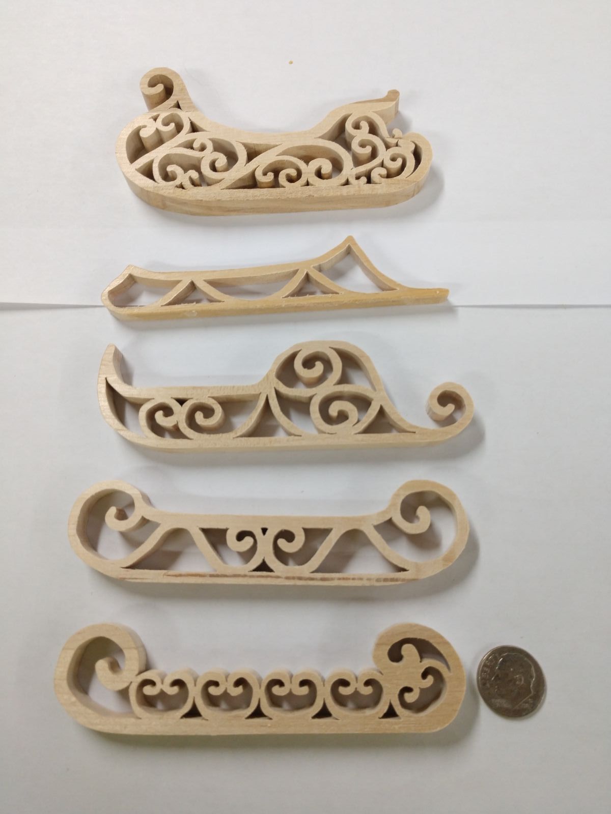

October 29, 20233 yr Popular Post comment_323248 Sleigh bodies are 3/4" maple. Runners I cut down to 1/4" thick & nailed (2) pieces together to save some cut time. I'll cut the runners first then stain them, that will give them time to dry while I cut out the bodies. Ten different sleighs patterns & a total of 18 to cut. The wide board measures 6"x19" and has 12 sleigh bodies. Report

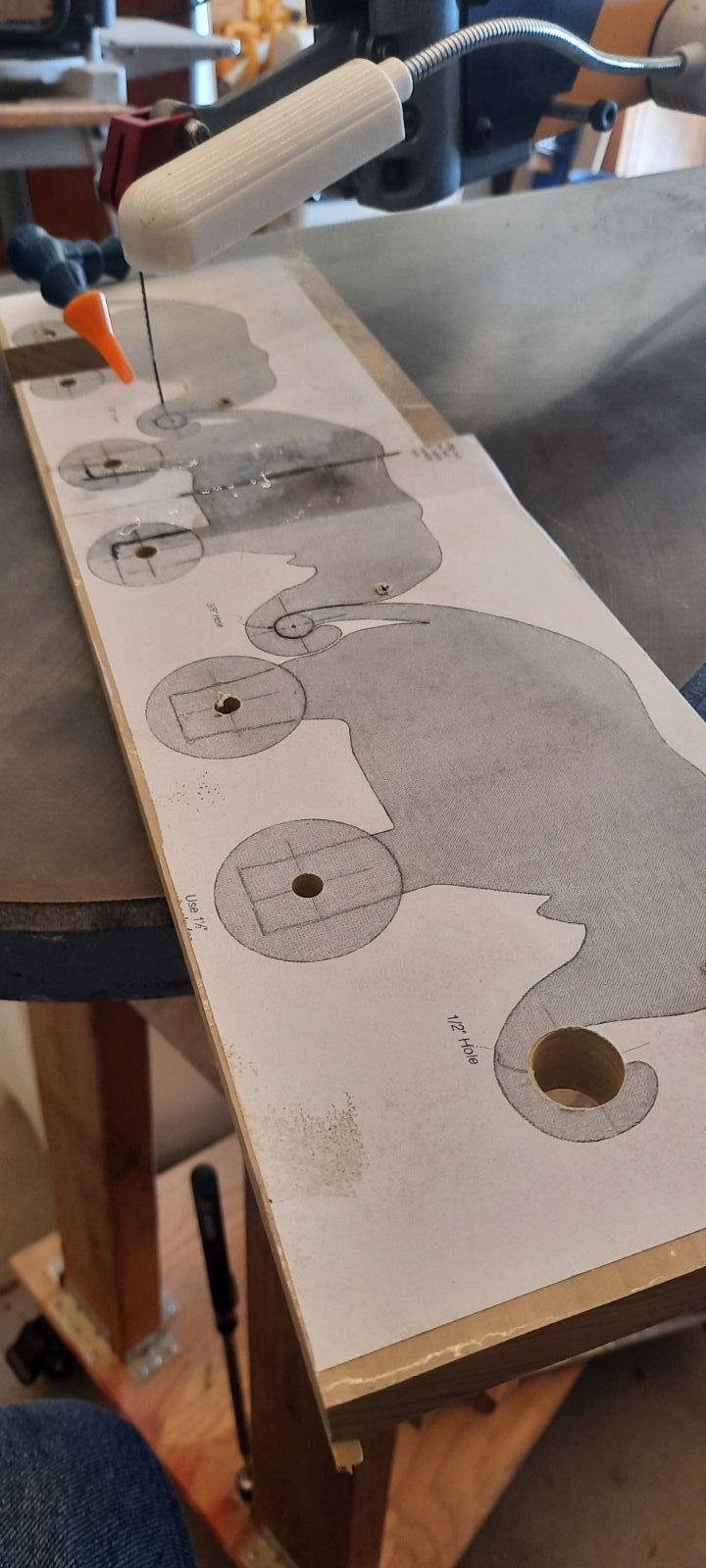

October 29, 20233 yr Popular Post comment_323251 Fun, fun, fun! One hole at a time. The completed ones look fabulous. Here's what I'm cutting. Not nearly as intricate as yours. Edited October 29, 20233 yr by Gene Howe Report
October 30, 20233 yr Author Popular Post comment_323281 11 hours ago, Grandpadave52 said: Awesome. Lots of patience from both of you. For me the patience comes marking the locations of the drill holes with an awl. Nothing worse than drilling a hole in an area that wasn't scrap. Report
October 30, 20233 yr Popular Post comment_323285 Got tired and frustrated with the changing holes process. Two things have somewhat alleviated that frustration First was the addition of "The Lifter" from PAPAS WORKSHOP. The second was using a hand held counter sink on the holes on the back. Makes it easier to thread the blade if you're a bottom feeder, like me. Edited October 30, 20233 yr by Gene Howe Report
October 30, 20233 yr Author Popular Post comment_323292 2 hours ago, Gene Howe said: The second was using a hand held counter sink on the holes on the back. Makes it easier to thread the blade if you're a bottom feeder, like me. I use a steel punch, stubby point, works like the counter sink. I use an older Delta with parallel arms so I don't have the option of lifting the arm, release the top clamp and the blade tilts forward. Bigger pieces can be a bit challenging when bottom feeding in the middle of the piece but I just put a little bow in the blade and thread it through. Report

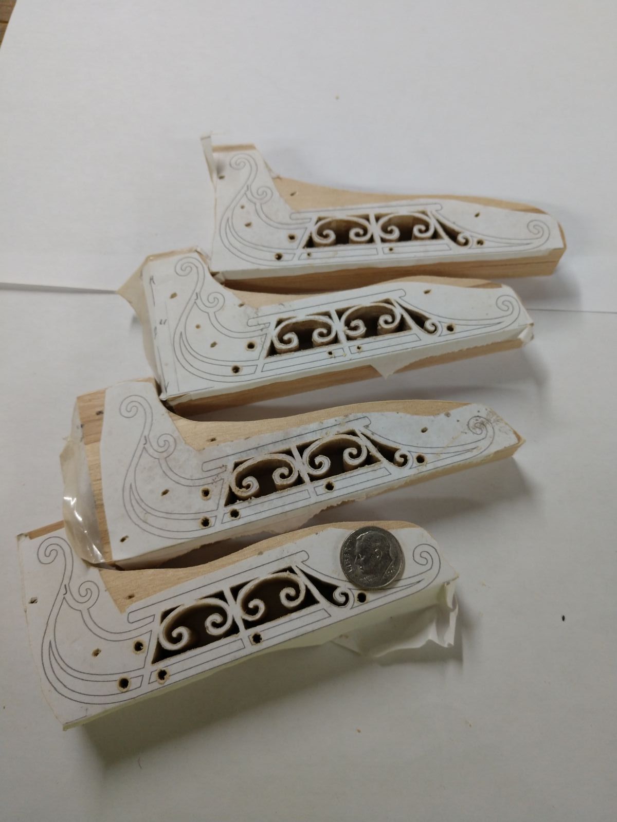

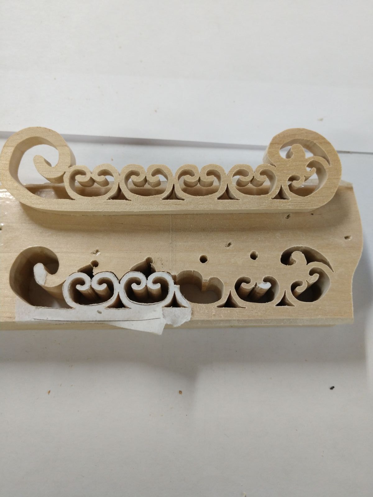

November 2, 20233 yr Author Popular Post comment_323474 I have 7 pairs of runners cut & 4 started. One pair is a redo, this is when the patience kicks in. Report
November 3, 20233 yr comment_323491 Holy cow Bob, neat! Is there a reason to not work on one pair at a time? Report
November 3, 20233 yr Author comment_323505 1 hour ago, Cal said: Is there a reason to not work on one pair at a time? I tried cutting 2 pair (1" thick) but the maple was pretty hard on the blades. I was trying to speed up the outside cuts and caught my blade on the spiral, that's how I broke that pair. Between applying the pattern, drilling & cutting that's 45 minutes lost. Report
November 4, 20233 yr comment_323553 Hey Bob, at first I didn't understand your answer... then I realized that you didn't understand my question My bad @DuckSoup What I was trying to ask is that from the one pic you are cutting out four different runners (or maybe four sets of runners). Cut some from this one, cut some from the next one... is there a reason not to complete one before moving to the second one? Edited November 4, 20233 yr by Cal Report
November 4, 20233 yr Author comment_323563 2 hours ago, Cal said: Hey Bob, at first I didn't understand your answer... then I realized that you didn't understand my question Sorry @Cal, I wasn't listening to where you were looking. The simple answer is blade change. I had a 3/0 blade in the saw and was using it for the small tight areas, I just decided to do them all and then move up in blade size. I'm using a #2 & #3 blade for the larger areas. Report

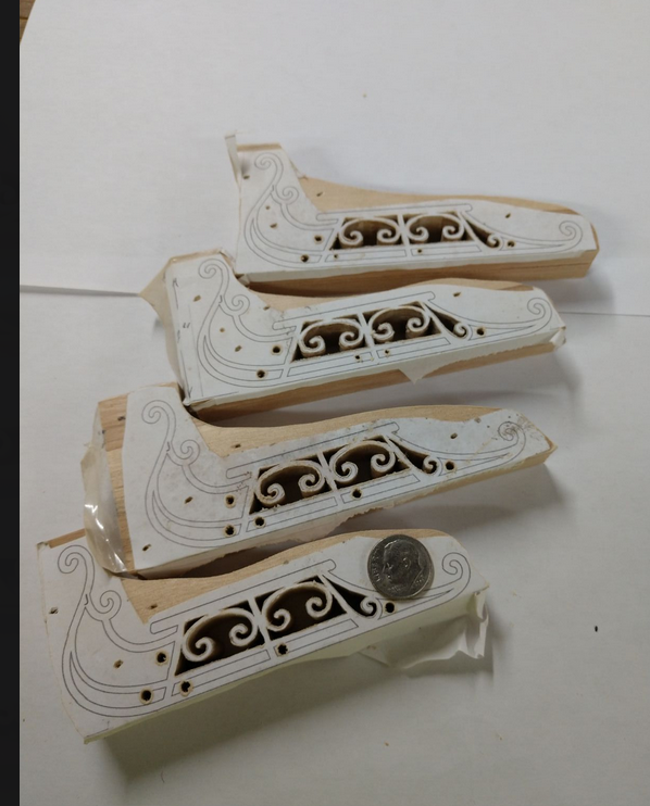

November 6, 20233 yr Author comment_323673 Have all the sleigh runners cut, did the easy ones last . I'll sand & stain these then move onto the sleigh bodies. The bold line to the left is a #2 blade the other line is a pencil line for reference. Report

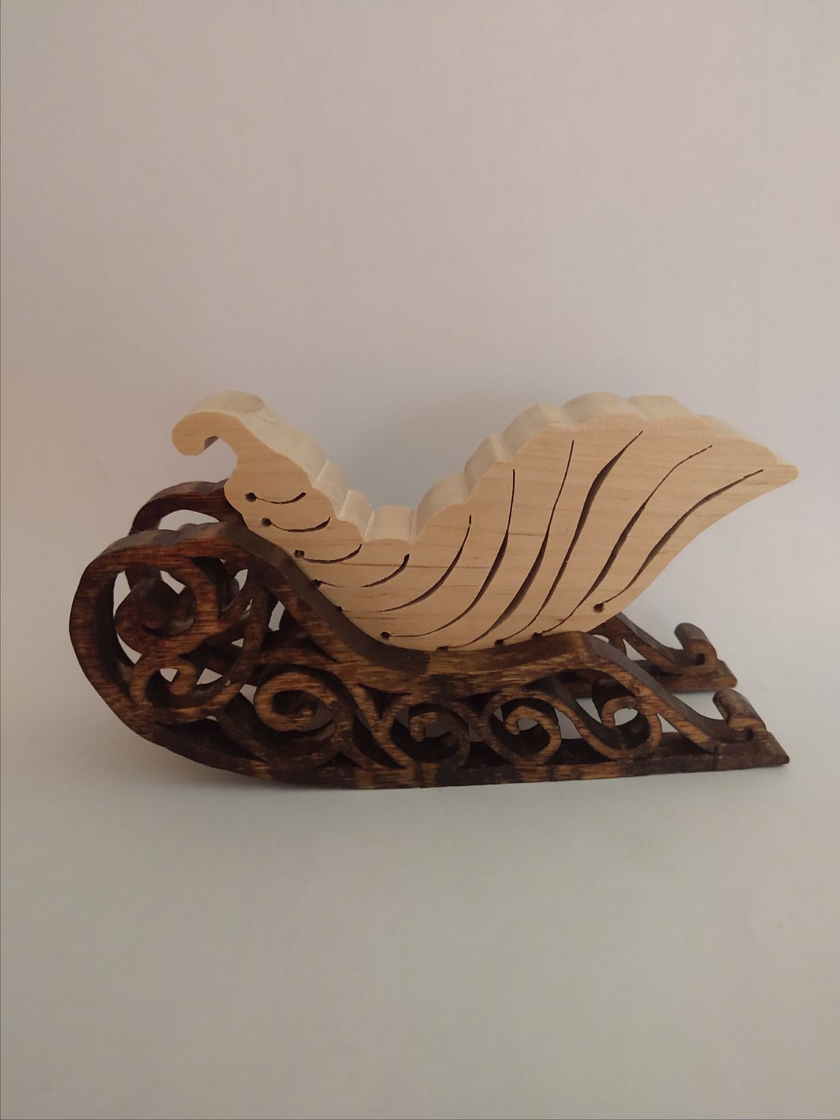

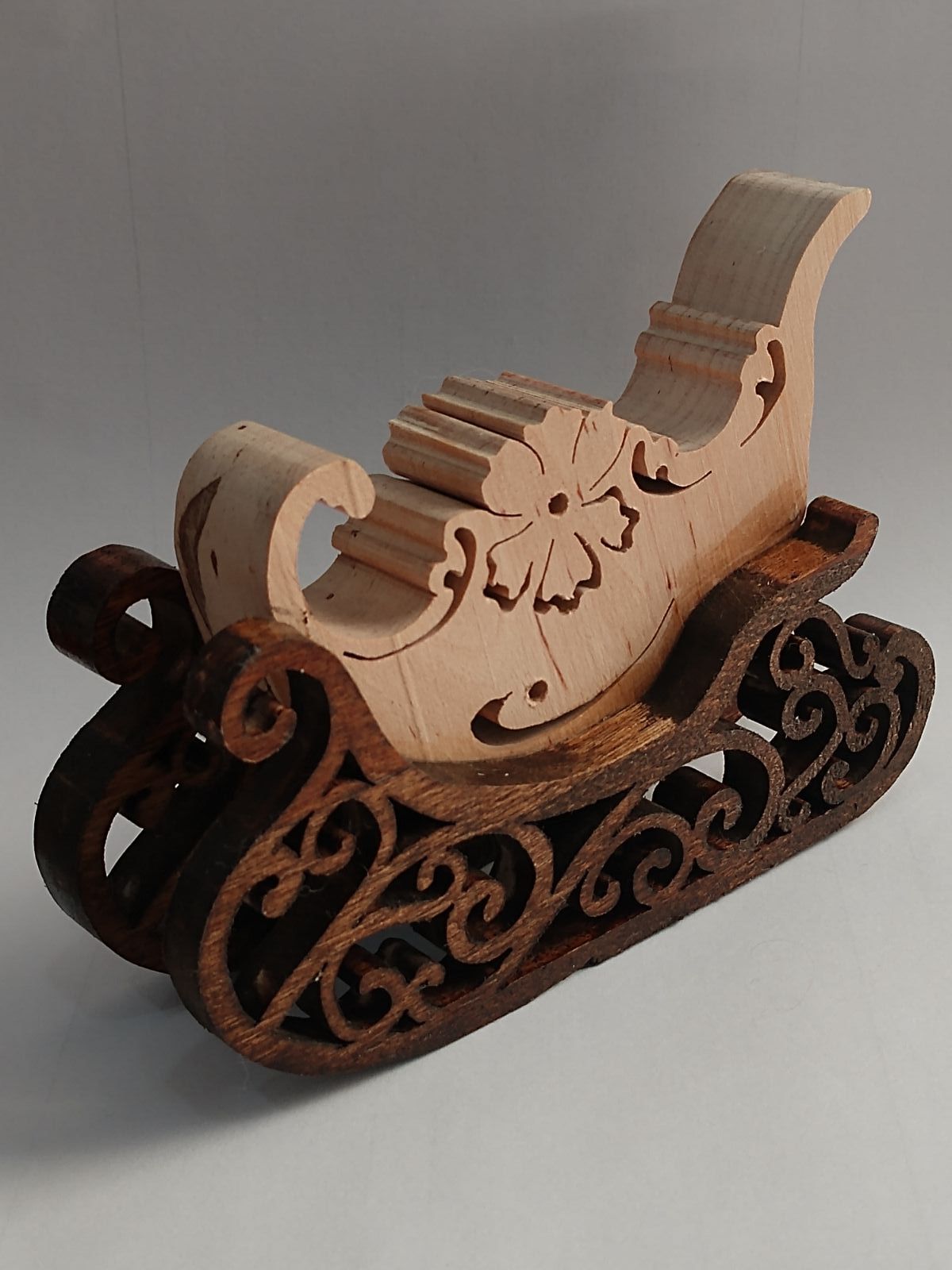

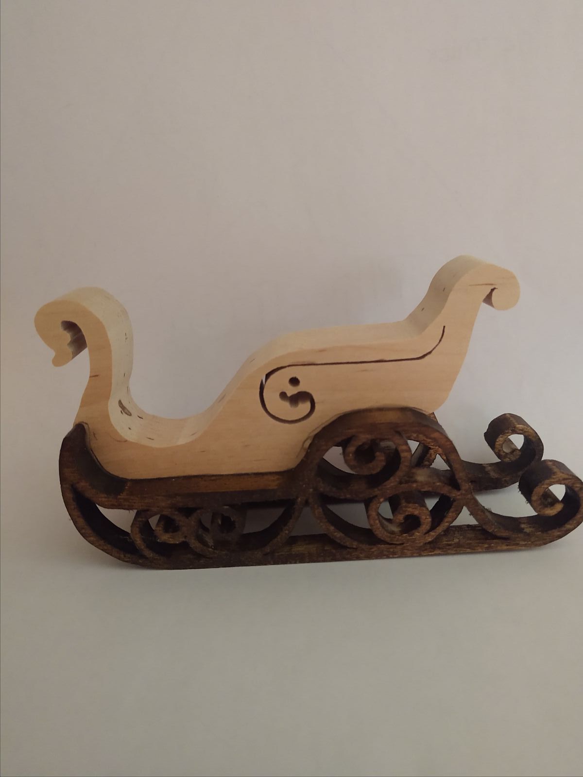

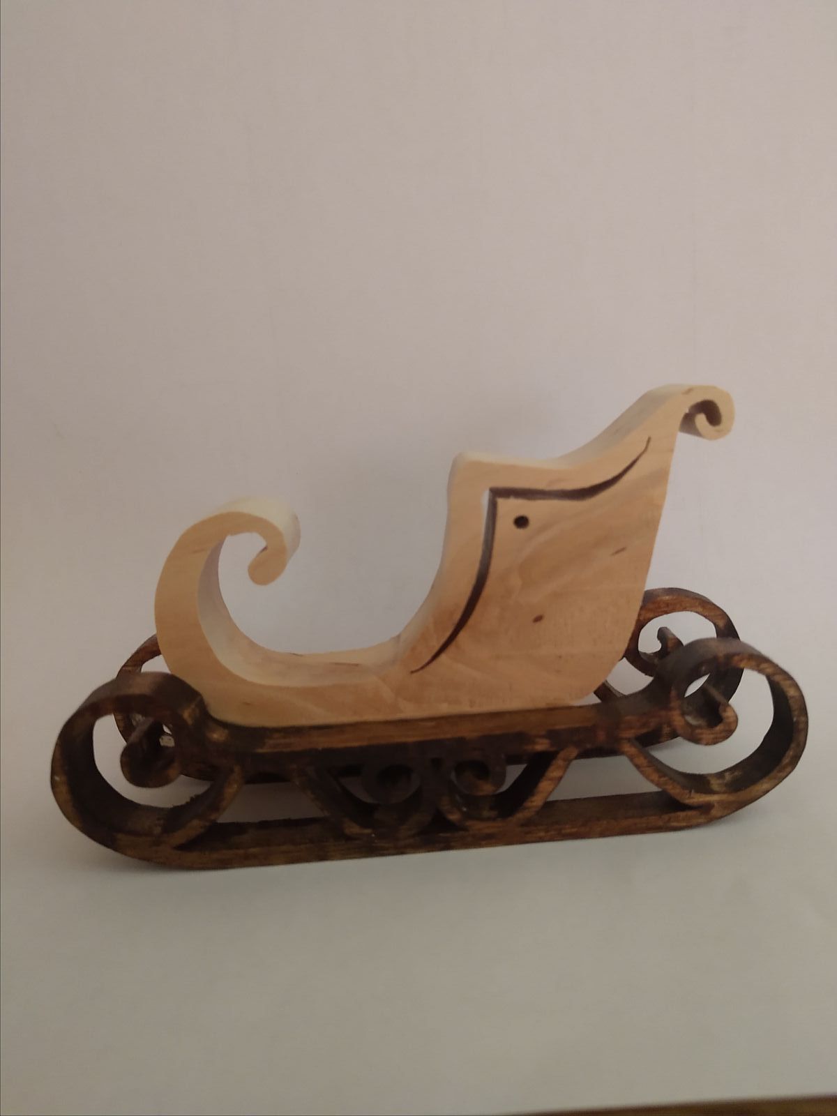

November 16, 20233 yr Author comment_324101 Stain is dry & bodies are cut & glued to the runners. Earlier posts I said I used a #3 blade, I should have said #5. Report
