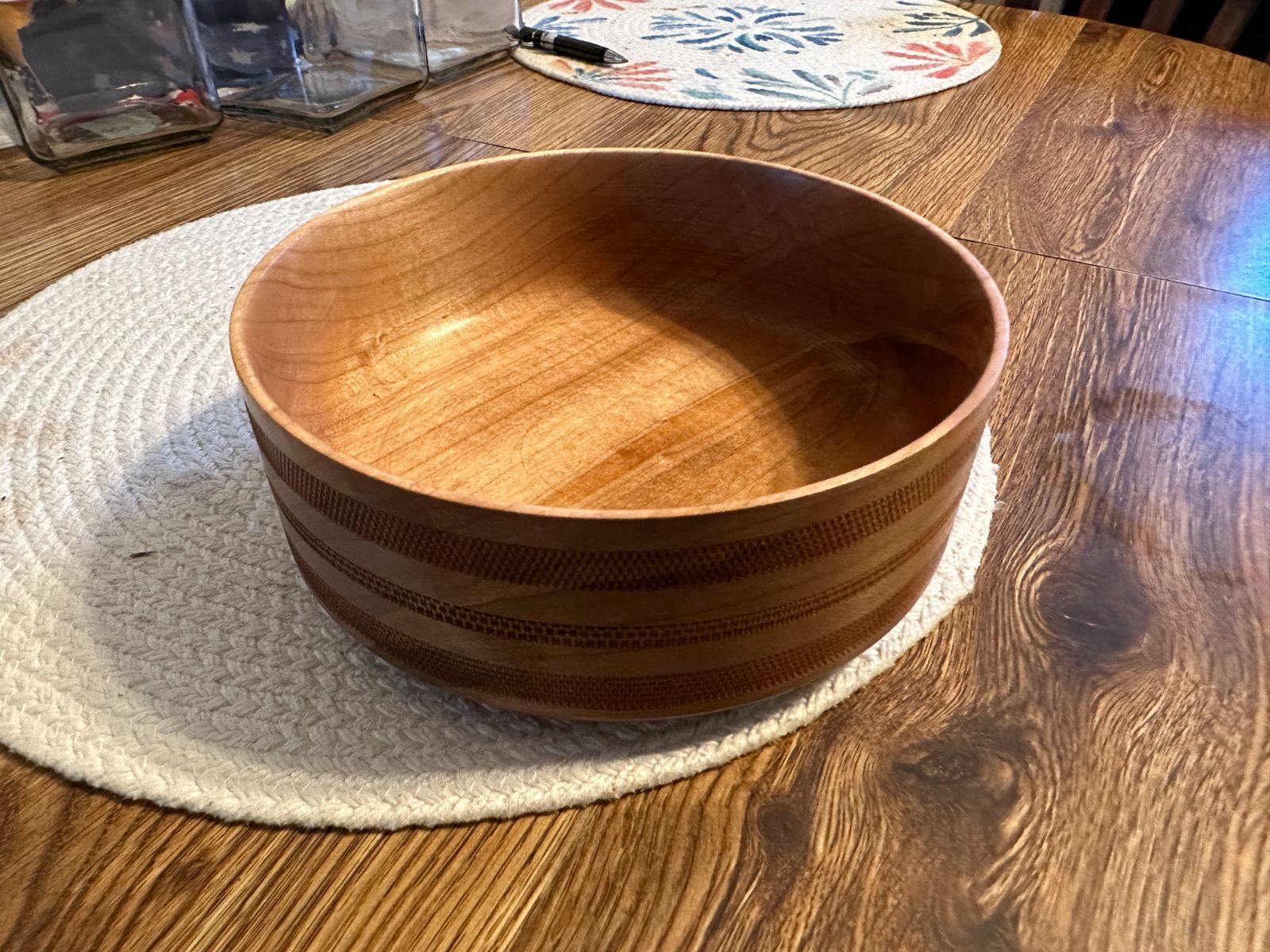

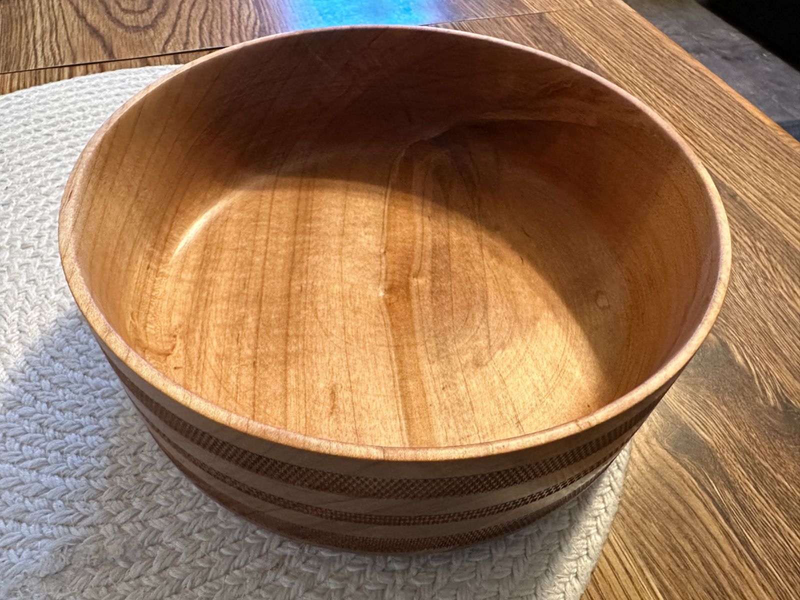

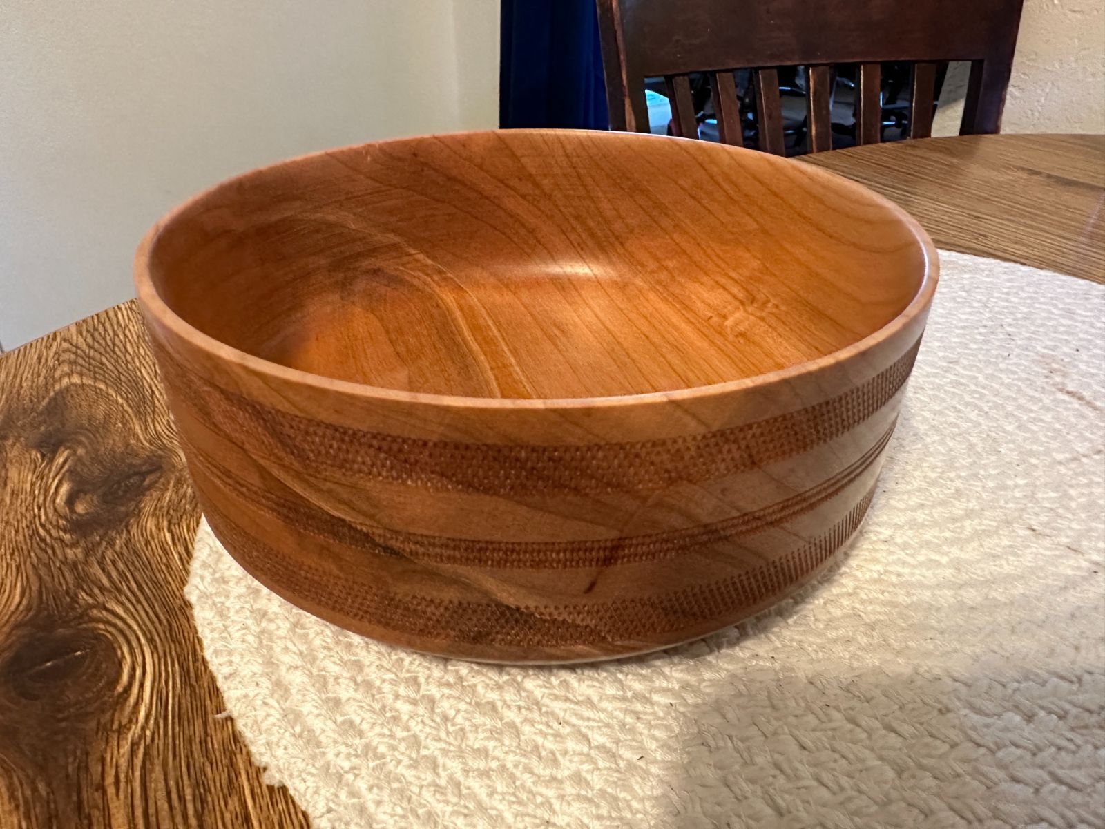

September 20, 20233 yr Author Popular Post comment_321369 Maple bowl finished with Danish Oil. This is the first time I went so thin on the rim of the bowl. I am usually worried about it going too thin and cracking. Thought I would give it a go. Report
September 20, 20233 yr comment_321372 19 minutes ago, nevinc said: Thought I would give it a go. Well ya' did pretty darn good Nevin. Looks great. Like the detail on the outside. Report
September 20, 20233 yr Author comment_321373 1 minute ago, Grandpadave52 said: Well ya' did pretty darn good Nevin. Looks great. Like the detail on the outside. Thank you, I appreciate it. Report

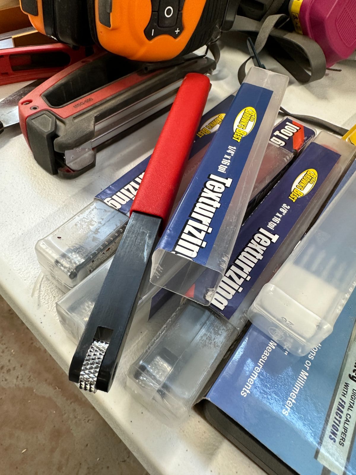

September 20, 20233 yr comment_321377 Fantastic! What tool did you use to make the embellishments on the outside? Report
September 20, 20233 yr Author comment_321379 30 minutes ago, lew said: Fantastic! What tool did you use to make the embellishments on the outside? Ron Brown's texturizing tools. I have four different sizes and number of teeth on the rollers. Edited September 20, 20233 yr by nevinc Report
September 21, 20233 yr comment_321426 Nice touch with the texture. As a suggestion I like to cut a line with point tool on both sides of texture and then burn that line in . It just sets the texture off even more. You are really coming along with improving your work. Report
September 21, 20233 yr Author comment_321457 6 hours ago, Gerald said: Nice touch with the texture. As a suggestion I like to cut a line with point tool on both sides of texture and then burn that line in . It just sets the texture off even more. You are really coming along with improving your work. Great suggestion, I had been tempted a few times to buy a set of burning wires. I have seen ways to use what I have in the shop already as a cheap alternative. I will definitely give that a shot. And thank you! Report
September 21, 20233 yr comment_321458 13 minutes ago, nevinc said: Great suggestion, I had been tempted a few times to buy a set of burning wires. I have seen ways to use what I have in the shop already as a cheap alternative. I will definitely give that a shot. And thank you! Go to the local music store and get some discarded music string- banjo, guitar, etc. Different diameters for various burning widths. Report
September 21, 20233 yr Author comment_321459 8 minutes ago, lew said: Go to the local music store and get some discarded music string- banjo, guitar, etc. Different diameters for various burning widths. Great idea, thanks! Report
September 22, 20233 yr comment_321472 6 hours ago, nevinc said: Great idea, thanks! To echo Lew yes Guitar strings. You can cut one in two and have one and a spare. Don't forget to turn some handles for them . Drill a small hole , large enough for two wires. Put the wire thru hole and wrap around to go into the same hole again and pull it tight. It will not come out. Eventually burners do break. Gonna have to make a picture of that. Report

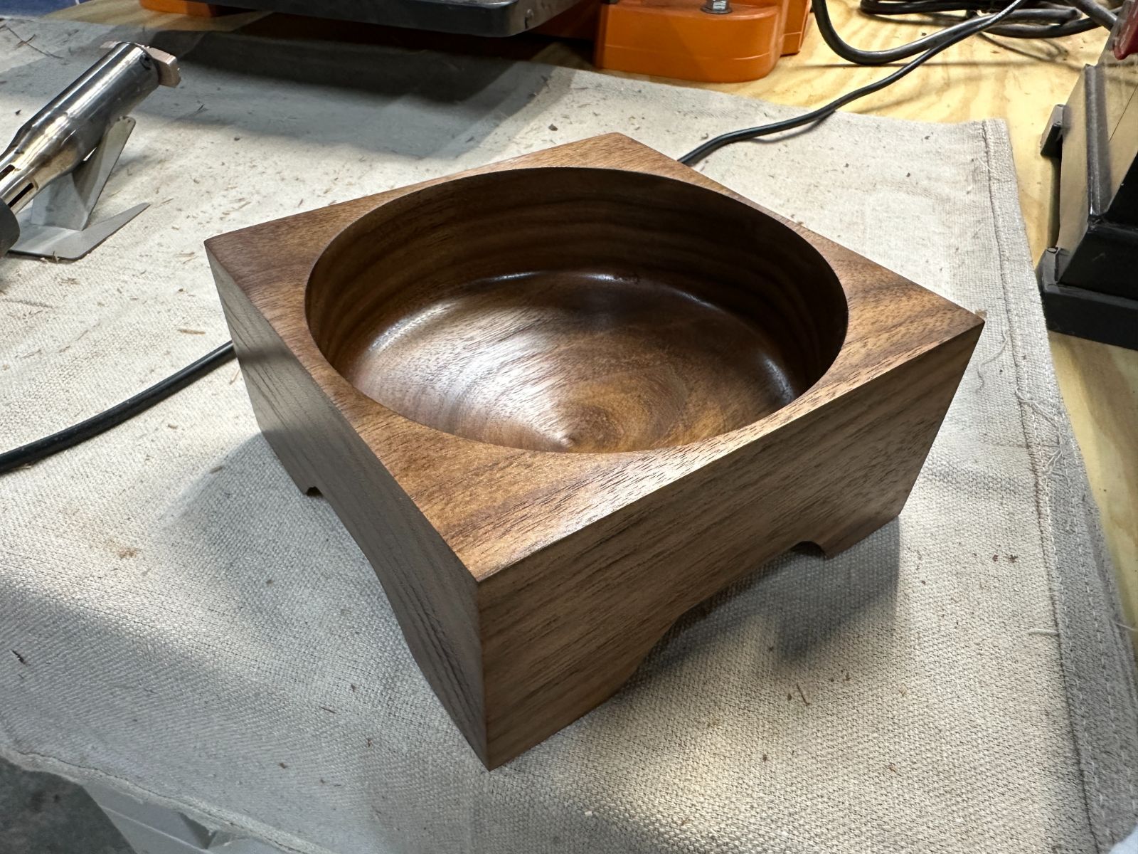

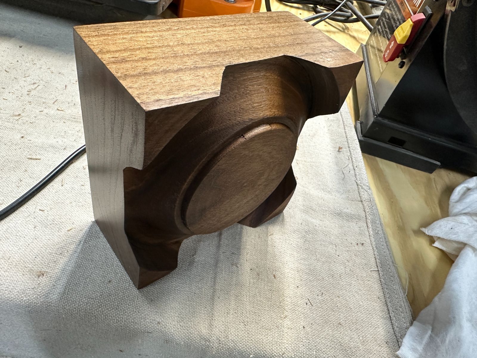

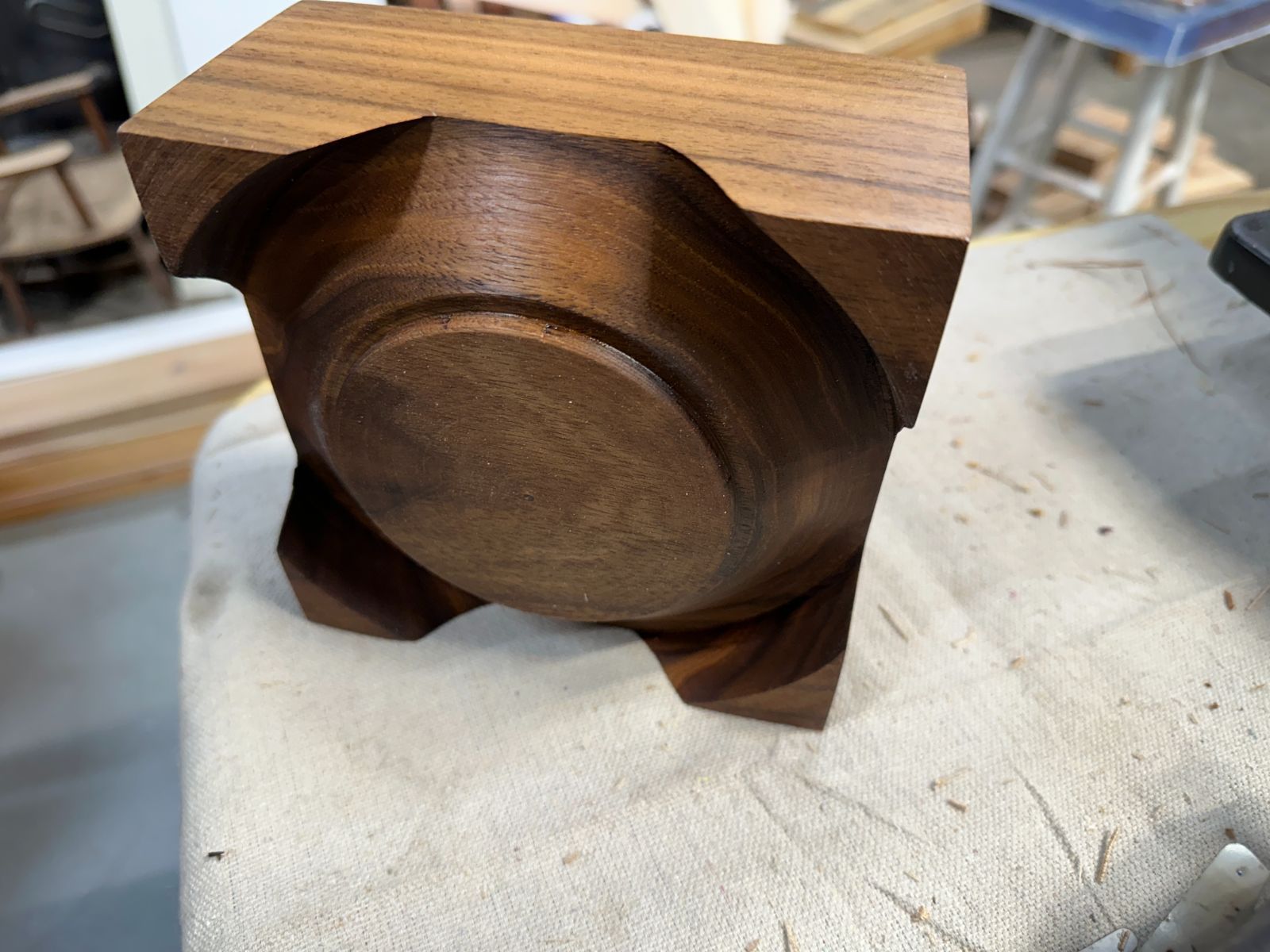

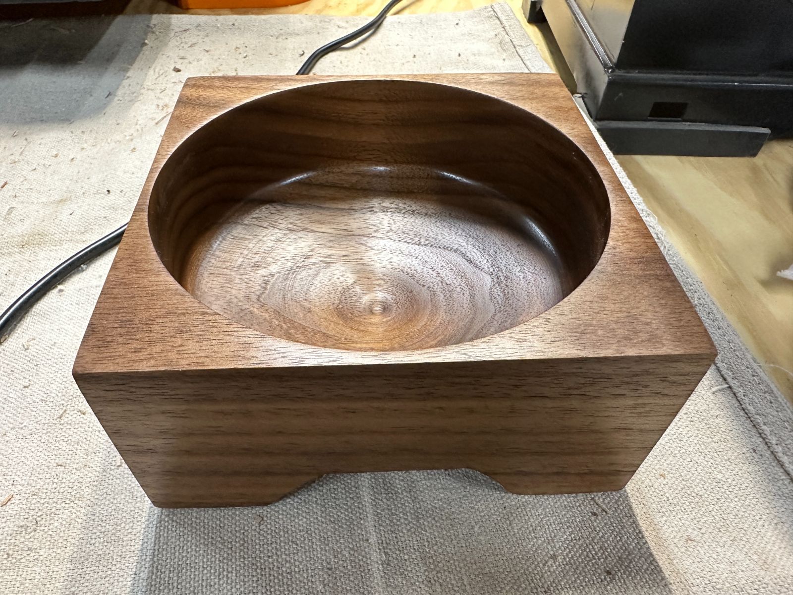

September 23, 20233 yr Author comment_321542 Working a piece of Dark Walnut. Just playing around with new shapes. Finished it with some Teak Oil. Report
September 23, 20233 yr comment_321543 Really neat. Looks like the “bowl” is perfectly centered in the square base! Report
