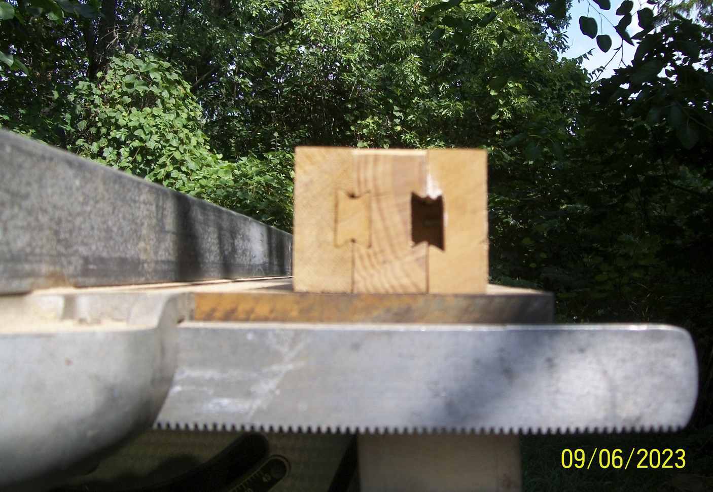

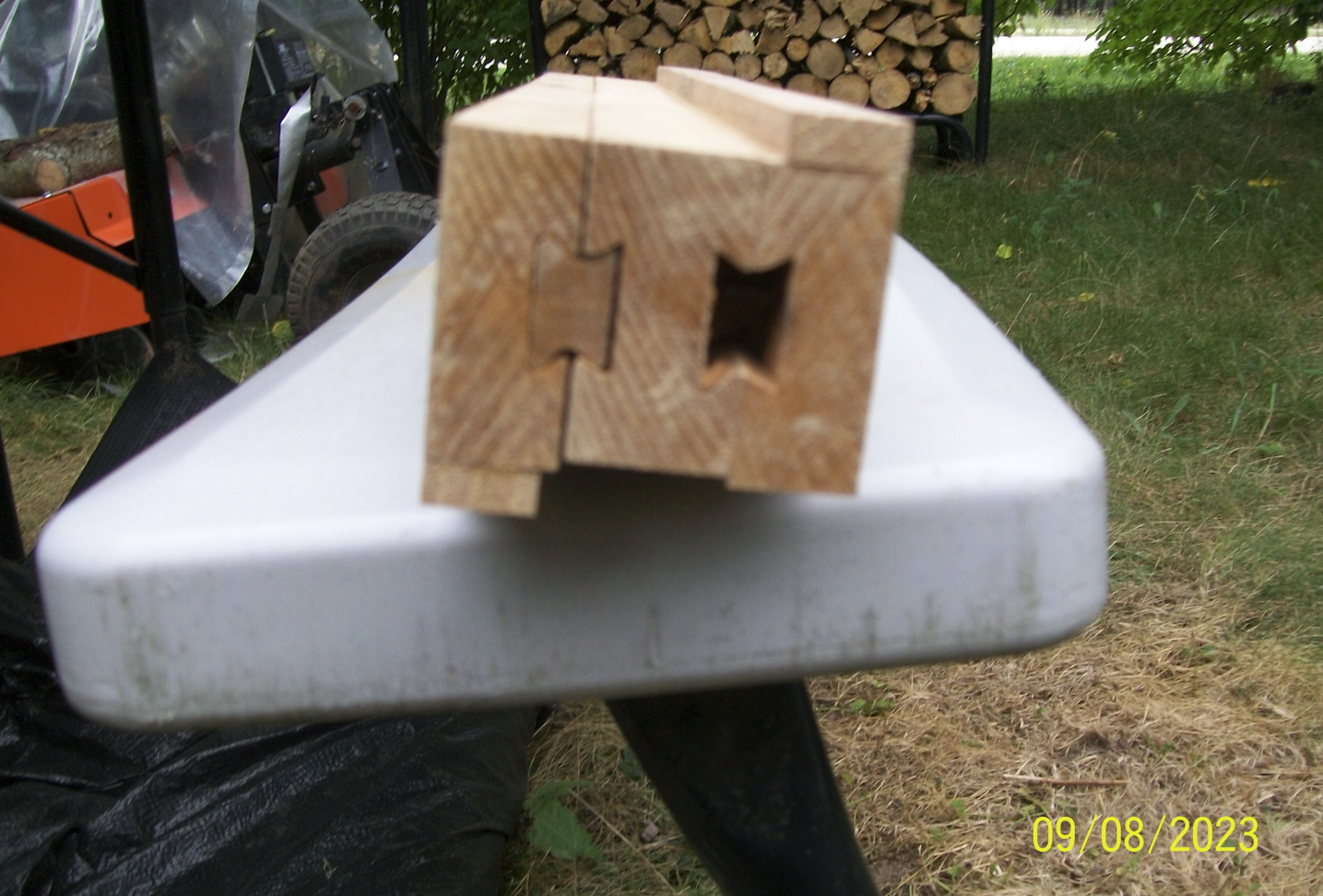

September 8, 20233 yr Author Popular Post comment_320798 Started with one of these halves of an Oak table top. Of course, one of the problems of using salvage lumber is that you have to strip it so you can use it for a project but the price is right. From the half I started with I cut out the bottom for the case. The table top half had a slight bow to it but we have ways of working around that and at the same time add feet and a cord chase. I still need to cut the cord access hole. The 20" table slides required a bit of modification to serve my purpose. They're designed for one side mounting, and I need to mount to them from both sides. Here's a photo before modification. I squared them up on the table saw so I could add a couple of cleats for two sided mounting. Here they are after adding the cleats. I'll have to trim them to size after getting the monitor box assembled. And here's the pile of parts that will make up the monitor sliding box. The 1/2" Oak stock came from a pair of salvaged dresser drawers. I'm even using the Oak veneered plywood from the drawer bottom for the back of the monitor box. Now I'm waiting on the glue to set so I can glue some more pieces together. Report
September 8, 20233 yr Author comment_320802 48 minutes ago, lew said: Pretty cool drawer slides idea! They're actually table slides for adding leaves to an old round table that the veneer didn't survive getting wet during one of Bruce's "Curb Shopping" expeditions. I didn't think drawer slides would work to well sideways from their normal position. Report

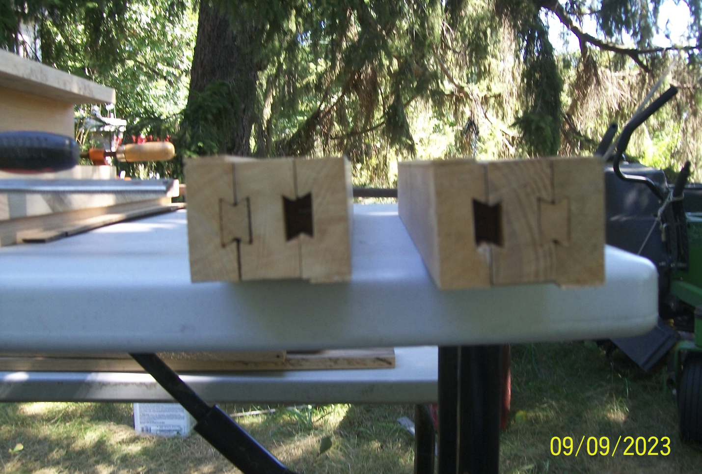

September 9, 20233 yr Author comment_320847 6 hours ago, Cal said: Great start to an interesting project Larry. Or perhaps since we are seeing this two weeks after the fact... maybe you are done? 2 hours ago, John Morris said: Well he is two weeks from everywhere! Problem is am I two weeks in the past or two weeks in the future? Made a little progress this morning. I needed to determine the final cut size for the table slides so I did a test fit of the monitor box parts. The board above the opening is for clamping purposes only. There will be a door mounted on that end for access to the monitor controls. Here's the cut to size table slides. I have a few holes to drill before I can do the glue up. Report
