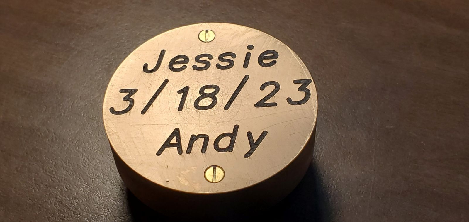

May 7, 20233 yr Author Popular Post comment_313823 Engraving the bottom of the bowl... or how I learned to love the bomb. My first thought was to engrave the bottom of the bowl but the wenge with soft/hard wood didn't engrave very cleanly. Not happy with that I decided to make a brass medallion and screw that into the bottom of the bowl. My first attempt was less than optional. Facing off some brass stock. First attempt at engraving was a failure... couldn't get the stock perpendicular to the spindle due to the OD not being perfectly round. Ok, I thought I'd use my 5-C collet holder to hold a chunk of brass and that will be easy to align. The max on a 5-C is 1" or so. I turned down the back side to fit the collet. Then with the chunk in the colllet faced off the top. I did a test engrave with a different setup (v-carve this time) on some oak. Happy with that I engraved the brass. Then Painted the letters and drilled holes for the screws. Last I made sure the recess was the correct size for the medallion, the dental floss was to make sure I could get it out if a bit tight. I did refinish the letters and seal it before attaching to the bowl. End of metal working! Next up gluing up the rings. JT Report

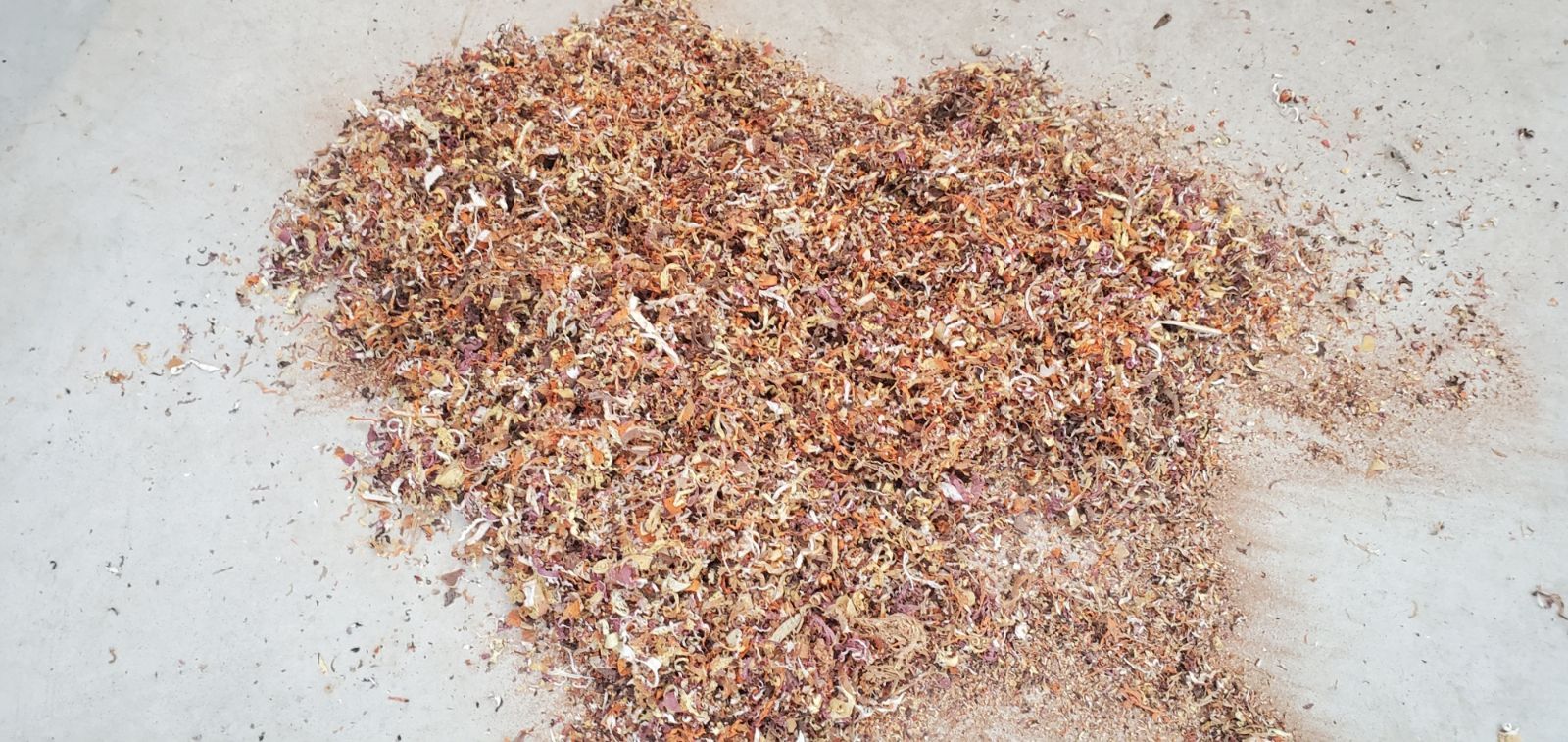

May 10, 20233 yr Author comment_314010 Glue up disk got too small so I had to make a new one. Last ring! Turning a Dizzy Bowl does make some interesting chips... JT Report

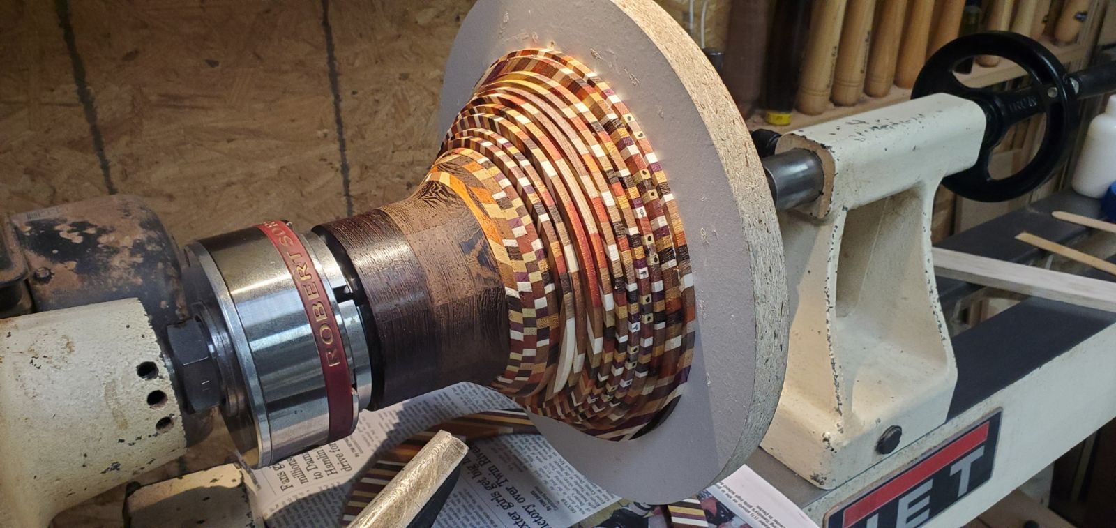

May 14, 20233 yr Author comment_314280 Final sanding of the Dizzy Bowl and due to an issue with the wenge being a bit soft I had to switch to holding the bowl with external jaws. I started sanding with 40 grit for some final shaping because the glue joints being harder than the wood made it impossible to use cutting tools. I went all the way up to 2500 grit a few times restarting at 80 grit if I noticed a scratch in the bowl. JT Edited May 14, 20233 yr by jthornton fix image names Report
