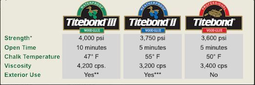

Here's a neat little TB chart. Kind of shows a story. We can get in the weeds with this stuff, just like our endless discussions over to poly or not to poly.
But hey, to each their own, TB or not TB :lol:

TB3 isn’t the easiest to work. It’s hard to clean, tends to be rubbery. It’s like painting the interior of your house with exterior paint because it offers more protection.
I know it’s more difficult to work with and should be used where it is designed to work at its best..
We use TB1 in cabinetry mainly because of ease of use and easy to clean and it’s an interior project.
We use TB2 in table making because it offers some resistance to moisture.
We use TB3 for table exposed to exterior conditions.
Now when I worked for Jakobe Furniture we were having problem with the tables warping after assembly  with TB2. We were about ready to go to epoxy, etc or TB3 when Titebond representives came in and said there would be no gain as it wasn’t tye glue causing tye oroblem , but the way we were stacking them.
Nothing wrong with it you want to use it. Any gain, no…

I'll have to respectfully disagree Billy, it has a longer open time for complicated glue ups. I've used TB original while trying to maneuver different parts around and clamping and complex glue ups, and I found myself cussing up a storm cuz the glue closed on me. I switched to TB III and enjoyed a longer open set time and getting everything in place was much easier. As far as cleaning, I haven't seen any difference in clean up between any of the TB's. Perhaps I'm just not observant in that area to even notice.
Back to the OT though, for Marks purpose, TB III was perfectly good IMHO. And in Marks case, having that longer open time is very important.
Remember now Billy, IMHO, and we all got em! :lol:

Open time? That’s got nothing to do with it. It’s thicker. As it dries it’s harder to clean. If it gets into  pores of the wood, it’s much hard per to get out.
TB1 is designed to be fast. If you don’t want it fast use regular white glue or use TB extend. TB 1 glue is designed to be fast. We want a set time of 10-30 minutes .,
TB3….. it brings no advantage to my projects were it was designed.I produce a lot of projects. I use TB1 on almost all my projects and will ship to TB2 on a top/ end table, etc that might catch a cup or two. Now the  glue isn’t as much the protection as the  finish.
As what glue I use on each project I display, but remember I’m pretty fast..

Your experience doesn't match mine with the product Billy, it's not a bad thing, it just is what it is. We have different skill sets and uses for these glues. I like the longer open time of TB III, it's works for me.
I understand, I’m just pointing out the difference between need and want..
Edited by BillyJack
Hey there is another aspect to this discussion. That is that some of us do not use enough glue to keep 3 kinds on hand and therefore we have to decide on the properties that will fit most of the projects we do and compromise on others. I use TBIII but that does not mean everyone should.
