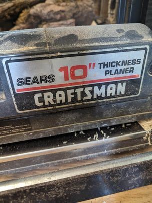

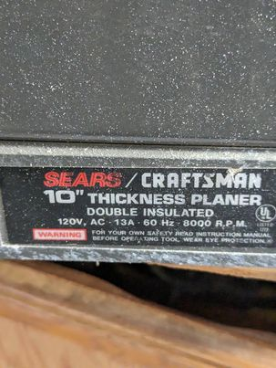

April 22, 20233 yr comment_312863 Lissa, tell us about your planer. Inquiring minds want to know... Report
April 24, 20233 yr Author comment_313019 i will share about the planer but raining today. so if i dont forget will get info off it tommorrow Report
April 28, 20233 yr Author comment_313195 here is the pictures of the planer i promised. been raining for two days here. so got all wet to get pictures. that is how important you guys are! lol, I also do plan on seeing if i can find instructions online. but I was being MAN-Like and figured worry about instructions later. Mr. charlie did teach me safty before he gave it to me. Edited April 28, 20233 yr by Lissa Hall added information Report

May 24, 20233 yr comment_314945 you may very well be able to find a manual online...i found several referenced, so it depends on the number you have. 351.217130 351.233731 351.233831 per vintagemachinery web site 351 was made by Colovos Co. Report
