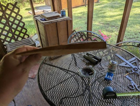

So a kind gentle man who passed away last year, passed on his old wood planer to me. he had recently sharpened the blades as well. but... it did not come with full instructions other than what he told me verbally. I going to try and look them up online. but I wanted to ask you experienced people a question. How thin is it safe to plane a piece of wood. a aquaintence gave me several pieces of cedar that was cut in wedge form. I am working on my medieval library and thought is would be nice to line the apothcary drawers with the cedar. But being in wedge form (one end is pretty thin.  the only way i can think to equal it out is the planer. or do any of u have btter ideas. Widest end is 5/8th lowest is 1/8

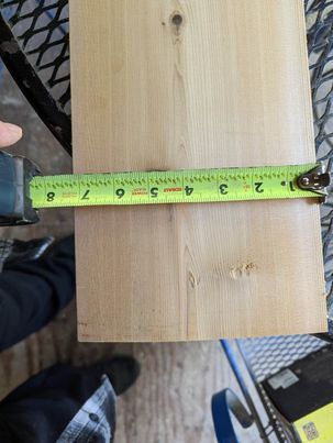

Not seeing the wood my 1st run at it would be to resaw it using a band saw. How wide are these boards? If only a couple of inches maybe a table saw if you don't have access to a band saw.
I'd take two wedged boards and glue them back to flipped back to make a uniformly flat board first.  After that you could decide if you want them planed thinner or resawn into two thin boards that aren't tapered.   One thing to consider is that boards shorter than the length of the planer can get stuck in it while being planed. When I have short boards that aren't safe to plane I run them through my drum sander to thin down.

Sounds to me like what your friend gave you was a bunch of cedar shake shingles.  I would be concerned that they may split on you when you go to mount them after you plane away most of their thickness.
i added pictures of the wood. i do not know what a drum sander is. i was thinking they were shingles. but not mounting them just want to Line some drawers with it.

I t would be very hard to plane to 1/8". I've planed to 1/4" thick in the past but even that depends on the wood...I was using maple which is fairly stiff. Cedar isn't as stiff and may well lift up on the leading edge as it enters the planer. This pretty much guarantees a ruined piece of wood. The wedge shape would make it an even trickier task, using the wdge trick mentioned above would help; but truthfully I think I would pass on this attempt. Should you decide to go ahead be very careful when you run the boards through.

I would run it through the table saw, rip off the pointed end so the new thinnest part is ... 3/16”?   Then put a sled of mdf or ply in the planer to raise the effective bed height, and then start planing until you get a consistent size.

I believe it is a cedar shake shingle.

I have to agree with @Cal. I don't think it would be safe to run pieces like this through your planer. Not sure how long your pieces might be, but from the pictures you look to have cut-offs of bevel cedar siding? Most likely this is white cedar.
For your project, I suggest these--->  Aromatic Red Cedar Planks HERE. I've used these for drawer liners as well as to line the interior of blanket chests. Tongue and groove lets you brad nail through the tongue like installing flooring to conceal the brads or extremely small projects, just use double-side carpet tape.
