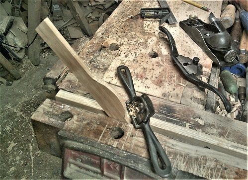

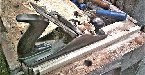

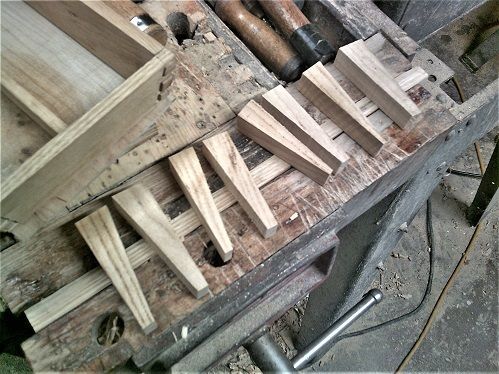

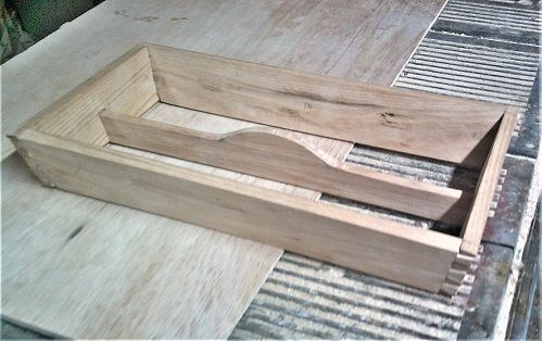

April 13, 20233 yr Author Popular Post comment_312370 Decided this needed a handle of some sort...sorted through the pile again..found this..thing... One edge was a LITTLE better than the other..jointed that one.. Then laid the slab over, in the vise.. Same plane to level things up/down... Draw a shape on the blank..cut the blank to length with the angled ends, then bandsaw the shape...was a bit rough..we have ways... Spokeshave to smooth things down a bit.....needed to lay out the stopped dados to house this handle... Chisels to remove most of the waste....then plane to clean up... Then a dry fit, to make sure the handle is not too long... Those things sticking up? Are cauls...8 of them.. Without these, clamping during a glue up just ain't going to work.. Test fit half of the clamps, for now... Next episode? A glue up. and a clean up....glue up first.... Stay tuned Report

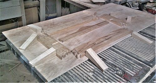

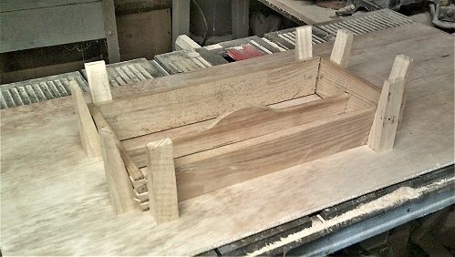

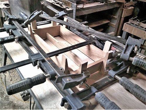

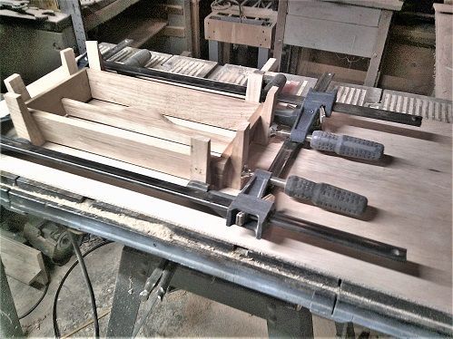

April 13, 20233 yr Author comment_312374 Glue up..after a full day of other things to do... Plywood on top of the tablesaw...flat surface to work off of..all laid out, awaiting the bottle of glue and a brush to moosh it around with.. Let the fun begin! Bottom 4 clamps first, check for square...then add the upper level of clamps...check for square again..diagonal clamp to pull until it is square.. Let this sit overnight... Today? Remove the clamps and cauls.. Hmmm...toss , or keep? Fresh out of the clamps... Did not want to try to clean this mess up with a hand plane, so.. . We have ways...brand new belt, too... Bottom edge and top edge are now flt...working on filling any gaps... Slab under the tray will be the "bottom" and is 1/8" thick Ash....spread a bit of glue around.. Add 3 cauls across, for the clamps to hold onto...letting this sit until tomorrow,,,then trim the bottom down to size.. Stay tuned Report

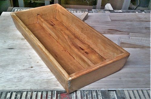

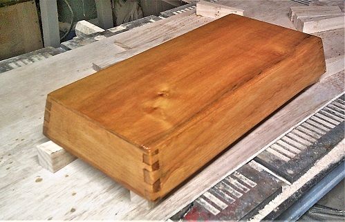

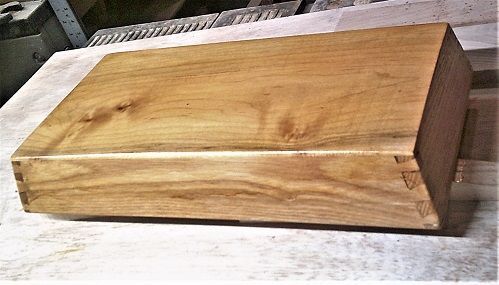

April 14, 20233 yr Author comment_312432 1st coat of Amber Shellac will be getting sanded down, this evening... Dealing with Blood Sugar spikes, at the moment....not fun... Sanded to 220, and wiped down... Bottom of the tray....tried to line up the grain a bit....got close? An end view...was a few runs...second coat will cure that.. Will let coat #2 sit a spell.... Then maybe a top coat of Poly? Stay tuned... Report
