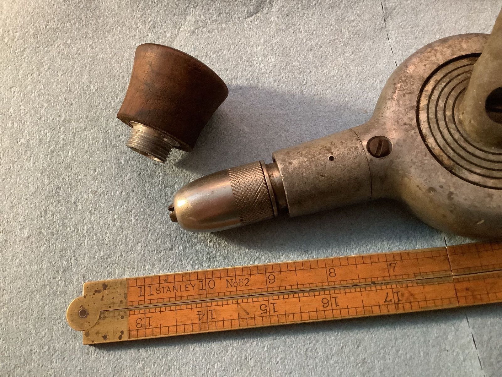

April 12, 20233 yr comment_312322 I just acquired this old brace, i have not started cleaning it, looking closely i cannot find any markings. Anyone have an idea what it is? A couple of key items: The head is cut flat on 2 sides, looks original. The head does not turn at the moment, but since the flats are at an odd angle (not aligned with the frame) i’m thinking it should turn. The small device next to the gearbox can be pulled out and turned, it controls the ratcheting of the chuck. Clockwise, ccw and fixed. The shaft sticking out of the 90* corner looks like it accepts a crank handle, and it turns with the chuck. Report
April 12, 20233 yr comment_312325 Looks like it was designed to work into corners. Not sure who made these. Report
April 12, 20233 yr Author comment_312326 Yes, it looks like a combination standard brace, with accommodation for a crank to be used in a corner brace situation. Report
April 12, 20233 yr comment_312331 Plus, one can add an extension to the square end, and either a ratchet or a second brace can turn the bit..IF the space is too confined. Report
April 13, 20233 yr comment_312342 Sweet score Ed. I'm no help ID'ing it though. My knowledge of hand braces it very limited. Nothing visible on the chuck? Or perhaps on the "gear box?" Report
April 13, 20233 yr Author comment_312367 Might be something on the chuck, and maybe the frame, need to clean it off. The gearbox is less obscured, i would have expected something there … but no trace of markings. Report
April 14, 20233 yr Author Popular Post comment_312430 Ok, might have found something. I was looking at a tool collector site in New Zealand and saw a picture, did some digging and found two possible matches. It’s either an Atkins or a Bennett by Lancaster. I’m leaning toward the Atkins based on a couple of details. Patented 1905. Report
April 15, 20233 yr comment_312437 Cool Ed. My vote is for the Atkins but I might be a bit bias based on region. Report
April 15, 20233 yr Author comment_312460 I agree, because of the area directly above the chuck. The lancaster seems to have a longer space with some kind of ring. Maybe some markings will appear when i clean it. Report
