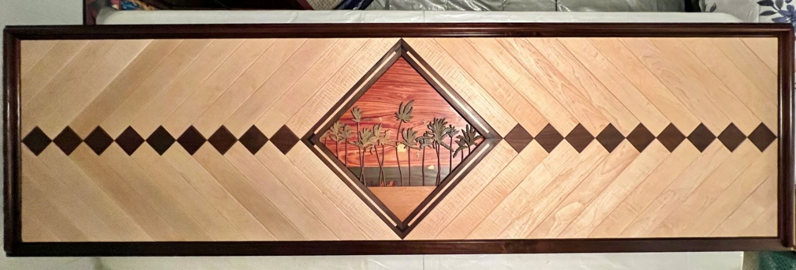

Popular Post Intarsia Mike Posted February 28, 2023 Popular Post Report Posted February 28, 2023 Hi Everyone This past summer I was asked to create a custom bar top for one of my sons . We originally talked about using slate to fill in the top and would use table top resin to make it smooth. It would maybe have a nice wood frame and would sit on a knee wall in his man-cave. After taking some measurements and discussing options, I suggested maybe doing a custom Intarsia inlayed into the top. He liked the idea so I suggested he find a photo he would like to use as a subject. He sent me a photo he took while on vacation in Hawaii, I thought it would be hard to do as an Intarsia but would see what I could do. I drew up scaled plans for the top showing the layout for the framed intarsia along with the field for the rest of the top. We decided to go with Peruvian Walnut for the frame and accent diamonds and tiger maple for the field pieces . I chose to use 3/4" MDF as a base to build from mostly for overall stability . Did all the millwork for the frame and decided to do accent inlays of Ebony and BE maple around the perimeter. Got all of the maple pieces, diamonds and frame for the intarsia cut and fit into place. On to the custom intarsia. lew, Thad, Grandpadave52 and 7 others 4 2 4 Quote

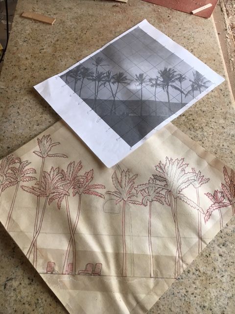

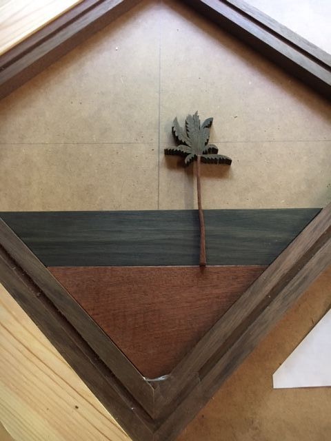

Popular Post Intarsia Mike Posted March 1, 2023 Author Popular Post Report Posted March 1, 2023 Now that I have the bar top pieces and frame for the intarsia all locked into place I can concentrate on the custom intarsia. I made a copy of the subject photo with the proper orientation and drew grid boxes to correspond with the scaled up grid boxes on the pattern sheet. I hand drew the outlines of all the palm trees by matching what is in the subject photo grid boxes. This keeps everything to scale. Once the pattern is finished it is cut to size to fit the frame. At this point I can begin the intarsia. I like to build my project from the bottom up, so after determining the thickness of the wood I will need to use I start with the beach in the picture. I also cut the first palm tree. Because this project will be encapsulated with table top resin I decided to to an overlay instead of an inlay for the intarsia. Now it's a matter of tracing all of the pieces onto sticky back label paper, cutting all of the palm trees and background pieces to create a masterpiece Woods used for the intarsia so far are Australian Lacewood (beach). Blue Mahoe (water) , Tulipwood (sky) ,Yellowheart (sun), Lignum Vitae (Palms) and Fishtail oak for the tree trunks. To be continued- KevTN, HARO50, Thad and 4 others 6 1 Quote
Popular Post Intarsia Mike Posted March 2, 2023 Author Popular Post Report Posted March 2, 2023 So up to this point in the project I have all the Palm trees cut, detailed and glued together into sections. I have inlayed the sun into the background and will make the little lawn chairs. Standing back and looking at it, there seemed to be something missing to balance the upper part of the scene. Discussing the situation with my son we figured that another palm tree was needed in the center. After more discussion (among other things) we decided to include a picture of the fabled " Maui Waui Hemp Palm" into the project. Oh Yeah, that'll work! Do the chairs, a boat, and some birds and it will come to life. To Be Continued! Thad, Gerald, Gene Howe and 3 others 3 3 Quote

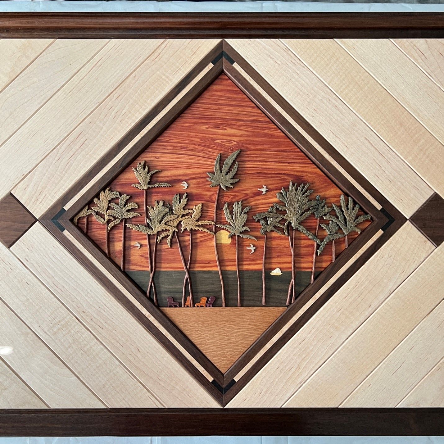

Popular Post Intarsia Mike Posted March 5, 2023 Author Popular Post Report Posted March 5, 2023 " Part Of The Wall " So after spending considerable time watching videos of table top resin installation procedures and techniques I jumped right in with mixing and pouring the first batch of resin on my test coasters. Learned that mixing the 2 parts properly is the most important part of the process. The first pour is the seal coat which is 1/8" thick. You only have a few minutes to torch any bubbles that rise through the resin before it starts to set-up Important to cover up the finished pour to keep dust from settling on the resin. The second pour is the final coat (up to 1/4" thick) using the same procedure (mixing, torching the bubbles and covering up). Overall was a good skill learning experience and will be useful on future projects . After 72 hours the resin is cured enough to be touched and handled without worry of scratching. So here are a few photos of the finished " Maui Waui Custom Bar Top" This was a fun project bar top install video.mp4 Grandpadave52, Thad, KevTN and 3 others 3 1 2 Quote

Grandpadave52 Posted March 5, 2023 Report Posted March 5, 2023 Shame to use that as a bar top. That should be in a gallery as a wall-hanger work of art. Absolutely gorgeous Mike. Even the angle supports are designed with class. Thanks for taking us along this amazing build. Ya' done good "pops"! Real good! BTW, love his guitar collection display too. KevTN, Cal, Intarsia Mike and 1 other 3 1 Quote
