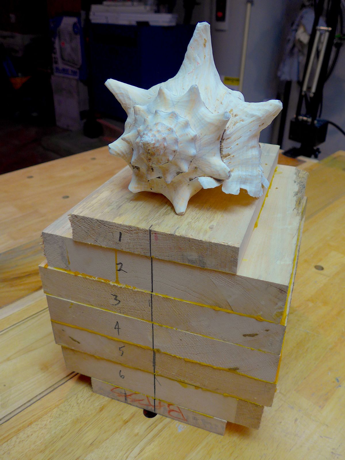

I finally have some free time and want to do a seashell carving. Here's the original and I'm not sure of how to start this carving. I'll do some "thinking time" before starting. Maybe get my lathe involved before carving begins? Of course, basswood and gold leaf when finished?L1040779.JPG.263445a08c388908fe4a122b6da6a95a.JPG

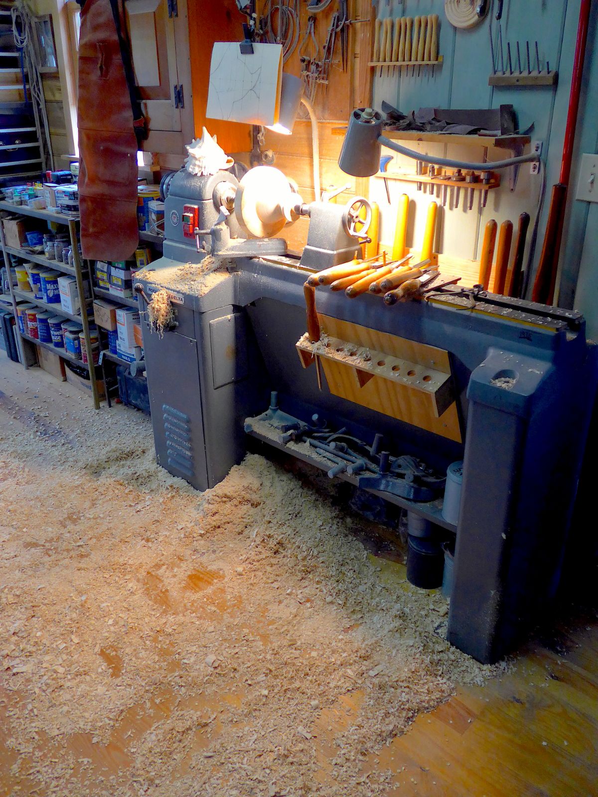

Here's the glued up blank on my lathe. It probably weighs 15-20 lbs. I've knocked off the corners, on the table saw, before mounting it on my lathe. You don't want to be in front of it when you start the lathe(very slow speed). Can you guess where I'm headed with this carving? By the way, basswood is $hit for a turning wood!L1040788.JPG.76f407e413338f8628c3e68c734beaf3.JPG
Great start. I can already hear the ocean.:P
Love your old school Rockwell lathe too. Looks like one from a vo-tech high school?
Assuming basswood is so soft, lots of tear-out??
Good eye! My 1460 Rockwell came from the school district of Annapolis, MD. I can't be sure of which school it came out of?  The basswood has a lot of small side-grain tear out. This should disappear with the carving and some sanding. By the way, that ocean sound that you may be hearing, might be me screaming in frustration!
Most of the lathe work done..... need to do some final adjustments tomorrow. Once this is done, I'll do a cut line(rip saw) for the shell to rest on and then begin the layout and carving.
Lathe work finished and onto the cut for the shell angle. I calculated the cut angle by setting the wooden shell(propped at the correct  angle)  next to the actual shell and matching them up. This angle will determine how the shell sits on the plaque used to mount the shell to. I then used a pencil scribe to mark the bottom perimeter of the wooden shell and cut to this line with a rip handsaw. Very little clean up was needed for the cut. The carving on the underside of the shell will be done first.... this will allow me to mount it to a carving board/vise for the top/side details.L1040798.JPG.96924efa8f52ecf2325198d4598ec3fb.JPGL1040799.JPG.3feb30c29c55fb7f283b2720ac519663.JPG
