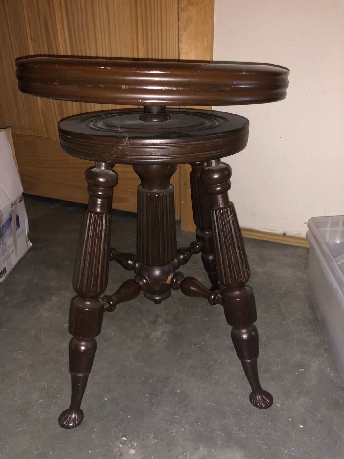

Hello,
I was cleaning out my mom’s house and grabbed this piano stool.  Nothing special but it has been around as longer than I have … and I just turned 60
It has two issues and I am hoping someone can give me advice on how to fix it.

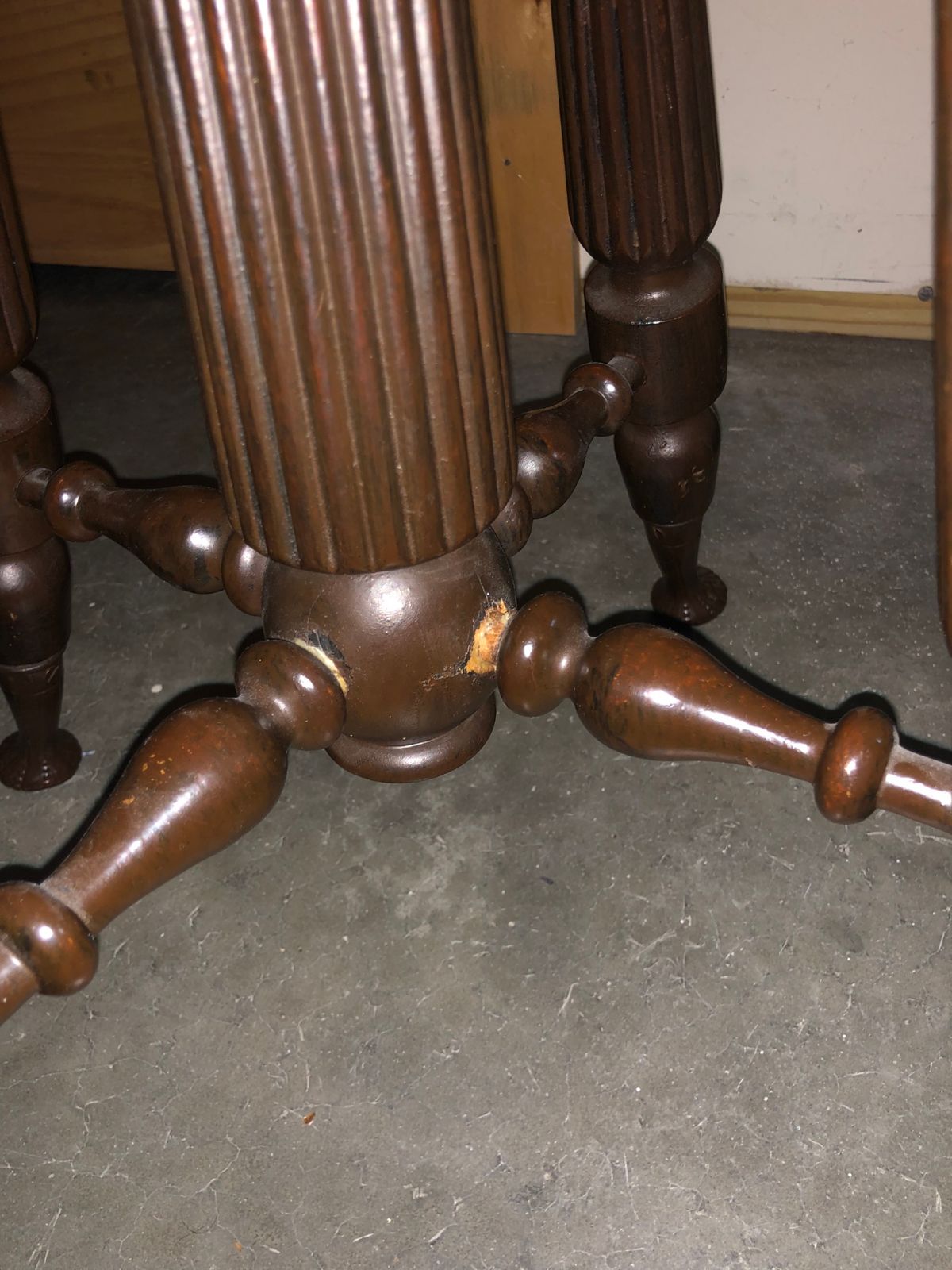

First … the glue in some of joints has dried out and it is coming apart.
So, the easy answer it to just glue the joints that are loose.
My fear is that if I do that, later others may come loose and I will not be able to take it apart.
On the other hand, I am afraid if I try to get it all apart, I will break it.
Is there an easy way to get it apart … or just fix the loose joints?

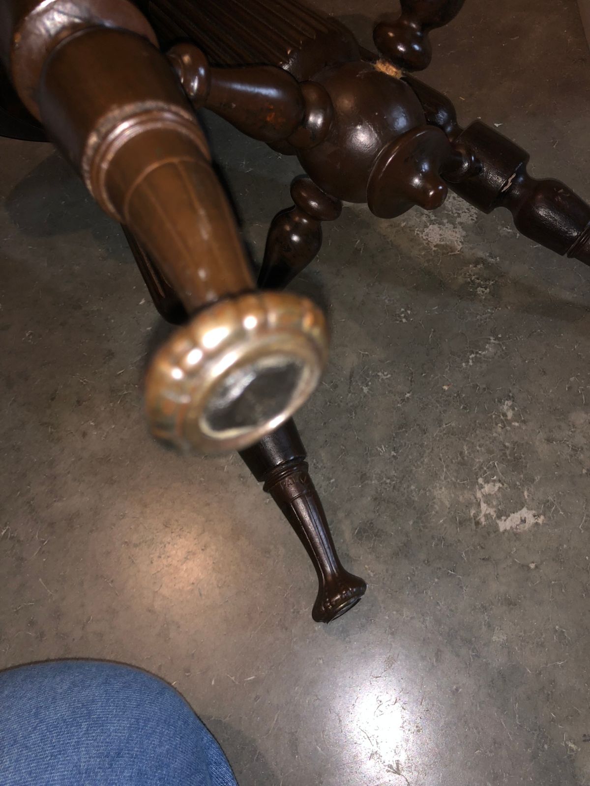

Second, what kind of feet are these?  It looks like a metal ring on the outside and maybe it has a hard rubber piece in the center?
Just have not seen anything like this … want to know to get them off (maybe just pry)?
I am sure there are many feet that will work fine.
Thanks …. Mike
I think those feet are probably the type with a nail like pin and they get driven into the wood. If they are, you can probably gently pry them out.
Depending on the actual age, the glue may be hide glue. I think that type of glue can be gently heated and it will come apart. Care would be needed to avoid damaging the finish.

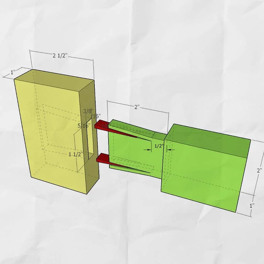

I would disassemble the turned stool brace, perhaps the entire bottom of the stool, and for the round tenons so they never back out again, cut a slot in the end of the round tenon, insert a wedge into the slot, and hammer the brace back into place, the round tenon will expand as it's driven home. This is called Fox Wedging. You'll have to chisel out a little from the round mortise to create a wedge shaped hole, it won't take much at all and it doesn't have to be perfect. I could not find an example of Fox Wedging a round mortise and tenon joint, but here is a picture of mortise and tenon using Fox Wedging, just picture it as round and you'll get the idea.
If you go this route, you may want to mock up a couple round tenon and mortise samples just to get comfy with the process, because once you drive it home, and if you didn't allow enough space to expand as the wedges are driven back into the tenon, and it doesn't mate all the way up, you aint pulling it back out. :)
image source: Paul Sellers
Another example
image source: Bobs Wood Stuff
wedged-blind-tenon.jpg?format=1000w
