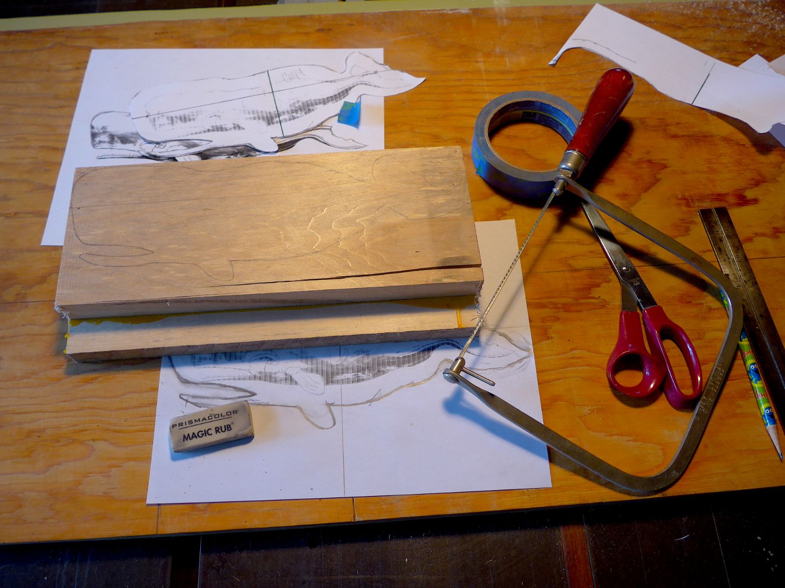

October 2, 20224 yr Popular Post comment_299663 I've now got some downtime and wanted to do something different for my next carving/gilding project. I want to carve this whale, in 3 dimensions, and mounted proud of a rectangular plaque. It should be 12-18" long, with all of the detailed carved into it. Report

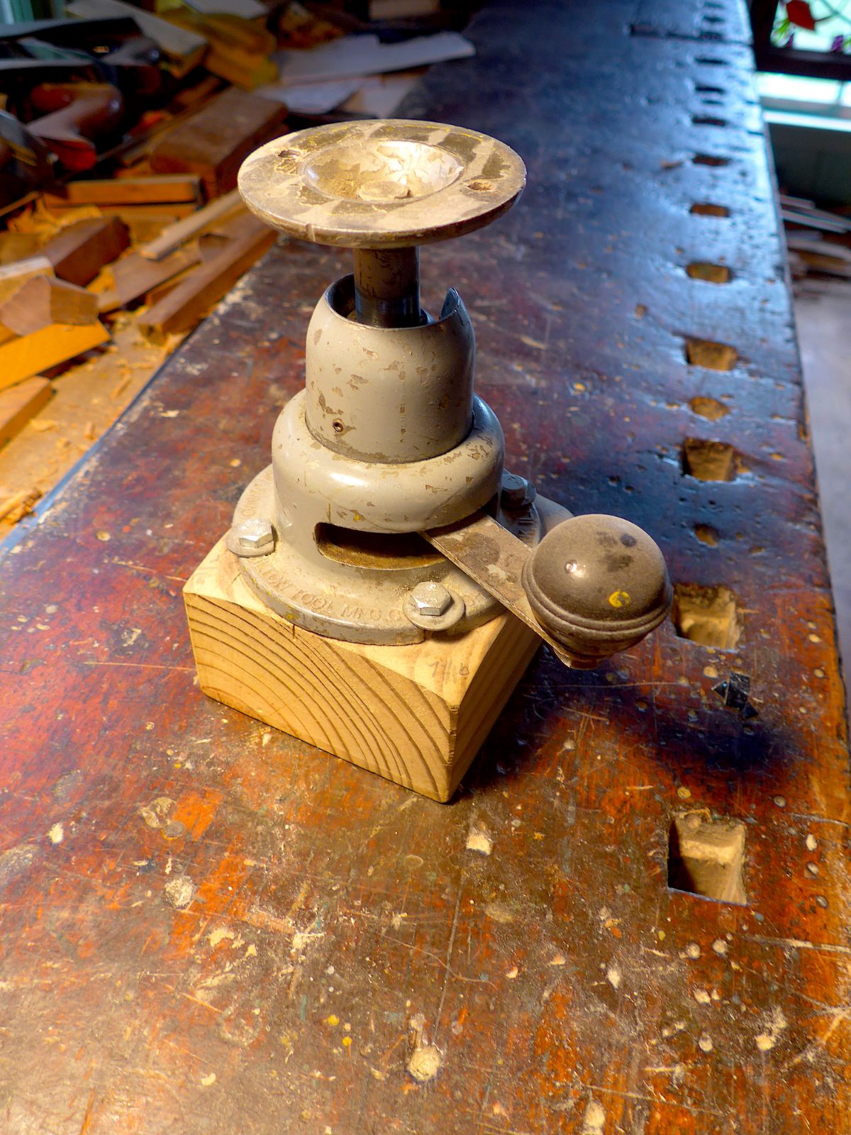

October 5, 20224 yr Author Popular Post comment_299839 The work continues! I've stretched out the length whale, from the photo, to make it look better(?). I've attached a glue block to the front of the carving so that I may carve(using basswood) the backside first(practice?) and will then attach it to my carving arm. The front side will then be done before everything is gilded/painted. It will be mounted proud of the plaque for effect. Report

October 9, 20224 yr Popular Post comment_300068 Yes sir,..straight down my alley . Love the subject matter here. Also love that you cut it out from the get go by hand. So I already have a question or 2. Is that a fret saw or jeweler's saw and does it matter here? Following Report
October 9, 20224 yr Author Popular Post comment_300069 41 minutes ago, aaronc said: Yes sir,..straight down my alley . Love the subject matter here. Also love that you cut it out from the get go by hand. So I already have a question or 2. Is that a fret saw or jeweler's saw and does it matter here? Following Coping saw with a 12 tooth blade. Not sure that the saw type makes a difference, except for the tooth count. Report

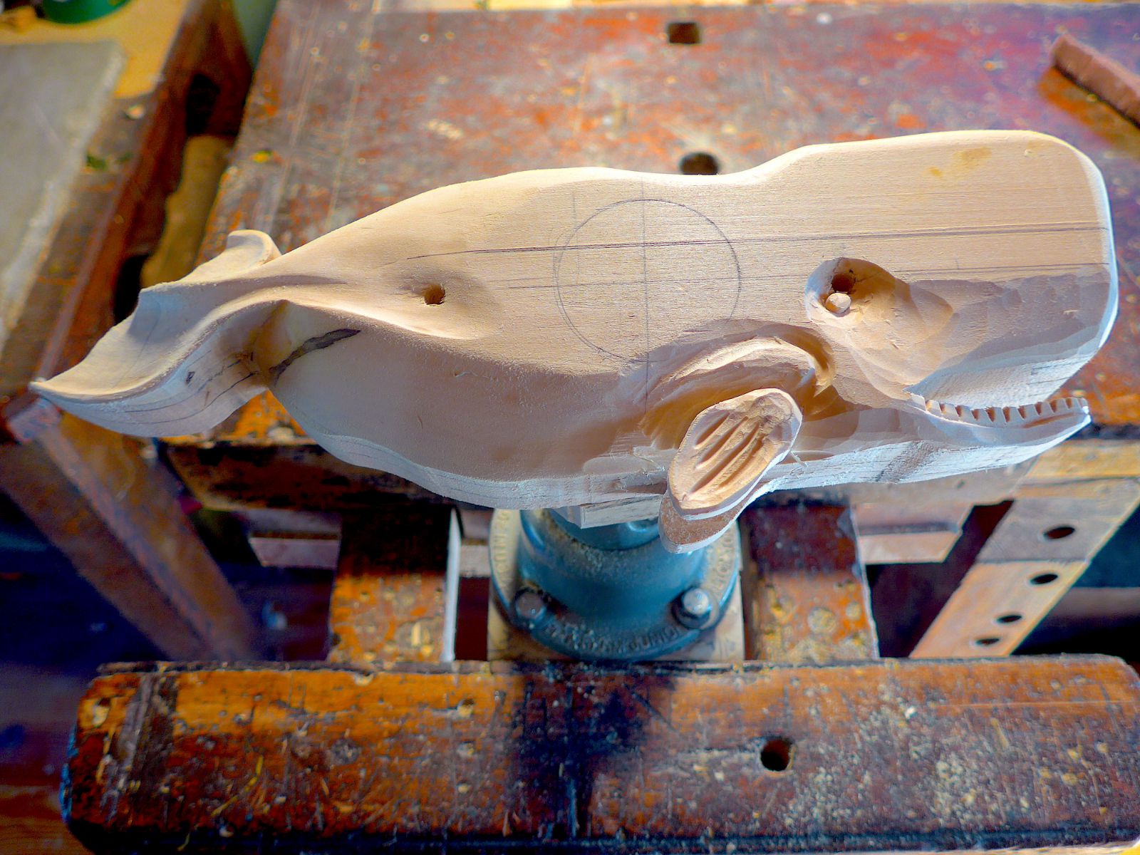

October 10, 20224 yr Author Popular Post comment_300139 Here's where I'm at with the carving. I'm doing the backside first, so that I make my mistakes there and "shouldn't" be seen. You can see the two holes, that were drilled for the two posts, that are going to hold the carving proud of the plaque. I've done some light sanding around the tail area and have to finish-carve the eyes/fin areas. The whale will face to the left on the plaque. Report
October 11, 20224 yr Popular Post comment_300164 Great progress. Excellent detail work thus far on the teeth. Impressive! Report

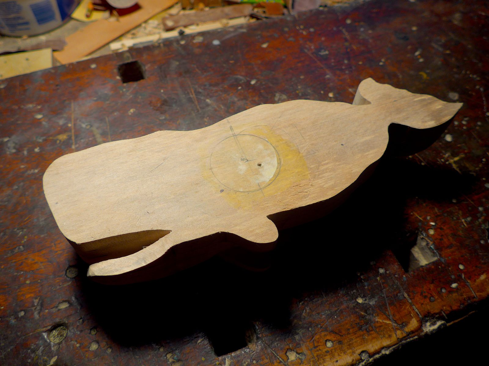

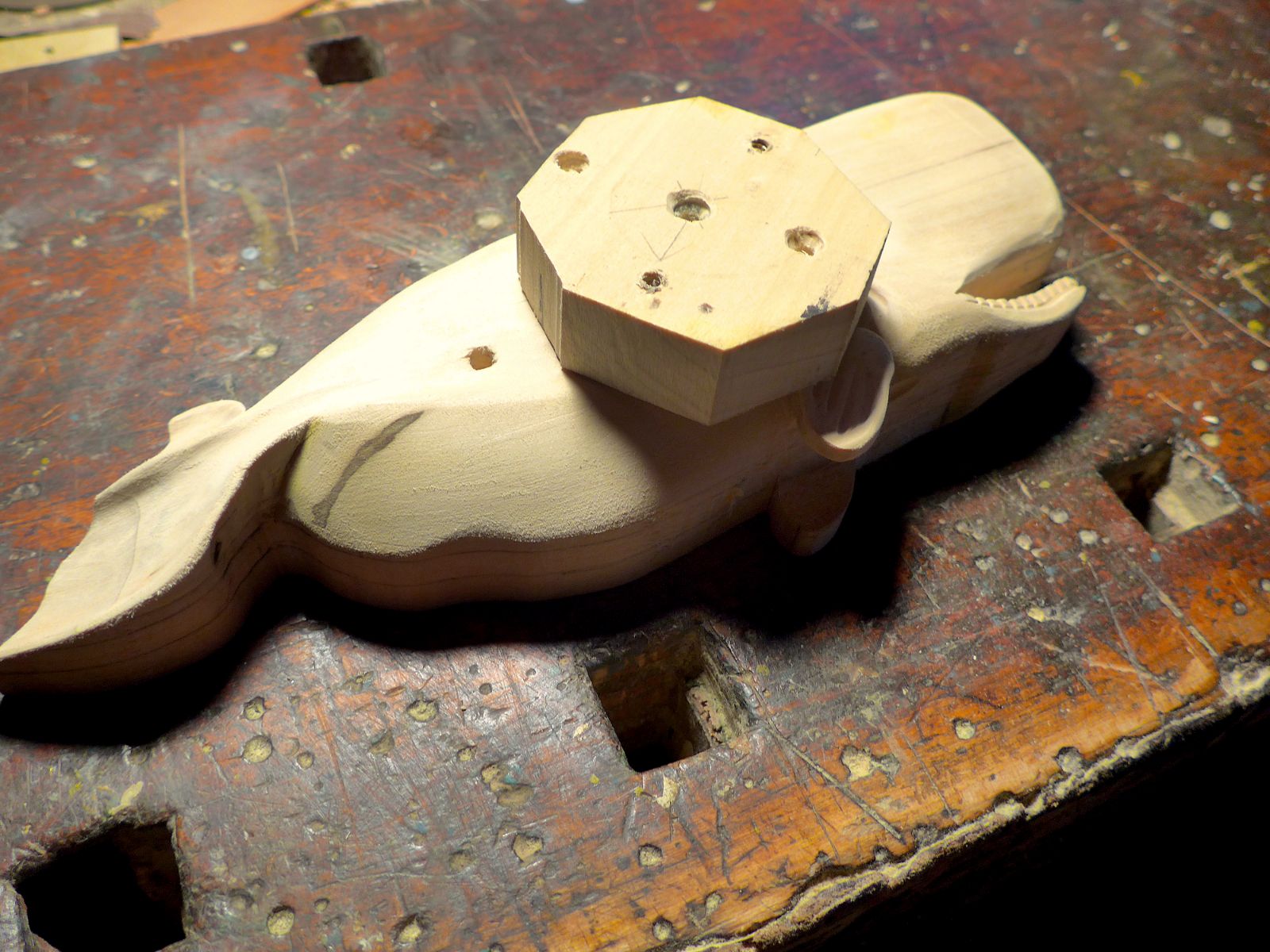

October 13, 20224 yr Author Popular Post comment_300333 Carving finished to the back. Glue block added to the back, so that I may work on the front side. Report
October 13, 20224 yr comment_300336 Coming along nicely Frederick. You have a great vision for the details. Report
