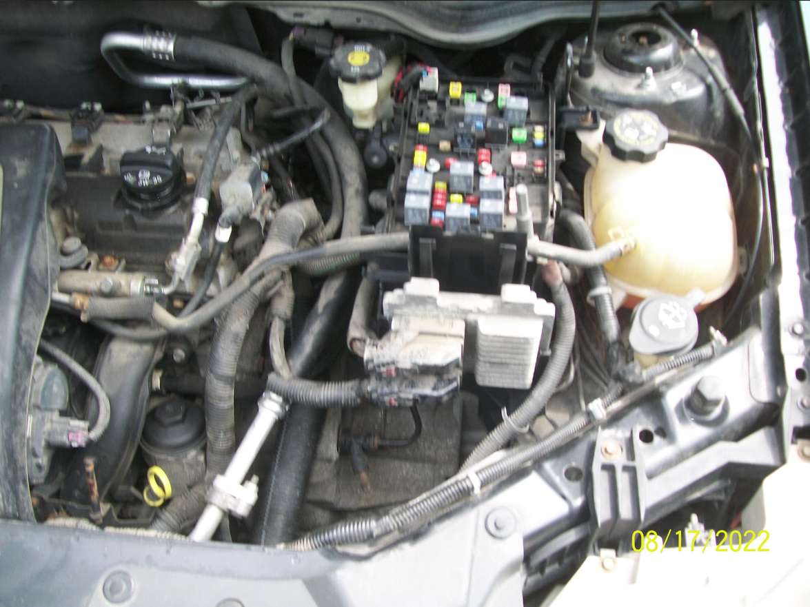

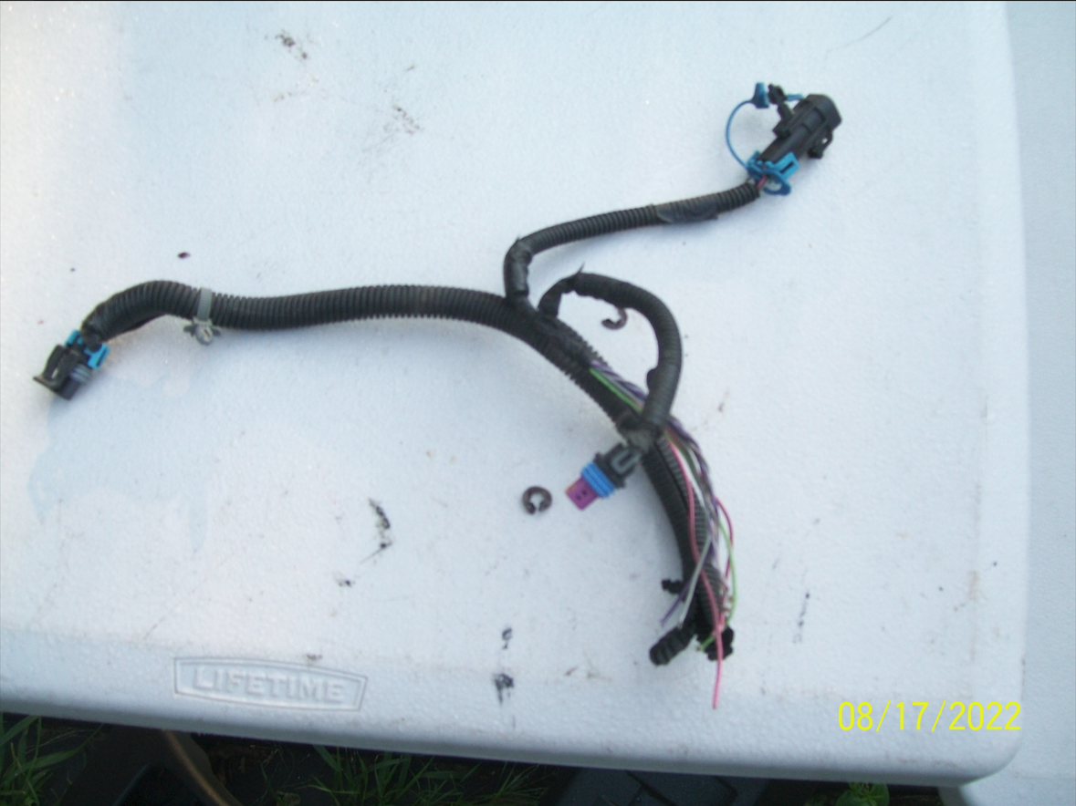

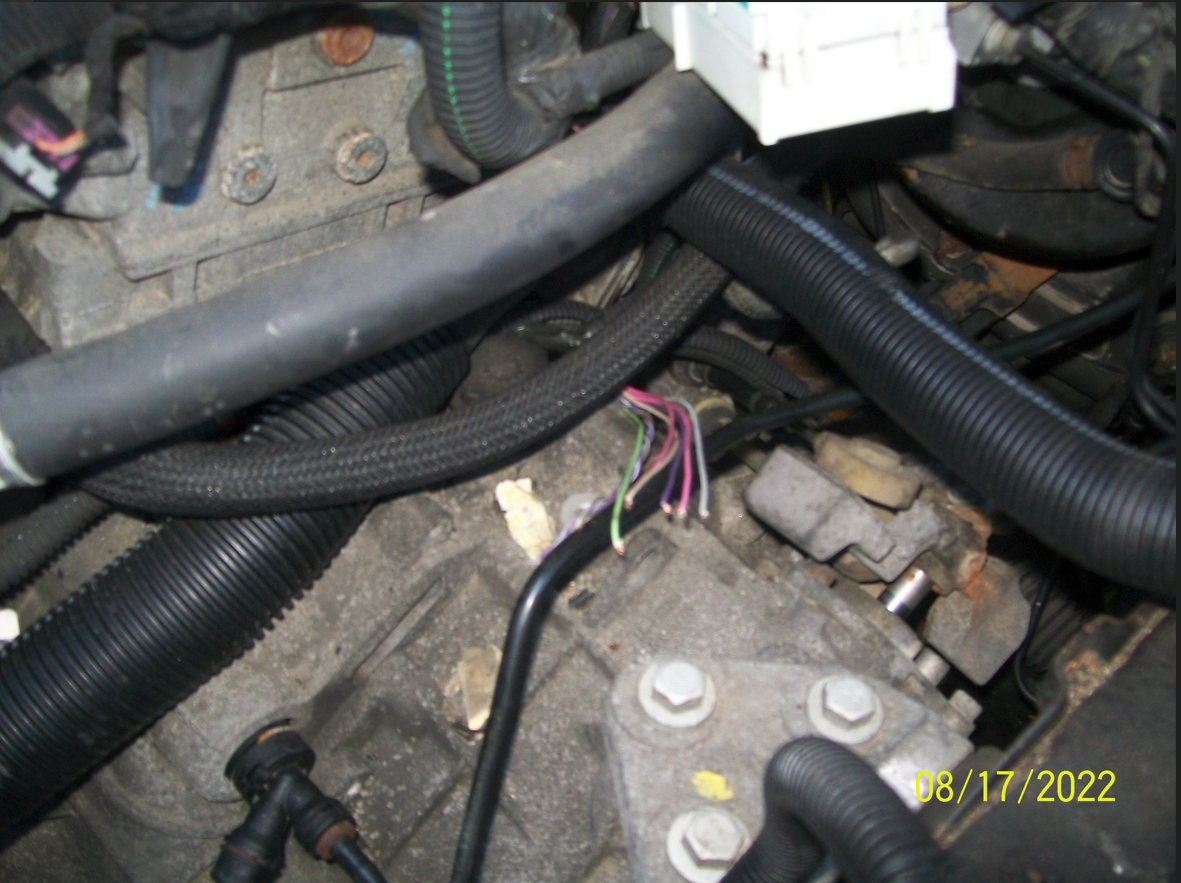

August 17, 20224 yr comment_296852 Stepson called night before last. Having problems with his 2008 Chevy Cobalt. Power Steering warning, and Check Engine Light on, and Speedometer not working. Went over yesterday with the code reader, cleared codes, test drove, both came back before we got around the block, and the Speedometer still not working. So started looking/feeling around and found the eight wire harness that goes down to the Power Steering Motor (Yes Motor electronic assist power steering), Vehicle Speed Sensor, and what I think is the Reverse Light Switch had somehow got caught in the shift cables and cut clean off except for one wire. At first thought it might have been rodent damage so had him drive it out to the house. Was reaching over/behind motor/trans when found. Had to remove the Fuse/Relay box to gain better view/access, and found the harnesss had been routed under the shift cables instead of over. Of course Chevy just had to use two Pink/Black Stripe wires in this harness, and of course they go to two different locations. Hopefully I can match up the cuts on those two wires, otherwise I'll need to find a schematic. Stepson said he had replaced an 02 sensor, so I'm now wondering if when done the harness might have accidently got pulled into the shift cables. I'll be routing them over the shift cables after they're repaired. Report

August 18, 20224 yr comment_296919 10 hours ago, Gunny said: I have access to Alldata and Identifix. Can send you diagrams as needed. Thanks for the offer Gunny, but I got lucky and managed to match up the cleanest cut of the pink/black striped wires. All systems go! Report
