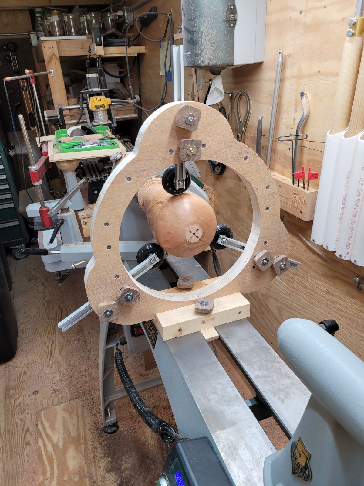

June 14, 20224 yr Popular Post comment_292708 I got my steady rest done. Just waiting on the wheels. Report
June 15, 20224 yr comment_292712 Man, that’s nice! One thought, maybe recess the T-track into the frame for more support what type of wheels will you use? Report

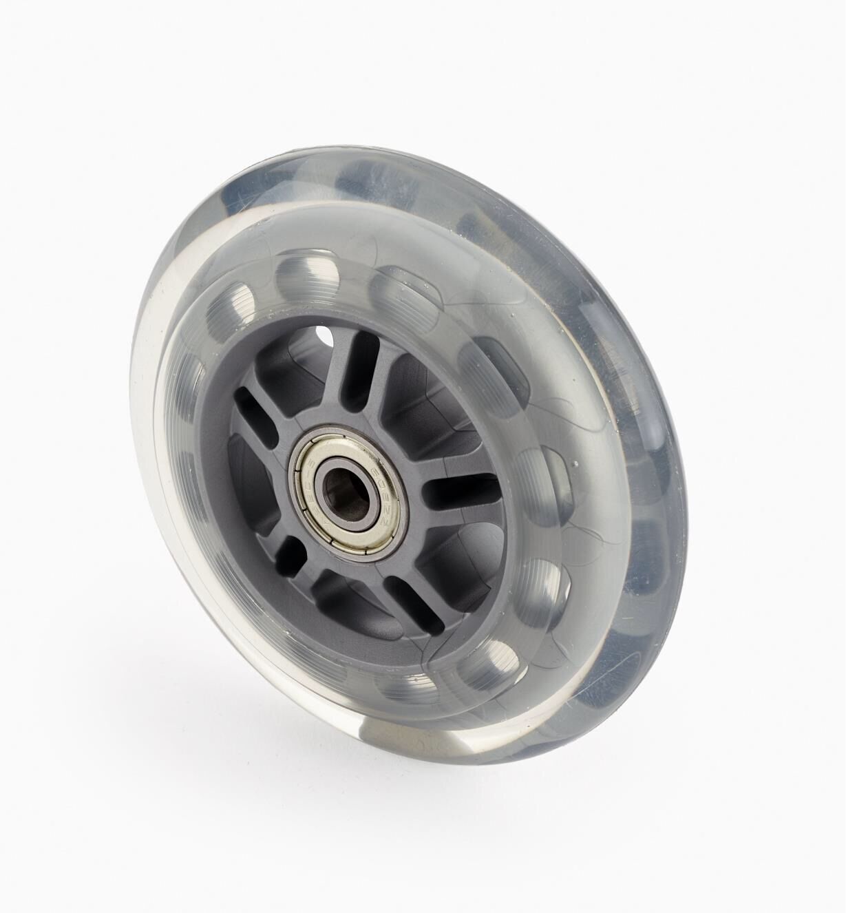

June 15, 20224 yr Author comment_292719 Lee Valley has some wheels for around $5 each. Polyurethane wheels. Report
June 15, 20224 yr Author comment_292721 The track as it is with the two hold down screws can’t be moved by hand. I figured if I had a problem I would add something to the sides. I am also planning on getting some knobs instead of the wing nuts, they didn’t have any local. Report
June 15, 20224 yr comment_292725 Keep an eye on it. The aluminum track may not be rigid enough and give a vibration. Report
June 15, 20224 yr Author comment_292742 8 hours ago, HandyDan said: Keep an eye on it. The aluminum track may not be rigid enough and give a vibration. Will do. When the wheels are on they won’t have to be extended very far which should make them more sturdy in my thinking. It was cheap and I thought I would give it a try. The way it sits in the picture I can’t twist, bend or shake the track using pretty good force. Why I went with the track was in my thinking I should be able to raise the wheels at least half way past the opening to turn larger pieces. Report
June 15, 20224 yr Author comment_292743 I should be able to raise the center of the wheel to the first support bolt. Report

June 19, 20224 yr comment_292965 You might want to look at used inline skates at the thrift stores. Usually cheap and work well Report
June 19, 20224 yr comment_292966 32 minutes ago, Gerald said: You might want to look at used inline skates at the thrift stores. Usually cheap and work well I tried some of those on my first build. They were hard plastic with a rubber type tire. The rubber part separated and came off. They still worked but the harder plastic left indents on the turning Report
June 19, 20224 yr Author comment_293015 19 hours ago, Gerald said: You might want to look at used inline skates at the thrift stores. Usually cheap and work well I thought about that but am worried there could be grit and rocks in the wheels and damage what I am working on. Report
June 19, 20224 yr comment_293016 you can wash wheel but don't think they will embed. Just pick the cleanest. Mine were worn down somewhat but still circular. Report
