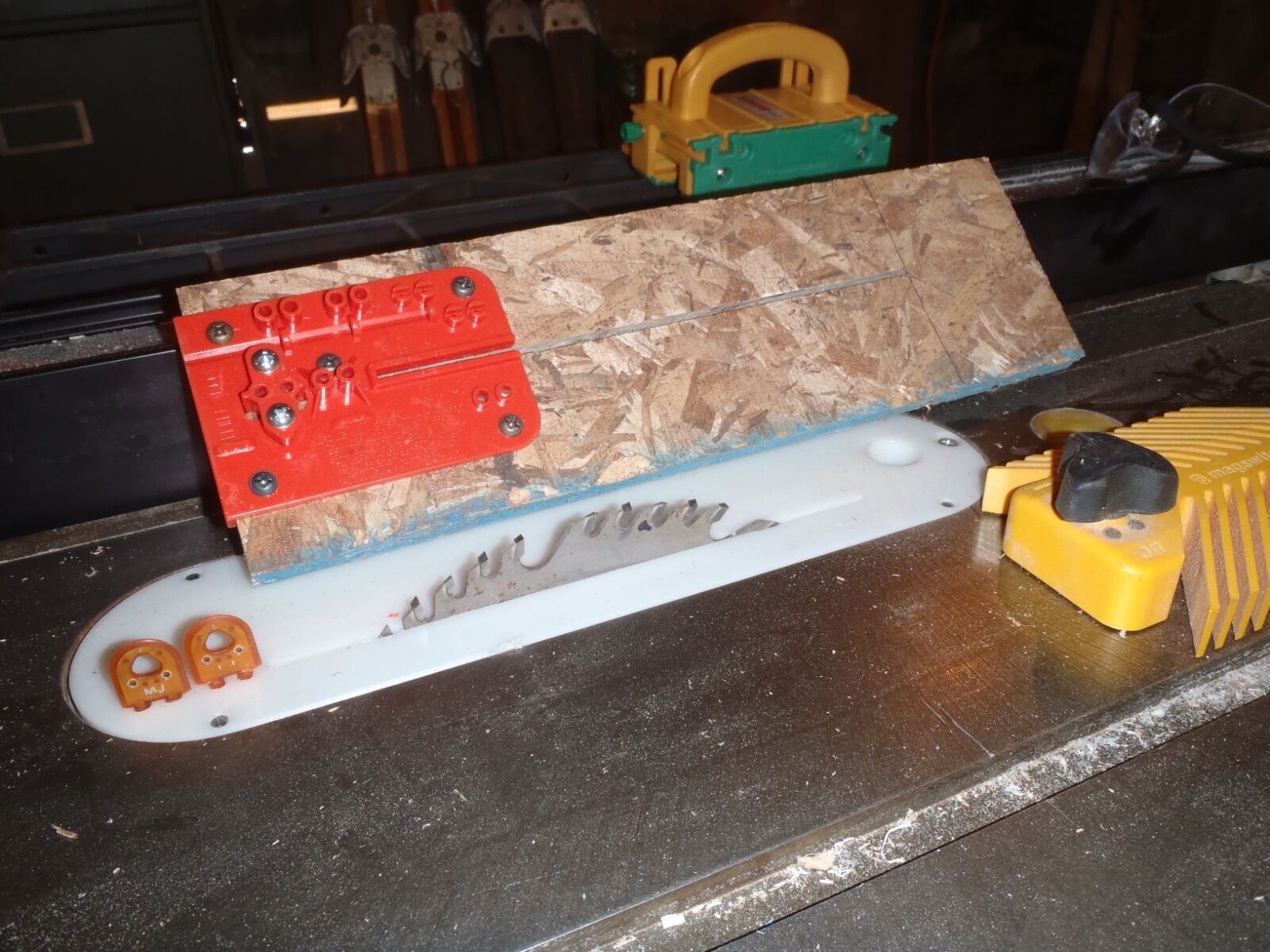

May 12, 20224 yr comment_290600 For ZCI on the miter saw, I use a product from Fascap called...are you ready...Zero ClearanceTape. It's not needed for the table saws as, like Lew, my inserts are purpose cut for angles and differing dado blade sizes. But, it would work on a buggered up TS insert. Report

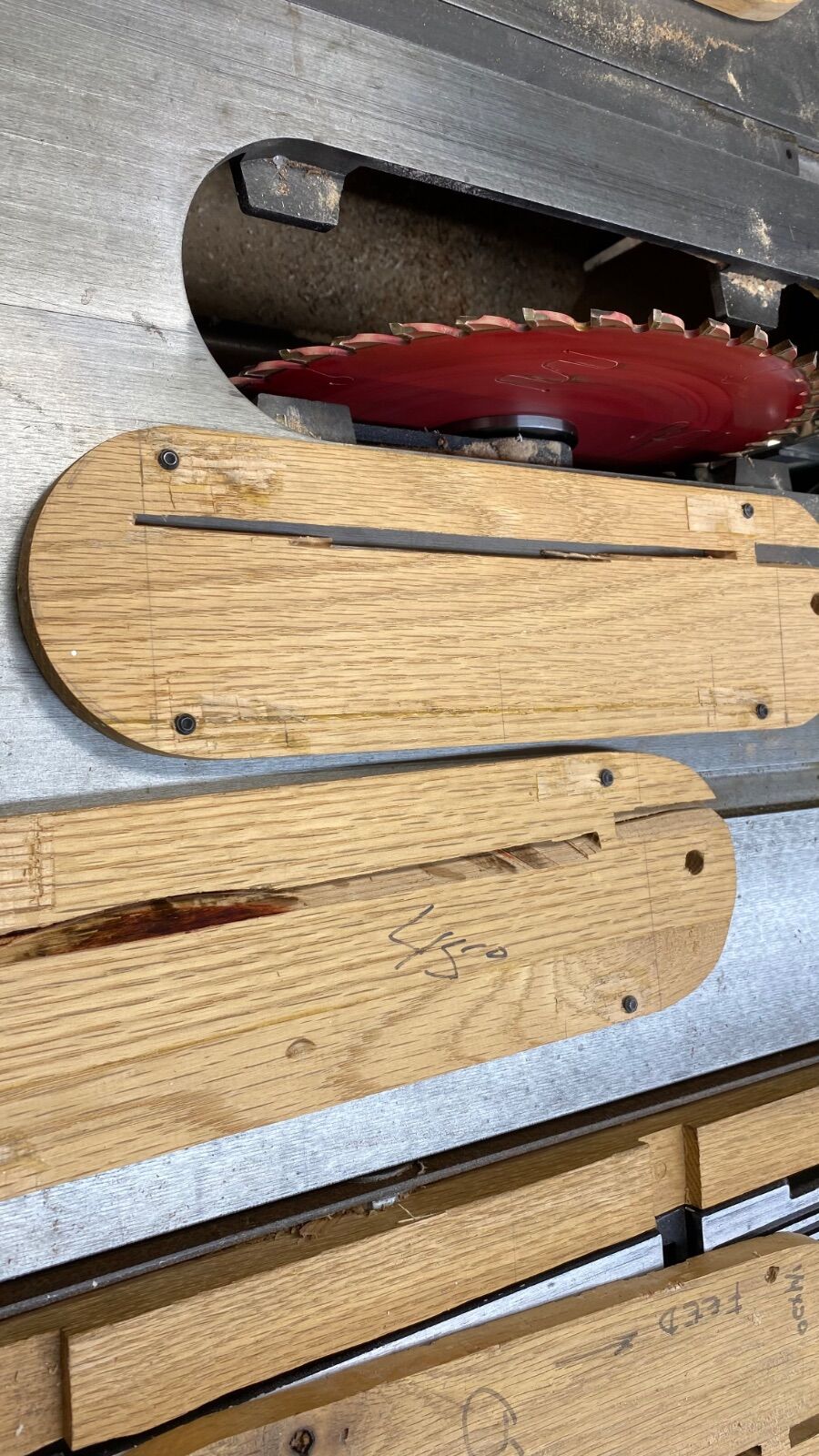

May 12, 20224 yr comment_290602 18 hours ago, lew said: I use a wixey angle cube and set the blade angle. Lower the blade as far as it will go. Set in the uncut insert. Slowly raise the blade. I have some lead weights I set on the insert while raising the blade to keep it in place. Thanks Lew. I must admit to being a bit slow on the uptake this morning (coffee coming...). I can see the zero clearance on the "uphill" side of your blade, but it's not zero on the other side is it? I see that @Gene Howe also makes zero clearance at an angle, how about a pic from one of you fine gents? Edited May 12, 20224 yr by Cal Report
May 12, 20224 yr comment_290611 1 hour ago, Cal said: Thanks Lew. I must admit to being a bit slow on the uptake this morning (coffee coming...). I can see the zero clearance on the "uphill" side of your blade, but it's not zero on the other side is it? I see that @Gene Howe also makes zero clearance at an angle, how about a pic from one of you fine gents? Shopsmith is presently set up for bandsaw work. Maybe tomorrow for the demo. IDK if it makes a difference but, I tilt the table to make angled cuts. And, the table is raised to clear then, lowered to make the ZC cut. But, it's ZC on both sides of the blade. Report

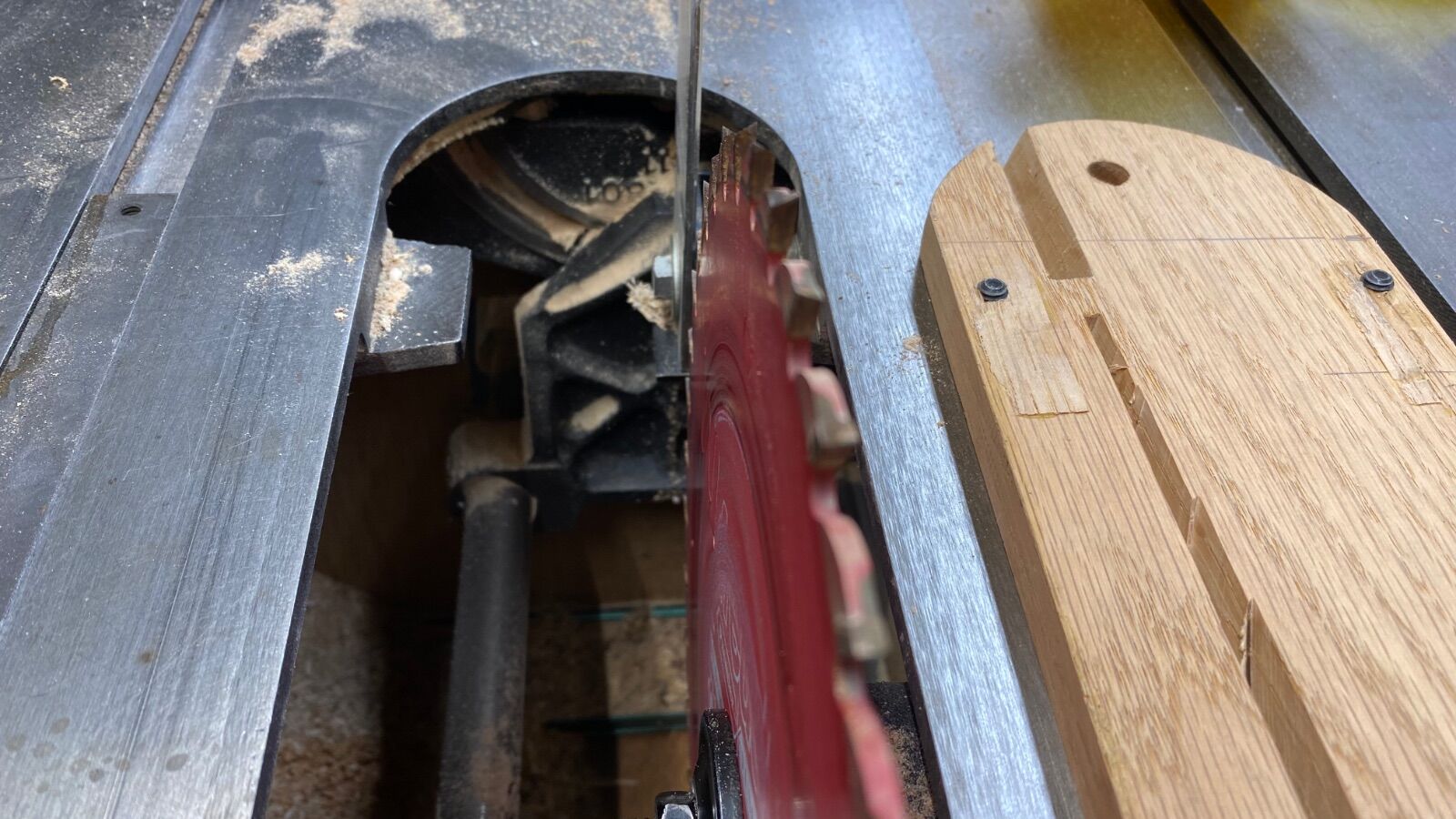

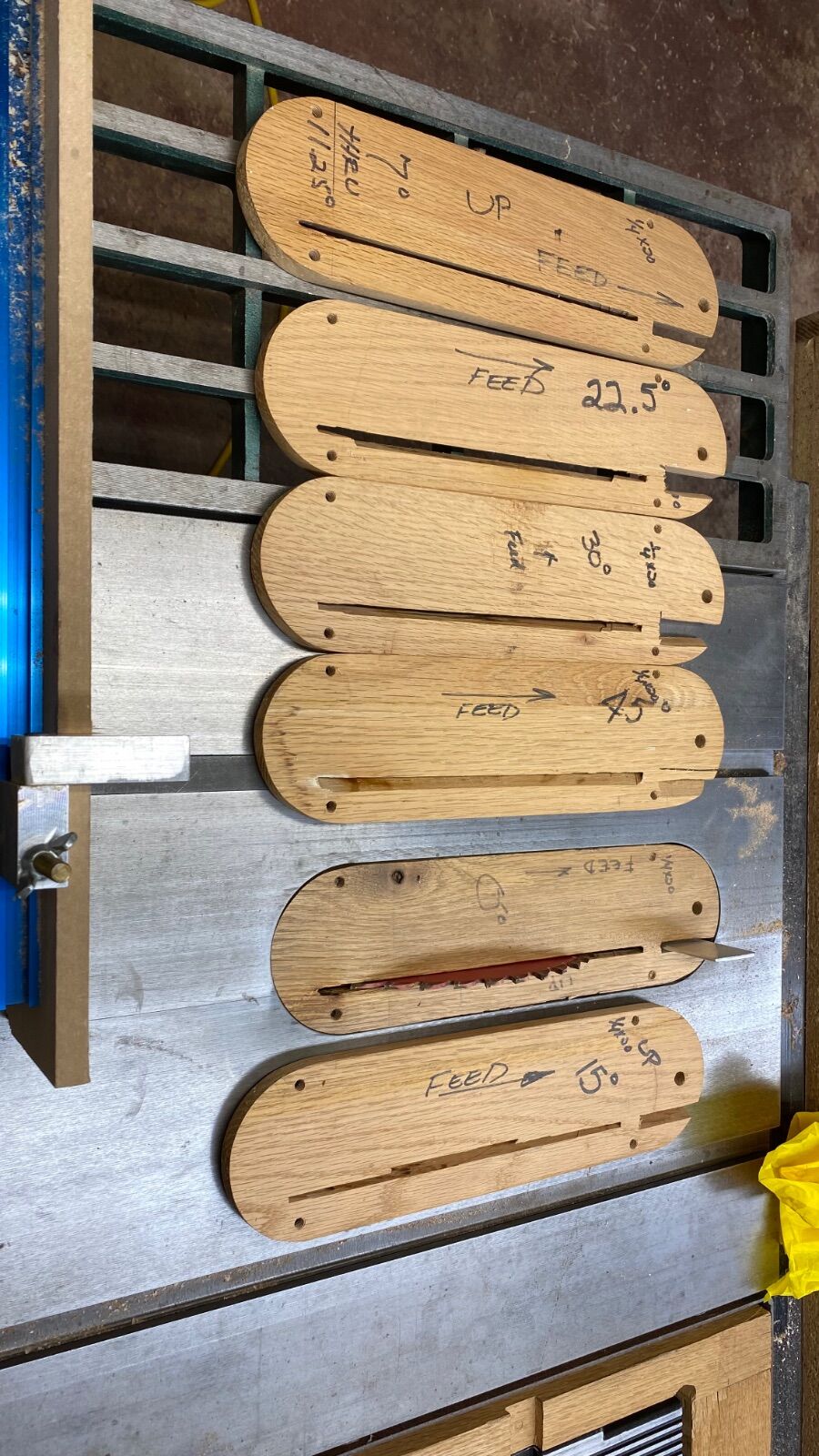

May 12, 20224 yr Popular Post comment_290633 6 hours ago, Cal said: Thanks Lew. I must admit to being a bit slow on the uptake this morning (coffee coming...). I can see the zero clearance on the "uphill" side of your blade, but it's not zero on the other side is it? I see that @Gene Howe also makes zero clearance at an angle, how about a pic from one of you fine gents? My saw is a contractor type with the the blade tilt on a trunnion mechanism. The blade moves up and down perpendicular to the trunnion angle bottoms hope this helps Report

May 13, 20224 yr comment_290677 18 hours ago, lew said: My saw is a contractor type with the the blade tilt on a trunnion mechanism. The blade moves up and down perpendicular to the trunnion angle Thanks for posting those pics Lew. I will have to look at my saw (a Jet model) to see if I can do this. Report
