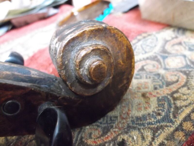

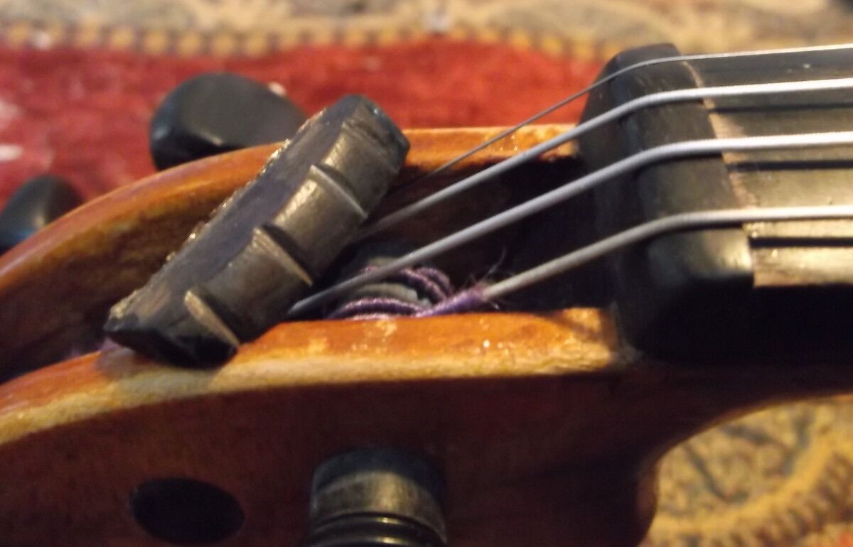

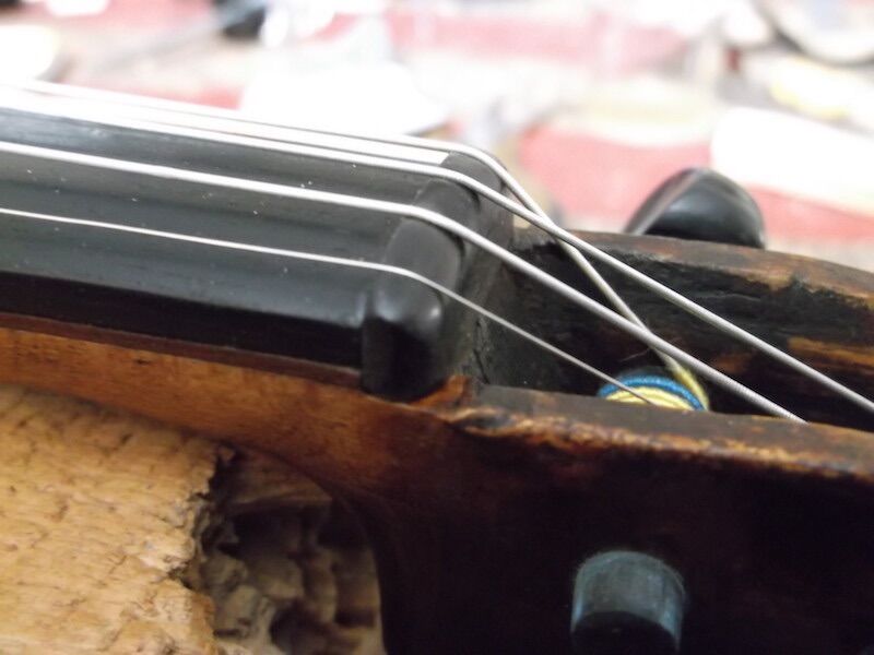

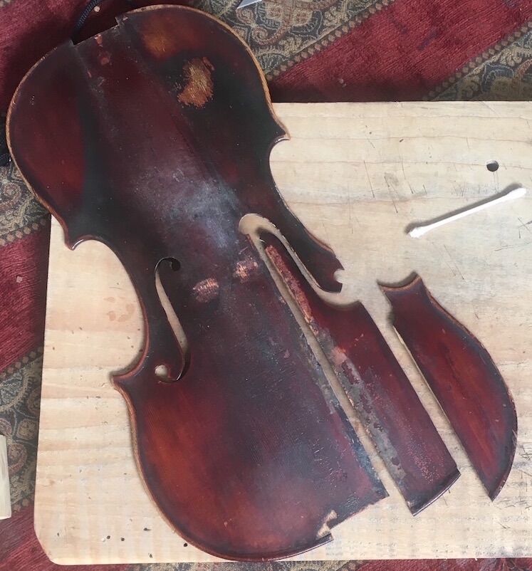

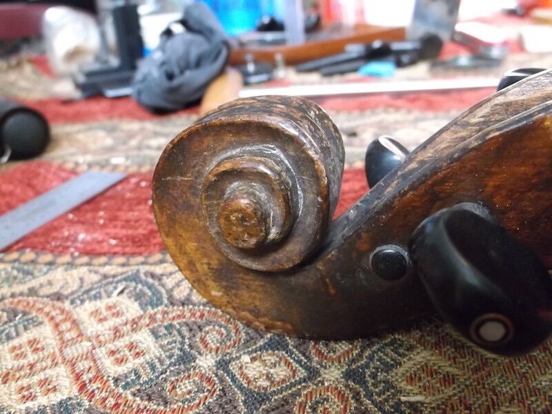

March 23, 20224 yr Popular Post comment_286708 As promised within the Use of an Angle & Taper Calculator in everyday woodworking thread, here's the amateur hobbyist play-by-play of restoring an old violin. This old fiddle came to me in its original or so coffin case and promptly fell apart as soon as I removed the chin rest. The first 20-some images chronicle its condition with attention to tool marks. August 14-15, 2018 Gut strings! Keystone-shaped dovetail-cut pegbox repair, likely c.1880s. Wow, lookie that patina! This violin is not a Kloz, not remotely built as a Kloz, certainly sounded nothing like a Kloz, I've reliably been told. Likely an authentic repair marking, this work failed, maybe around 1920; the glue I removed was oddly sticky with a sharp astringent odor. All of these images are used to date and identify the fiddle. It is thought to be mid-1800s, a build of the French Mirecourt region. Cannot fake this crackled spirit varnish with embedded dirt / rosin. August 23, 2018 Spent some time cleaning up the top, meaning glue edges and whatnot. Then reassembled the ribs to the back. Cleats ("jacks" to the Brits) being glued. I shave them flat and scribble a few notes on them which get sanded off. September 11, 2018 By mid-September 2018, a new end block is successfully crafted after eleven tries. Working backward, I glue the block to the heel neck. Most or all violin neck heels are cut squarely, a big tenon, the end block is a big mortise. This joint is dovetailed, so I keep it as-is - cleaned it up and sharpened the edges. Officially my first "neck reset". Wowwie, look at that neck angle! What about the projected height of the strings !?!?! The violin is back together about five weeks after I received it, strung up with used $80 strings. The old end block on display. A new bridge is on the violin. It is 40mm high, a good centimeter higher than specification. Way too high for a practiced violinist, but bringing the fiddle to a bluegrass circle, I note the higher string angle does produce a great tone. Even, dare I say, a fantastic tone. Mo' downward pressure. But it is not sellable at 40mm. 29.5mm - 31.0mm is the range. My projected height is all off. Image sequence was thrown off, but the top is removed, the end block pried off, and the neck reset. My second official neck reset. Thank the saints I am using my own hide glue through all of this. In this image, which I *think* is in correct sequence, one may see a slight difference in neck angle. Hard to tell, but I was off by a little under 2˚ And she's back together a second time. New pegs in newly-contoured peg holes of the modern** 1:30 taper. New fingerboard and nut all pictured here. ** modern since the early 1900s, replacing 1:20 taper or whatever was traditionally used in the shop. New strings this time. $40 D'Addario Helicores. The pegbox repair was undone, cleaned up, and reglued using the same piece of wood. I *may* have used Titebond on this one joint, as it represented something I never ever wanted to come undone again. All the other joints are hide glue; in theory, a violin may be taken apart and repaired indefinitely. Hope you enjoyed the tour. - jim Report

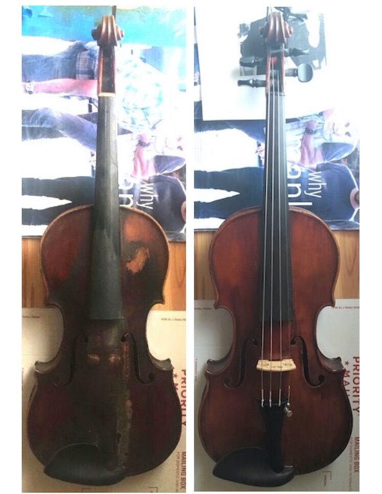

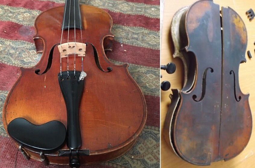

March 23, 20224 yr Author Popular Post comment_286735 45 minutes ago, Grandpadave52 said: artistry, patience Thanks, Doc! Believe me, I did not have that patience until just a few years ago. It's also called, "Slowing down both physically and mentally". Here's a composite. Nothing but naphtha used for cleaning, I believe. Practically no spirit varnish touchup to the top, but I would have done the edges of the lip where they meet the ribs. Once the dirt is removed, or most of it at least, the top would have been polished with a buffers polish which smells like bowling alleys. Behlen Buffer's Polish is an extremely fine buffing agent. Buffer's Polish buffs out minor imperfections in a cured finish. Report
March 23, 20224 yr comment_286736 1 minute ago, Dovetail said: Nothing but naphtha used for cleaning, Not sure how safe it might be for thin wood/veneered instruments but I've had great success using Hydrogen Peroxide to clean old furniture, wood planes, wood handles on tools and the like. No chance of affecting the finish or usually old glue joints. I'll look into the Behlens Buffer Polish though. Report
March 23, 20224 yr Author Popular Post comment_286737 18 minutes ago, Grandpadave52 said: Hydrogen Peroxide On spirit varnish, lighter fluid / naphtha is good. Removes the grime, inert to the finish. You can puddle it on a suspected top fracture and it'll weep through the tightest crack, let you view the crack w/ light and mirror. Then evaps, no harm, no foul. Does not affect the tone. Restorers would only use a mildly-soapy solution on Q-Tips to restore the top of a $200,000 violin - when the customer is watching. Then give it a quick wipe with naphtha after closing. Many "normal" cleaning agents flow over rosin-embedded dirt without effect. The rosin is tree resin. Rosin becomes dust, sticks, gets dirty, hardens harder than a clam shell. Acetone will melt plastics, and like xylene, is too strong for spirit varnishes. Denatured alcohol and drinking booze will melt and remove spirit varnish, a no-no. Isopropyl alcohol does nothing; just wipes off like water. As far as buffing agents, there is the Behlen's, and I've also used rottenstone in a rubbing oil. Then hand buffed with a soft cloth. For hours, while watching a movie. Report

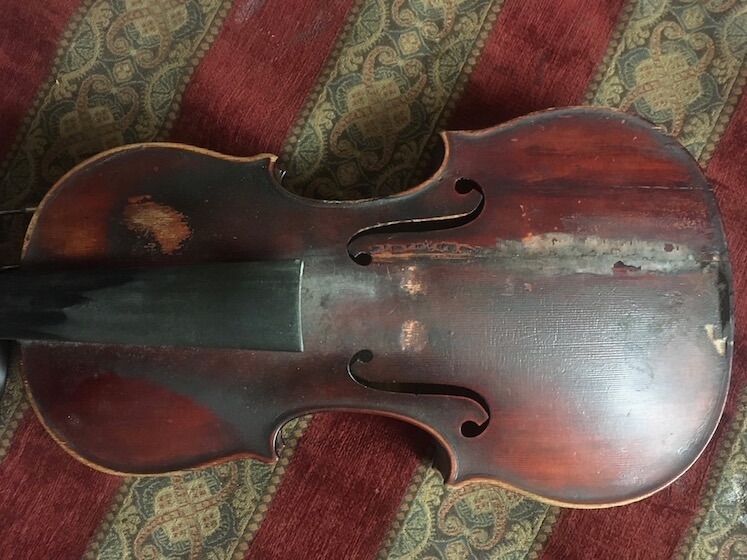

March 23, 20224 yr Author Popular Post comment_286739 29 minutes ago, Grandpadave52 said: Finish/ refinish is not a strong suit for me. Me neither! And what makes it worse, you CANNOT sand an old fiddle top to wood and refinish it. Changes the tone, you lose provenance, value plummets. Here's a 1914 'mystery fiddle'. I've got multiple progress images but the short of it is that there was so much damage, my options were limited. That is some type of contact cement speared across a gapping top crack. This fiddle was played hard, put away wet! Report
