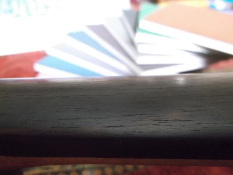

April 2, 20224 yr Author comment_287438 I really do not want to beat this to death, but I'll add a few more thoughts for @wotmug If the finish is gummy, something GGF used has evidently broken down for whatever reason. Sometimes people use whatever they want to use and it is fine for 20-40 years but eventually comes apart chemically. I know a fairly experienced luthier and shoe'er of horses who wiped the ebony headstock overlay on a $10,000 guitar with oil-based whatever. Right over top of the factory nitrocellulose. When I got the guitar maybe 20 years after he did that, and cleaned it up to replace some missing binding and level the frets, I was a little surprised. It had turned gummy; it does not adhere to nitro; looked like crap as it aged. Some things you just do not do. Typical spirit violin varnishes do not get gummy (I've never heard of a spirit varnish becoming gummy but they do become brittle and flake). I've handled maybe 3-4 dozen decent fiddles, including significant work to several definitely confirmed as 1890-1905. You can lock that violin into the radio cabinet, get it out three decades later, tune it up, and play it. Maybe a soft cloth to polish it. The finish is hard, smooth, getting a nice patina, maybe with a layer of dirt-embedded rosin, but the patina is rock hard. To clean spirit varnish one uses a damp cloth, very mild soap, then a soft buff, and lots of elbow grease. Simple Green, well diluted, is approved. With experience, you can step up your agent. Naphtha is what I use, sometimes only a few drops on my buff, sometimes literally soaked. A buffing agent to remove residue. I've also used NOVUS 2 Fine Scratch Remover on cured spirit varnish finishes; it is expensive but is great at removing blemishes. I've also simply used Micromesh buffing pads to 12,000 grit, then a liquid buffing agent. A linseed oil-based varnish, on the other hand, that would account for the problems. These days one would use the more stable BLO, but I've heard of raw oils breaking down. GGF may have mixed his own varnish or acquired a supply from another luthier; the varnish could have been applied too thickly and began to break down before it was cured. Maybe removing the varnish is the right answer *in this case*. No one should be advising you on how to remove finish without personally examining the instrument. For all we know, it could be a $20,000 violin. Even if it is worth $800, or only $200, this is not the kind of advice you should get without inspection, or lacking that, without slowly testing the instrument at inconspicuous areas. That disclaimer firmly out there, it is a firm NO to using alcohol on violin spirit varnish for cleaning. Just like you would not use paint thinner on an heirloom violin's oil varnish for cleaning (unless you really knew what you were doing). BUT if you want to remove the finish, the varnish, you'd figure out the base, then use that solvent. You'll end up with a flat finish, no sheen. The color will still be there, but lighter, sort of flat chalky looking. It's a good look IMHO. The idea is that the very light wood vibrates. Thick finishes inhibit the tone from coming forth. So when you go to refinish the violin, you'd use something very light and thin. Stock violin spirit varnish, you'd dilute liberally. You'd practice first. It begins drying within seconds of application; the alcohol evaporates immediately; definitely a learning circle to spirit varnishes. You do not brush over areas to "straighten them out" but you can remove the varnish and start over. Thirty minutes is usually long enough for a thin spirit varnish to cure enough for recoating. Doc sort of threw me out here like an expert, but I'm not. I'm a guy who was handed an $1,800 violin to fix when the local shop quoted $3,000. I did it for $400, and more work came in. I did a lot of trial and error, and took months to do a ten hour job. My advice is to proceed cautiously. Report

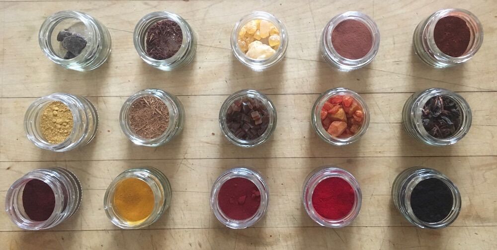

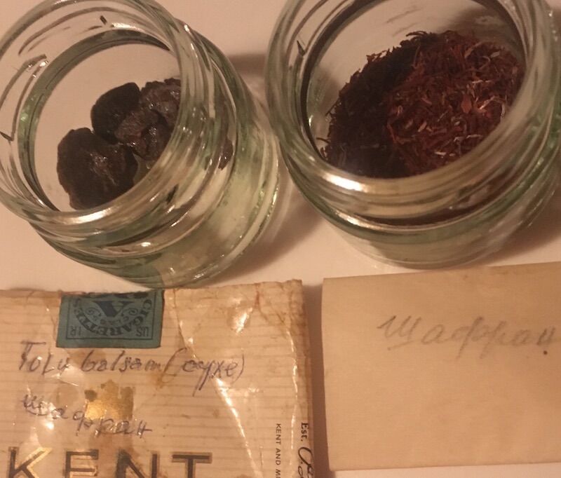

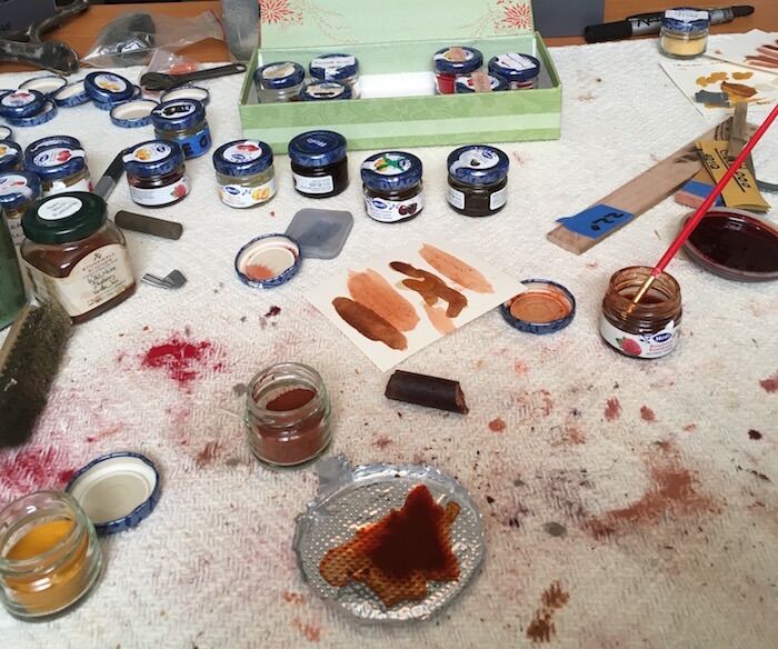

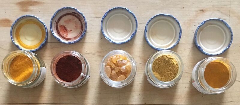

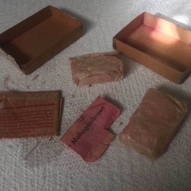

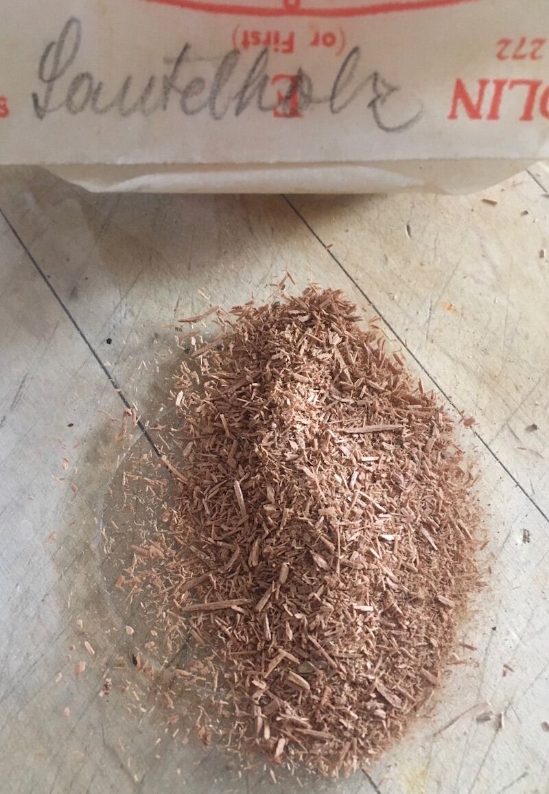

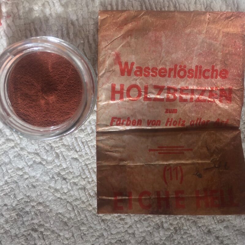

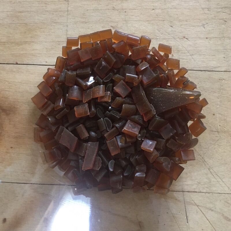

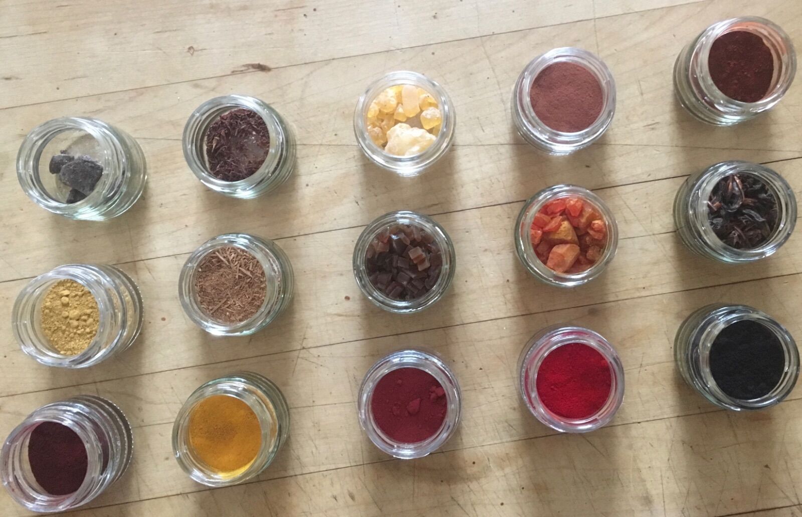

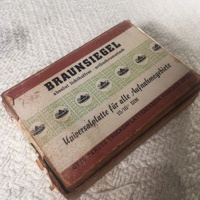

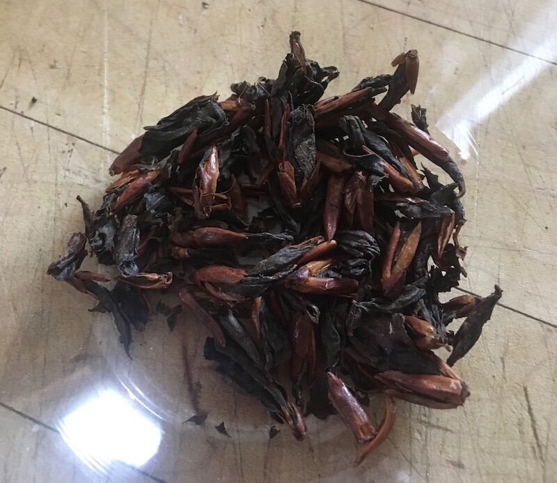

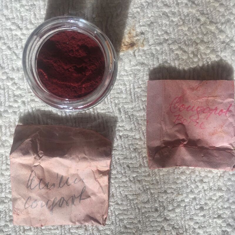

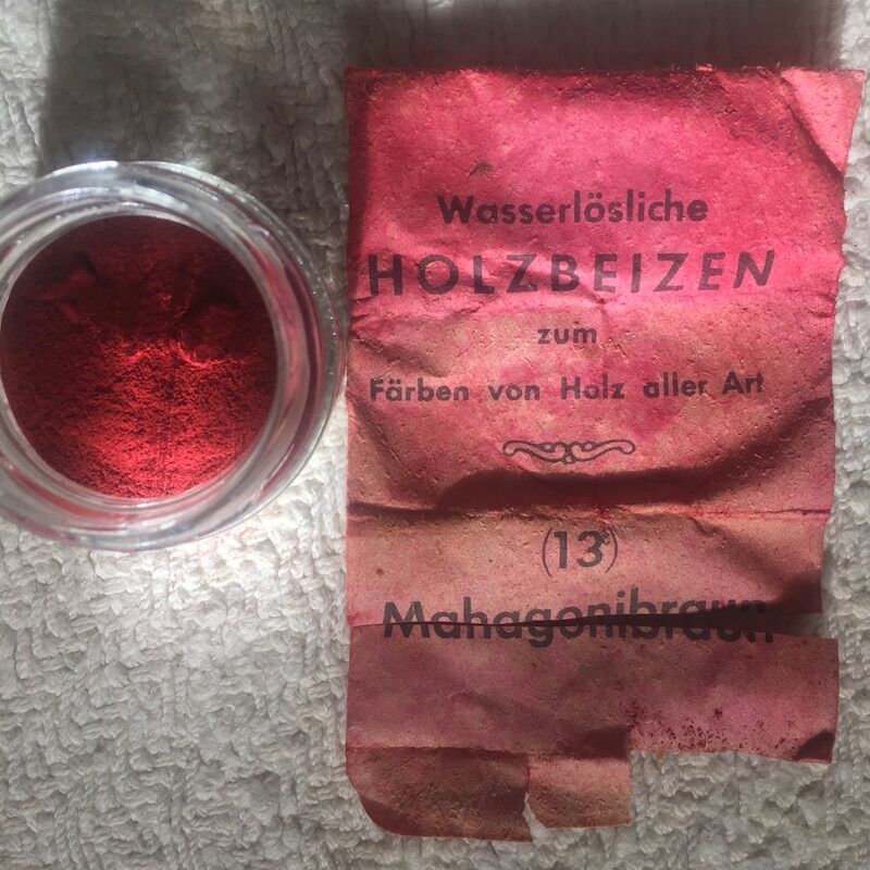

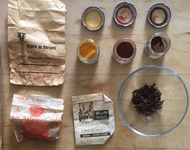

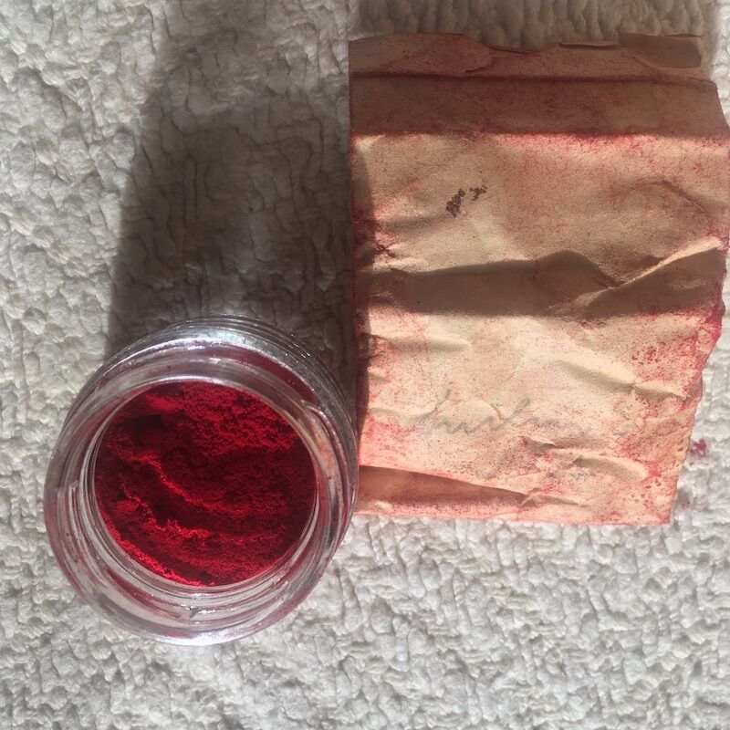

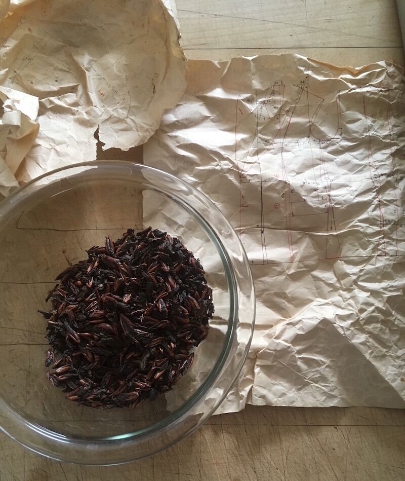

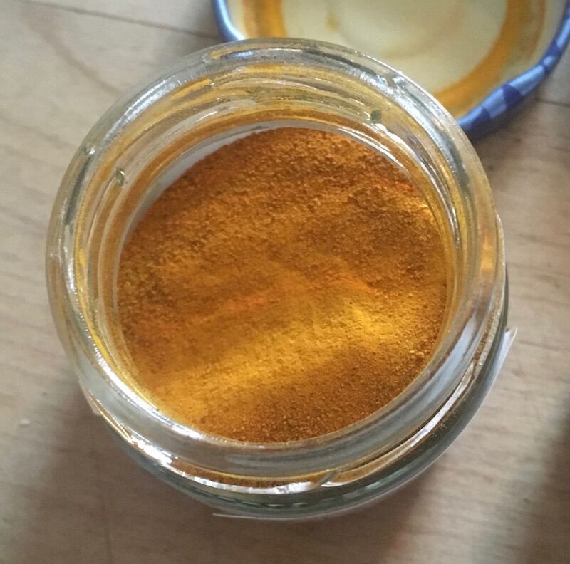

April 2, 20224 yr Author comment_287489 15 minutes ago, Gene Howe said: finishes It goes on and on and on ... Doing a cello refurbishment, I wanted a bit of red pigment. Went to a "known" luthier. This prosperous white-glove domestically-trained luthier gave me a shoe box of pigments c.1880-1940; he said it was in the shop when he took over. (A few years later a 6th generation European-trained luthier told me he has over half a dozen of such boxes, gifted from widows of luthiers.) Even with all of these choices, I could not get the colors right, eventually shelving the cello to focus on several weeks of pigments and finishes. Truth be told, I still do not have it right. Maybe after 4 years European study plus a decade apprenticeship with a big house, I might be considered minimally competent. Report
April 2, 20224 yr comment_287497 Well along side me you certainly are. Just like any craft it's a life long journey not a sprint to the finish line. You already "learned" me lots of good stuff. Trick is recalling it when needed. All those jars with their contents have a strong resemblance to the baby food we once fed Report
