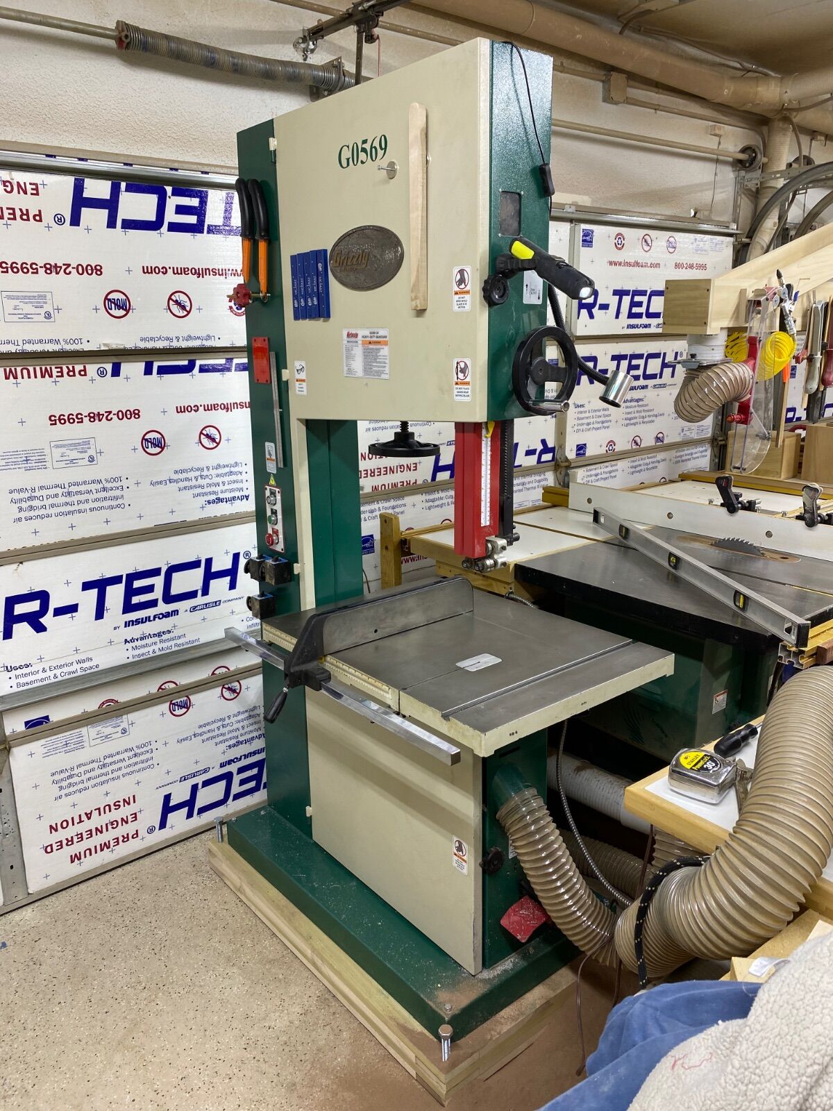

March 7, 20224 yr Popular Post comment_285548 Now that the road trip is over I’m moving the band saw over here. This was kind of a spur of the moment thing. Everything just sort of fell into place. My good friend made me an offer on my 17” bandsaw and at that moment I found a 24” Grizzly bandsaw on CL which is a modernized version of one we had in our shop before. I need the saw because we have a stash of Honduran mahogany in storage that is in very large chunks and now I can resaw it down to usable size. This was quite an ordeal getting the saw from about 350 miles away. It weighs in at about 900 lbs so getting it on and off the trailer took some planning. Many thanks to Static LV for coming over to help with the unloading. This saw has a 7.5 hp three phase motor so the next project is getting a 15 hp phase converter. There are several options. There is a used one on CL in LA for 800. We will se if it has the start up power I need. If I can find a reasonable 15hp 3ph motor I will just build one. They are very simple to build. So far the only ones I can find are more than the whole converter for sale in LA. If that one doesn’t have the start up capacity I can always modify it. Paul Report
March 7, 20224 yr Popular Post comment_285551 7 minutes ago, Masonsailor said: Many thanks to Static LV for coming over to help with the unloading. Another fine example of the TPW Desert Chapter. Well done @StaticLV2. Holy moly Paul! That thing wouldn't fit in my driveway let alone my garage. All kidding aside, that saw looks pristine. Is the mobile base something you fabricated in advance or did it come with the saw? Well assuming it's a mobile base versus a bigger footprint with leveling feet? Report
March 7, 20224 yr Author Popular Post comment_285552 It’s just a pedestal I made this morning. It has some leveling feet which will allow me to bring it up to the same level as the table saw and router table. Not mobile at all. Paul Report
March 7, 20224 yr Popular Post comment_285554 2 minutes ago, Masonsailor said: It’s just a pedestal I made this morning. It has some leveling feet which will allow me to bring it up to the same level as the table saw and router table. Not mobile at all. Paul Nicely done Paul. Looking forward to seeing this up and running as I'm sure you are as well. Good luck on the phase converter search. Report

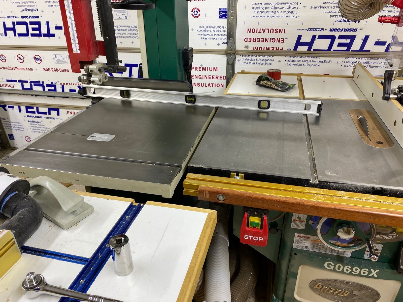

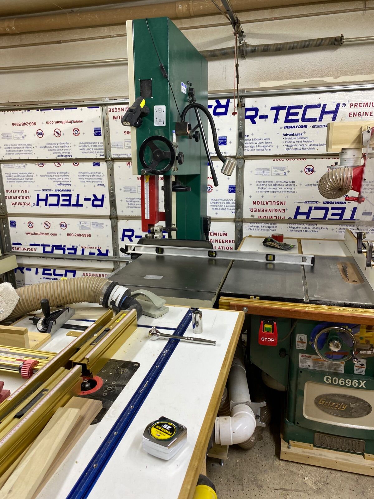

March 8, 20224 yr Author Popular Post comment_285622 Today was an interesting day to say the least. I did get the saw positioned and level with the other tools. That went very well. Then about noon my wife noticed a sound of water in a bathroom which turned out to be a pipe leaking under the slab. Arghh. So starting tomorrow they arrive to repipe the whole house. Five days of fun. Paul Report
March 8, 20224 yr comment_285627 41 minutes ago, Masonsailor said: Today was an interesting day to say the least. I did get the saw positioned and level with the other tools. That went very well. Then about noon my wife noticed a sound of water in a bathroom which turned out to be a pipe leaking under the slab. Arghh. So starting tomorrow they arrive to repipe the whole house. Five days of fun. Saw looks nice in its new home Paul. Sorry to hear about the plumbing problems. Sounds like my luck. One or two small things go well only to be offset by a catastrophe. Hope all goes well. Report
