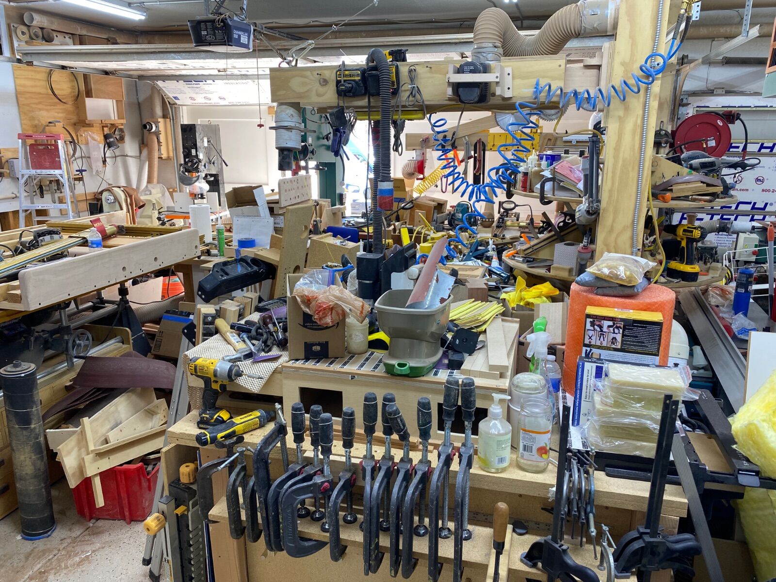

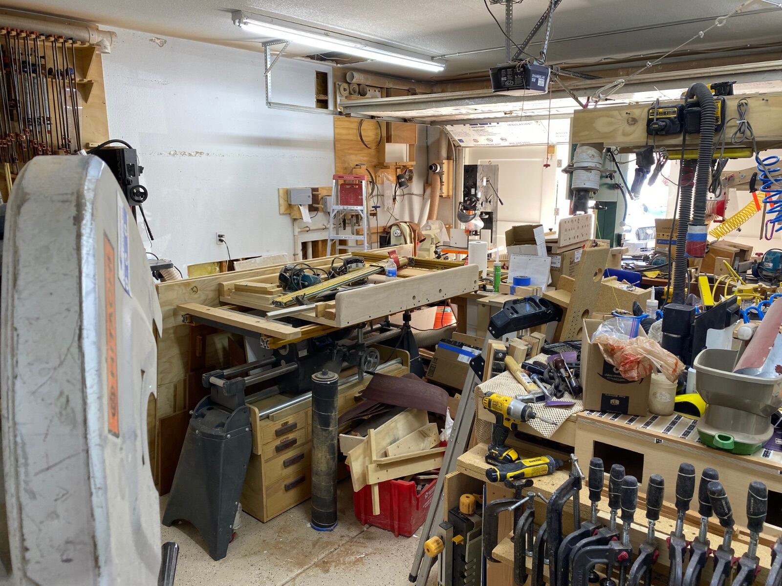

Well between the repiping of the house and the bandsaw things here just keep getting better and better. I did get all the blade guide bearings replaced and a new blade on it so I’m ready for power. Due to a major glitch in the repiping there is no way I will get to running the power for the saw for a few weeks so I am waiting on a price to have it done. As long as it’s not completely out of line that will probably be the way we go. The shop and house are just chaos with stuff everywhere. I had to move machinery and take just about everything off the shop walls and stack it in the middle of the room. The plan was to have the drywall guy here immediately after the plumbing inspection on Fri and then hopefully we can get things back together again. Oh the best laid plans. Their drywall guy is seriously behind schedule and won’t be able to get here for about three weeks. That means I won’t have a shop for another month or so and the inside of the house looks like Swiss cheese. The boss is very unhappy. I am going to tape and mud the shop myself because most of it will have 3/4” plywood put back over it so I don’t care how it looks. That way I can get it operational early next week. The house will have to wait. I can’t find anyone who can do it sooner so we wait for their guy to get here.

 It looks just a tad bit cluttered:BugEyeSmiley:
Neater than my buddy’s garage shop!
IDK Paul, shop looks pretty organized to me. I can see some open flat spaces to pile things. Once that's done,  you then move outdoors use the truck tailgate, a couple workmates, inverted five gallon buckets and the picnic table.:lol: Of course, when it's snowing or raining it can be a bit of a challenge. Upside, you don't need a dust collection system.:P.
