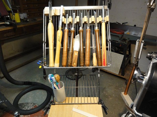

No one cared for them and they used to sell cheaper.  Some of their older tools aren't HSS.  Here's a picture some of mine and they are HSS.  This picture was taken years ago but if I went down and took one today it would look the same.  The darker handles are the Craftsman.
