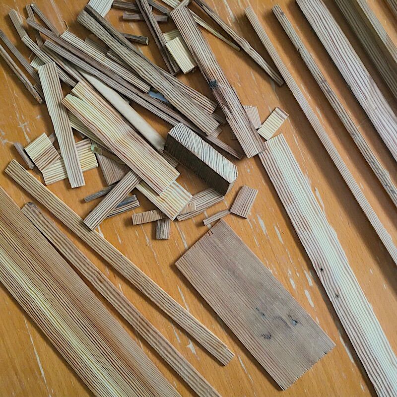

I'm almost out of heart pine but can maybe get another small shelf and a few pen trays out of my scraps. Amazing what you can get out of a single 1x6-6' piece of T&G flooring. Mine came out of an old school. Should have grabbed the other two pieces even though they were badly damaged.  There was also a notched-to-heck beam or joist, very heavy, splotched with paint, which I now realize may also have been heart pine.

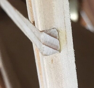

Here's my first question: Can this end grain be scraped flush with the plank as the plank is scraped? In theory, with a good enough burr or plane? Or do I use a chisel on the end grain only, like trimming a bushing peg on a violin headstock?

I think the scraper will work fine as long as the piece doesn't stand too proud of the surface. I would also angle the scraper so the forces push towards the notch.
OK, thanks. So if it is too proud cut it closer then get a really nice burr on my scraper and try again.
I've learnt that softwoods are not forgiving of inattentiveness. But I did once ruin a maple violin bridge in 6-7 seconds ... after putting 90 careful minutes into it. Funny how the fatal error happens at the end.

And a very light touch
Speaking of scrapers. Here's some good ones. https://www.stewmac.com/luthier-tools-and-supplies/types-of-tools/scrapers/stewmac-ultimate-scraper/
No turning and burnishing a curl required. A light pass on a white grinder wheel is all that's necessary to sharpen. They're not as wide as traditional card scrapers but, they won't burn your thumbs, either. :TwoThumbsUp:

I had no luck scraping against the end grain; ended up with a divot before the notch, the spilt glue in a mogul behind the notch. A tiny 120 sanding block then 400 sanding stick, and its cured for now. I'll put a 0.75mm bevel @ 45˚ on the feet edges and call it done. A model for the next one, in heart pine. Made to fit in a Medium Flat Rate USPS shipping box.

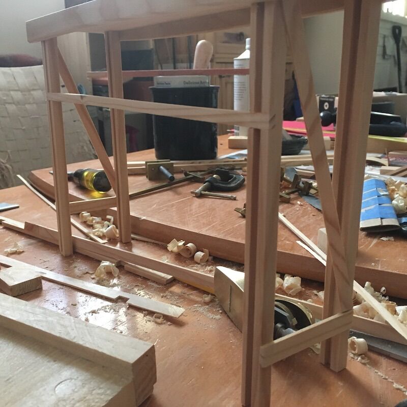

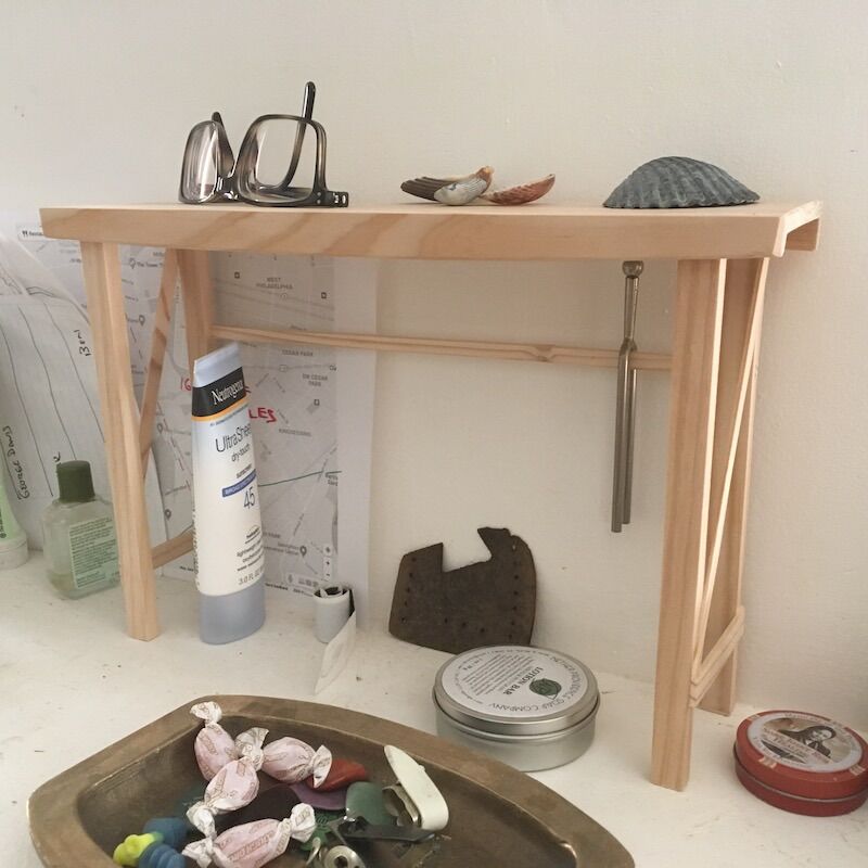

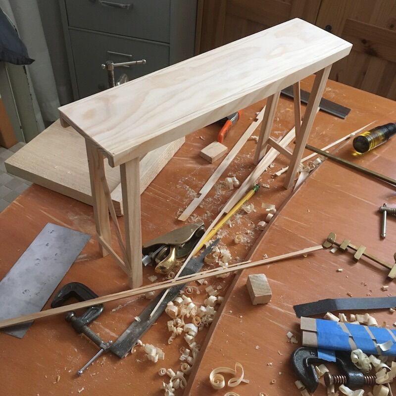

So here's the finished project. It started as a 12" x 3" x 25" 'table' to slide behind a radiator, to support a pan of water. But I decided such a table would rob me of a valuable place to toss old socks; besides, that is where I hide my dust brush. So I went mediaeval on the pan support, and changed the 25" table to a modest 8.5" It is now a Mantle Table, taking clutter to new heights.
My camera will not manual focus, so detail shots are difficult unless taken at distance then cropped. I'll do what I can.
I'll put together a project post maybe weekly with a chronology of images. A trash vessel was just completed, in fact, after finally ordering a Lie-Nielsen No. 102.

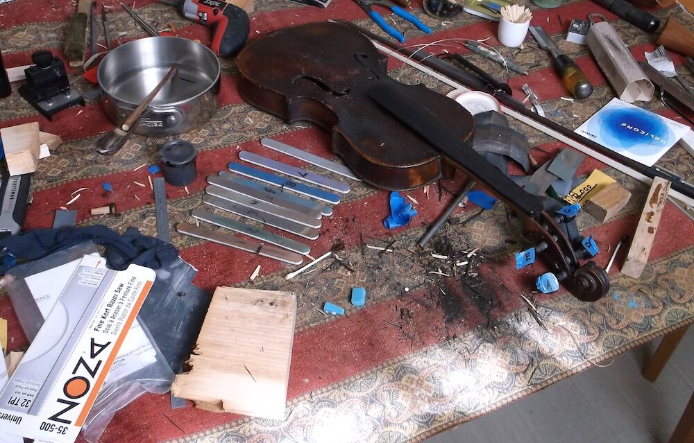

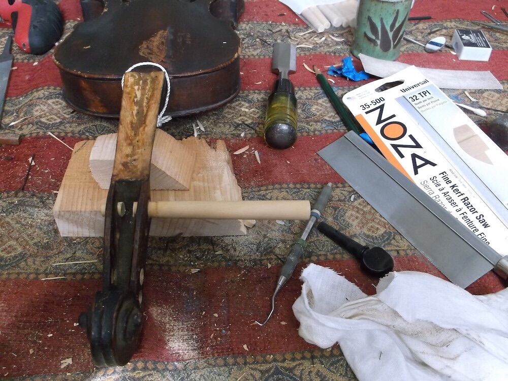

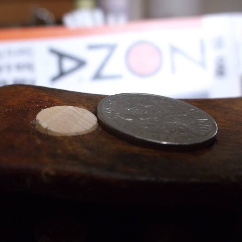

Here's a pretty old 'trade' violin. 1860 - 1905 ? Really hard to date, possibly so rough because some trade musicians lived a rough life. The pegs were even roughly swapped around to make it a lefty for a generation. I've inserted boxwood bushings into the pegbox. My Zona is brand new here in 2017.
 A guy who rebuilds Pre-War Martin guitars *** bought it off of me. The highest form of flattery at $10/hr. Almost. The cello @ four months which went to a HS student was an even more rewarding $4/hr. :)

The Zona  did all the work. Getting that bushing flush, I sure made a mess with the chisel. Nothing a handful of dirt and spirits rubbed into the old maple, can't hide. Caulk and paint make a carpenter what he ain't has nothing on the tricks up our sleeves. ^_^
