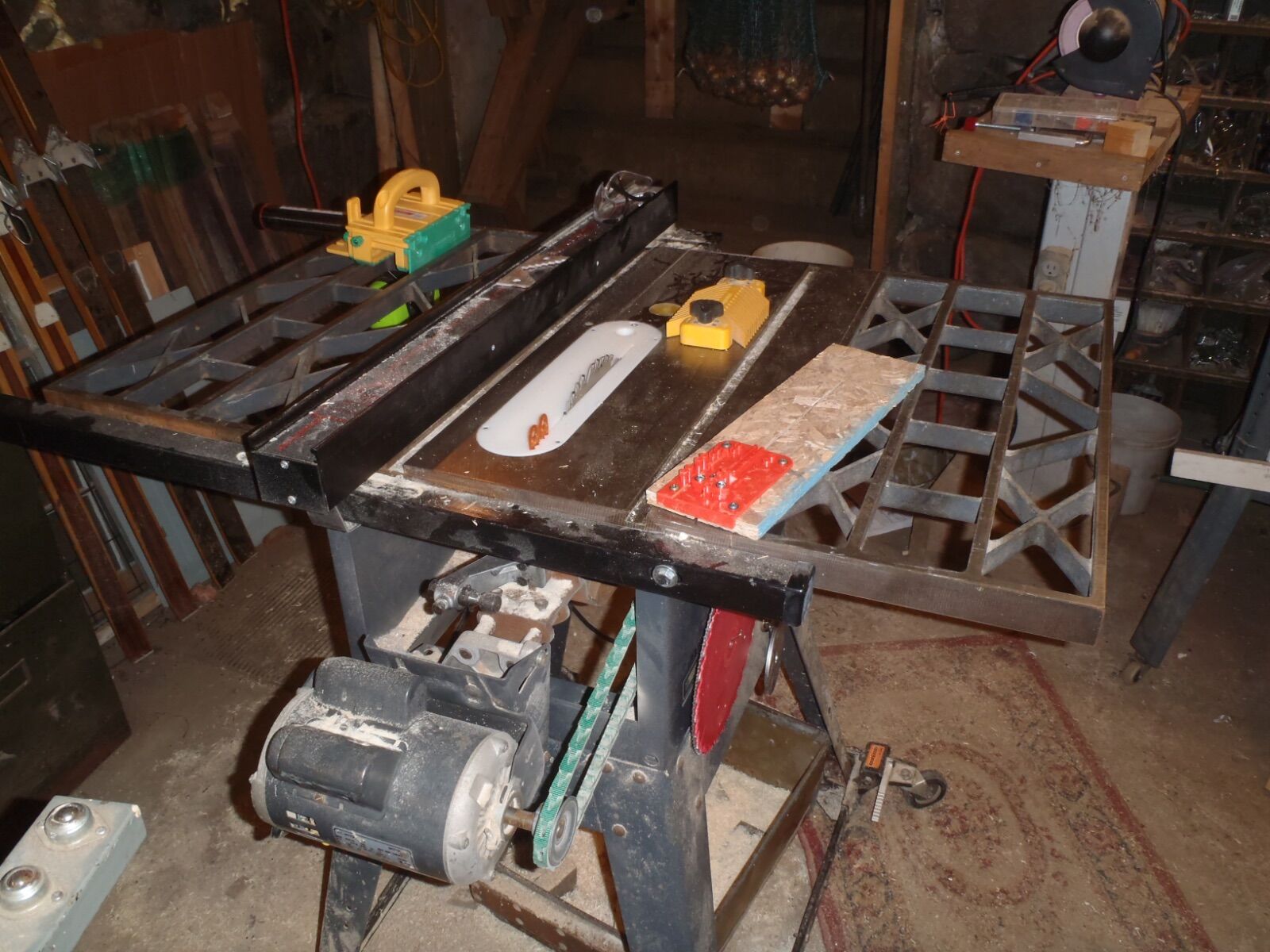

A while back I bought a nice old Craftsman TS with a Cast Iron top and wings from my small engine repair guy for $50. I brought home and it wouldn't rip anything without bogging down and only a fair job of cross cutting. I took the motor off and had it checked and remounted it adding a Link Belt. Better but still not good.

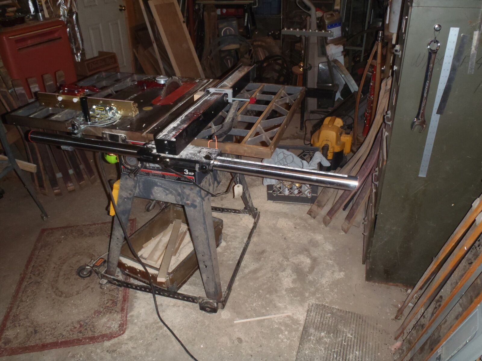

The old fence was impossible to use and always wanted to toe into the back side of the blade, so I replaced it with a new Vega Fence. I like it, it mounted on the old saw easily with just a couple simple modifications. Better but still lacking.

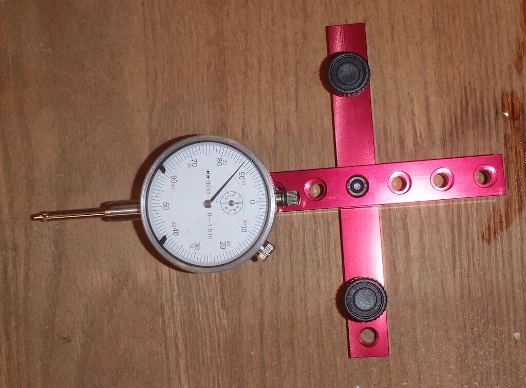

When all else fails seek your answer on Youtube. I found it where I should have started and should have remember in a video on setting up your TS. Turns out the back of the blade was just over a 16th" toed into the fence. The adjustment requires loosening 5 of the 6 bolts, make an adjustment and retightening them. I tried a couple time and got it closer and it was cutting better but I knew I could get it closer. I ordered an "A-Line-it" dial.
I raised the blade and took my first measurement, while rotating the blade 180˚ the blade stopped. NOW WHAT?!? Looking inside I could see the lug on the pulley with the set screw was hitting the underside of the table. I removed the set screw to find that it was not touching the Arbor and the pulley needed to come off and the pulley rotated.
The pulley won't come off and even if it had most likely I wouldn't be able to seat it correctly. The Cradle had to come out. I remove the motor, took off the stand and finally got it out. I reversed the pulley, secured it to the arbor, and put the cardle back in. With the legs off it was a lot easier to work the 6 bolt for the alignment and in two tries had it almost perfectly aligned with closer tolerances than the video said were acceptable.
I put the saw back together, set the fence and ripped a piece of 1x pine and the motor didn't bog down, so I found an old piece of Beech that was around 1 3/4" and ran that thru not bogging, no burns.

Lots of work but well worth it! Looks surprisingly like my Bridgewood saw. I have a similar Vega fence.
one thing I found with my saw is that when tilting the blade, the weight of the motor causes the rear of the blade to shift slightly towards the fence because of play in the trunnion gear.
Had one like her . Wife bought me the Sears fence with a round mounting rail. that helped and I put the link belt on also. I built a cabinet on wheels for mine .

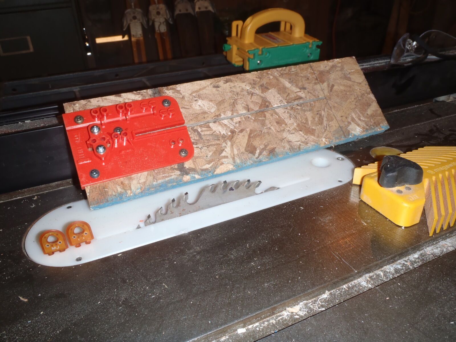

The saw is done.
I installed the MJ SPLITTER Steel Pro
https://www.microjig.com/products/steelpro-thin
P1310129.JPG.c6ca3842b0a58b325d71c79ffcd7b032.JPGP1310130.JPG.af9b41a378bb2ab06dc11198d40dc22c.JPGP1310131.JPG.2b984c9a5ab6857f13e851b05a806fad.JPG
Missed seeing this @frenchwwr. Looks good.. What are your thoughts thus far?
So far so good.
I think they'll add safety when I rip pallet wood, there's usually a bit of twist in it, but I haven't run any thru it yet.
Nice looking fence and rail upgrade on the Ole Craftsman. Is it a Vega?
It is a Vega

I had this splitter on my old Craftsman and it worked well, but those thin pegs do seem too thin as I broke one of the guides and stopped using it .
That was my thought when they arrived, but lacking other options on this saw especially when cutting  pallet wood they will provide a modicum of safety that I will not count on.
