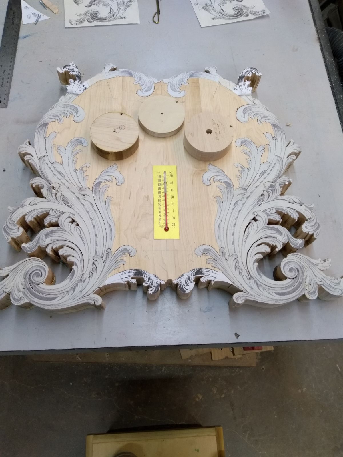

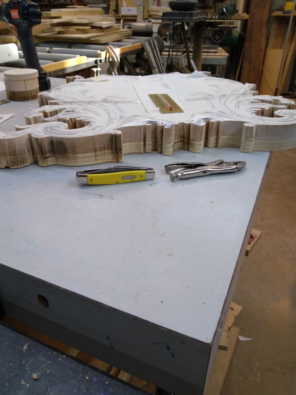

Outside of the new project cut out.
   Not for candy asses!. The maple board is 1  1/16 " thick and the backer board is 3/4" ash plywood. I should have weighted it for this is the heaviest thing I have ever cut with the scroll saw. 337199933_IMG_20220103_204441734outsideofnewprojectcutout..jpg.d42f161e8ee77daaffe69a29266c8846.jpg
I sprayed the stickum on yesterday so I don't have very much time left before the glue stops holding down the pattern for me to cut each piece apart.
This is very hard on my old scroll saw.
Its sitting on the table saw extension for size comparision.

With a piece that heavy, how do you support the material that hangs off the edge of the saw table?
How big is that monster?

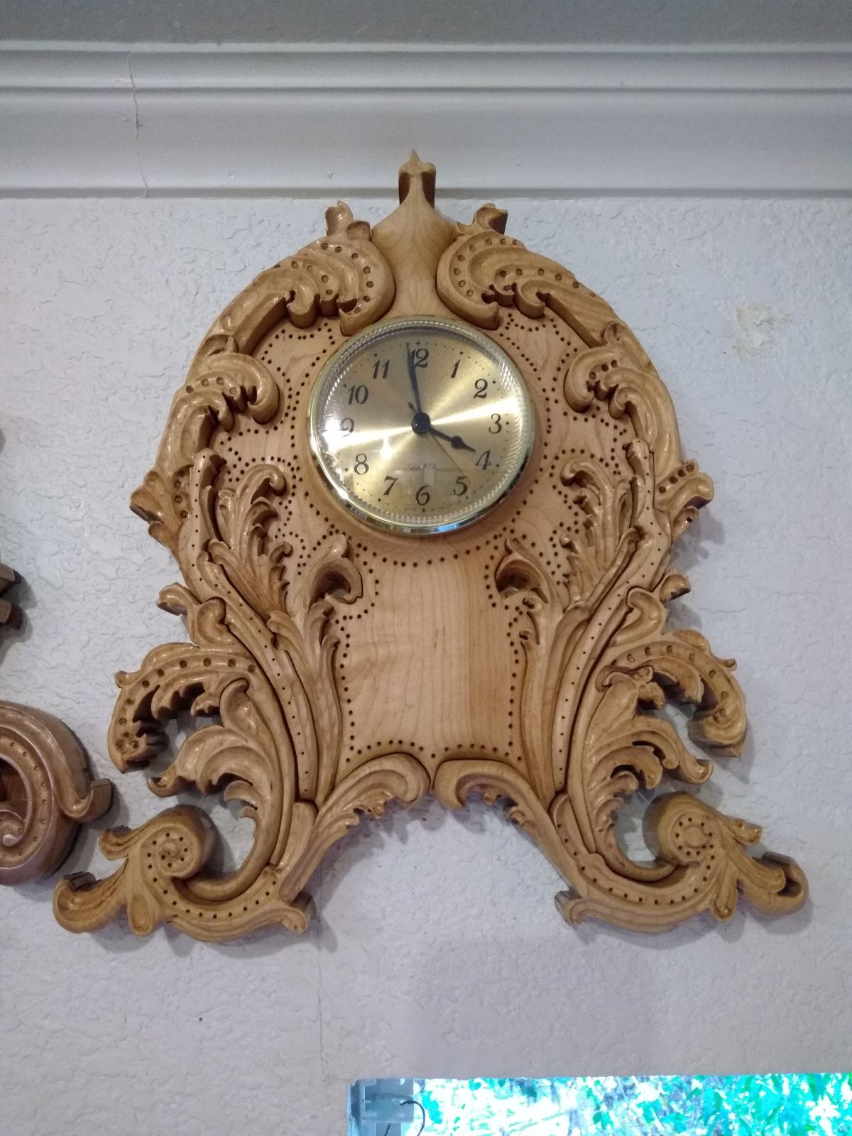

1433965169_IMG_20220104_173754942finishedthescrollsawing.jpg.c0df1123fcd9eb30236d53c3218485b1.jpg
25" cross ways and very hard to fit under the 788 which is 22" capacity

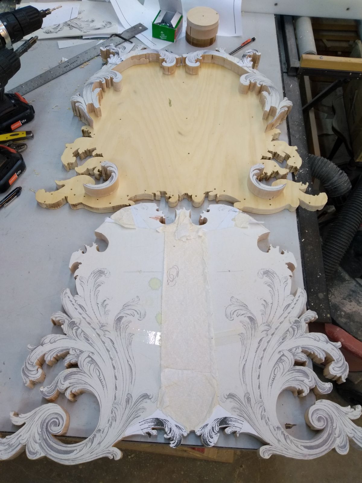

The first thing I do when starting this project is to cover the entire slab of maple with Scotch brand packing tape.
   I have lots of small pieces of patterns for this puzzle to lay in exact areas so the wood gets lots of pencil marks to let me know where each piece goes...
  Like I said the packing tape goes over all the wood then I spray Scotch brand spray glue over all the tape and
make sure there is plenty of stickum every where..I have lots of hours ahead of me to get all the scroll sawing done so I don't want anything to move around or part of the patterns to come off...I find the cheaper tape does leave sticky spots all over the wood and to get the sticky off I use lacquer thinner, which is the fastest, Scotch brand works better without having to find some to remove the sticky.

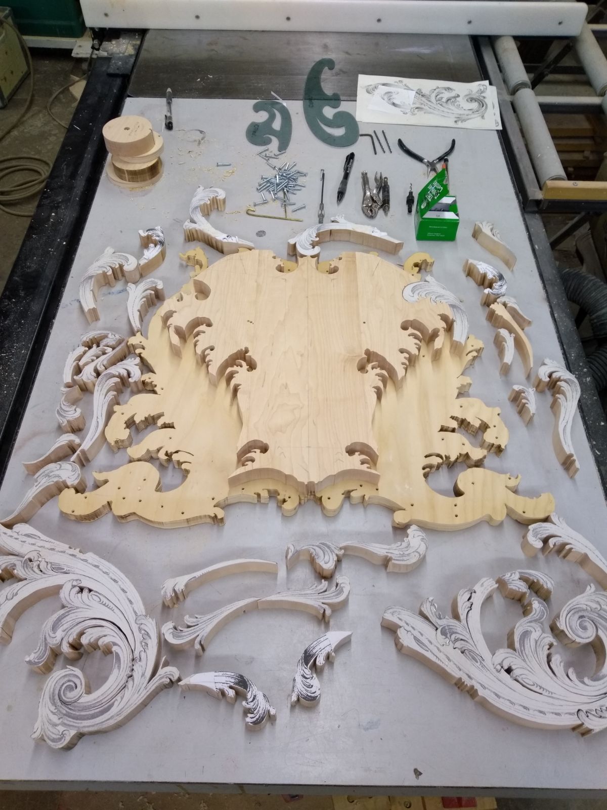

  I pulled all the tape off of the interior as soon as I finished the sawing.  This picture shows all the interior with the tape removed. I have so many pieces of this picture I don't want any pieces lost so I keep them in their slots until I need one to carve. I also need to learn where each piece goes of else it would be like a new puzzle to put together
  Before I started scroll sawing I attached a backer board to this piece of maple with counter sinking a few sheet metal screws to hold the backer board to the hunk of maple only in the interior where no scroll sawing would be later. Then as I started sawing the outside from the waste wood after a few inches sawing I will stop and pre drill a few holes and insert more screws. To me this procedure is very important for all the pieces of wood they will go back exactly where they started  before I start cutting them ,one piece at a time and then will have an exact place to return them to.  I mostly concentrate on all the outside pieces having screws to keep them in place and since some of the interior are too thin to have screws.
   I don't get any wood cracking out from screws for I use a drill bit that is say .010 smaller than the width of the screw. Only the area of the outside of the threads should go in to the wood and not bulging where the wood swells out until it bust.

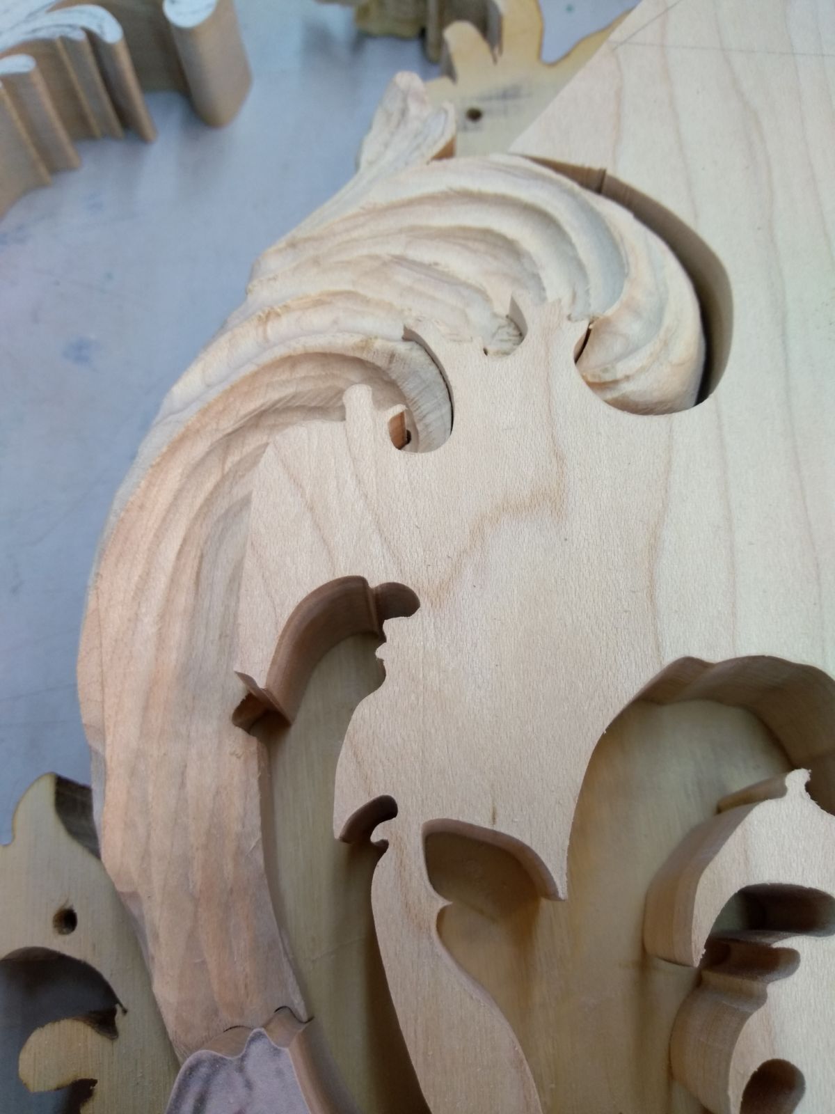

I started carving first piece just to see how much the center section with the bare wood showing needs to be ground down.1848371915_IMG_20220105_174224482cuttingcentersectionshowscarvingbetterbutnowlowerthecenter.jpg.dabf225c4b400615c3a2e553ad2775b0.jpg
The more I grind the center section down the more the carving will show up. I will slop the wood around the carving so the gap will come together about 1/4" down  making it look like there is no gap between the carving pieces and the slab or the center hunk of wood.573303382_IMG_20220105_174726483startingtocuttheinsidedowntoseethecarvingpieceIhave.jpg.520c204ac96466b6771c8cf082879536.jpg
I think a real wood carver would only lower the bare wood 3 or 4 inches out from the carving pieces which would be way less labor involved but I can lift out the carving pieces and use a wide planer and after I measured the width of my planer and the wood is 1 inch too wide  so I started using the hand held belt sander with 80 grit belt  and its removing the wood fast enough.
