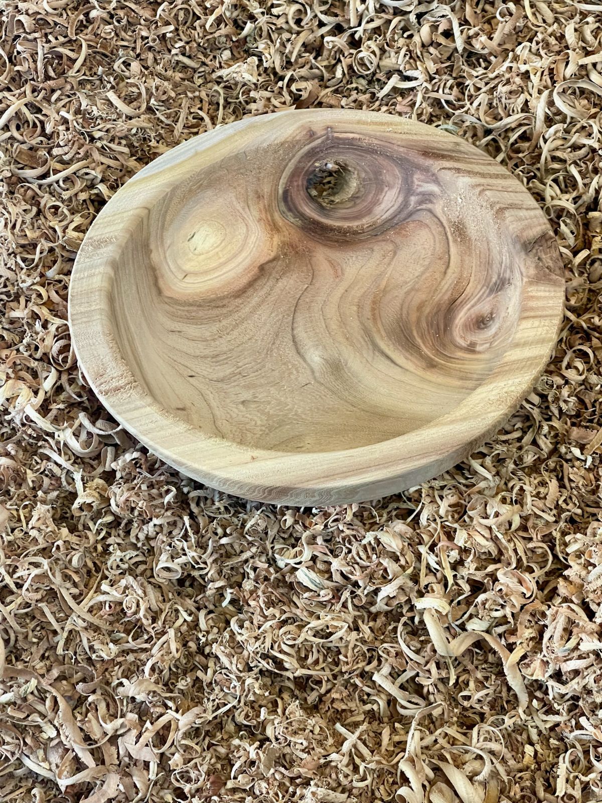

December 4, 20214 yr Popular Post comment_277111 12x4 pecan bowl with copper inlays. Twice turned, crotch wood, immediately seized and disappeared by Mrs. Boss. .40 Report

December 5, 20214 yr Popular Post comment_277184 Great looking piece @forty_caliber. So would this bowl be rough turned, exposing the voids, then the copper is added and then finished turned? Report
December 5, 20214 yr Author Popular Post comment_277191 1 hour ago, DuckSoup said: Great looking piece @forty_caliber. So would this bowl be rough turned, exposing the voids, then the copper is added and then finished turned? Yes. Here is a photo of the rough turned stage. Taken 9/12. I added the inlay after removing about 1/2 the total amount of material into the 2nd turning. Used "cold casting" to add the inlay. Since there were large voids I used 30 minute epoxy mixed into a putty with fine copper powder. Made dams out of duct tape to hold the epoxy in place while drying. Smaller voids can be filled with the copper powder and CA glue in much the same way. .40 Report

December 6, 20214 yr comment_277256 Thanks Forty for clearing that up. My brain wasn't thinking epoxy but that makes more sense now. Report
