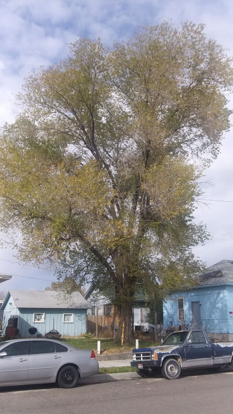

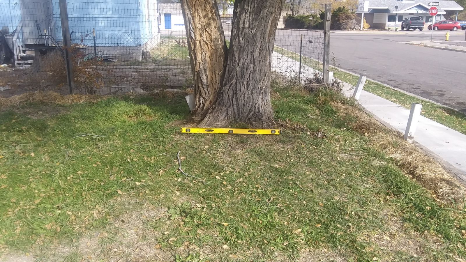

October 29, 20215 yr Author comment_273615 I'm planning on waiting until the middle of winter to have it cut so I can keep the live edge. It's a big tree (50' tall, bottom is two trunks 17 and 20 inches wide at the base at least 8' long before they branch. Report
