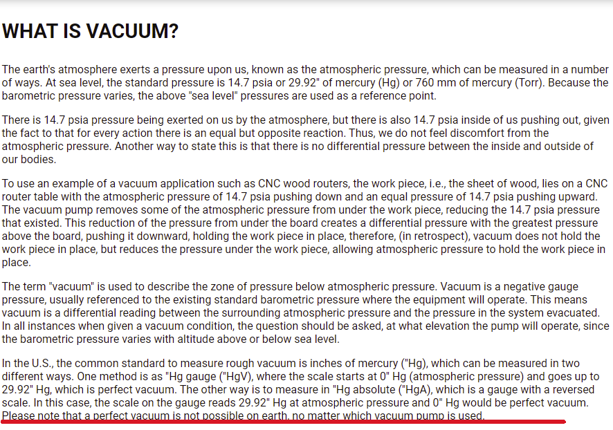

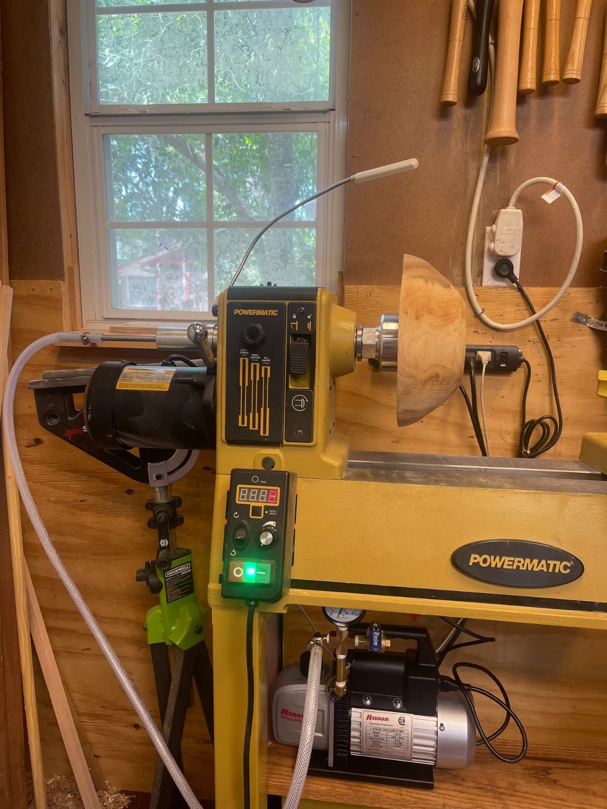

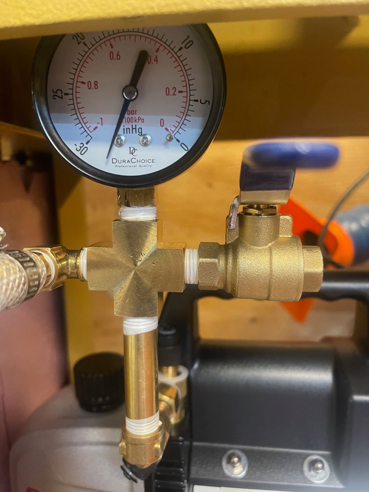

August 20, 20215 yr Popular Post comment_269898 After doing quite a bit of research on the topic, I pulled the trigger on a Harrison Vac chuck and Robinaire pump. I've got it installed and working...that is pulling a vacuum strong enough to stick a bowl on there. I can't seem to shake the feeling that I'm getting ahead of myself. What is in the secret sauce? I would appreciate the benefit of your experience. In other words, what in the heck do I do now? The gauge is pegged out showing in excess of 30" of vacuum. Is that normal? .40 Report
August 20, 20215 yr comment_269899 Thats why the gage only goes up to 30 for a perfect vacuum is supposedly 32 and those fire trucks I use to drive when we at a farmers irrigation well trying to draft a tank of water to fight fire,25 lbs was about all we could ever see on our gages..and every extra foot of height the water was down from the pump meant it was that much more harder for that pump had to work to get that water in those pumper tanks. If the water was 32 foot straight down no pump could ever suck any water... Now what do you do next?? close your eyes and run. Report

August 20, 20215 yr comment_269902 I wonder if the gauge is accurate. A perfect vacuum is -29.92 in of Hg G Report

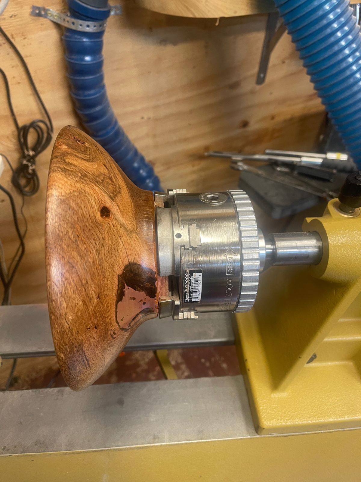

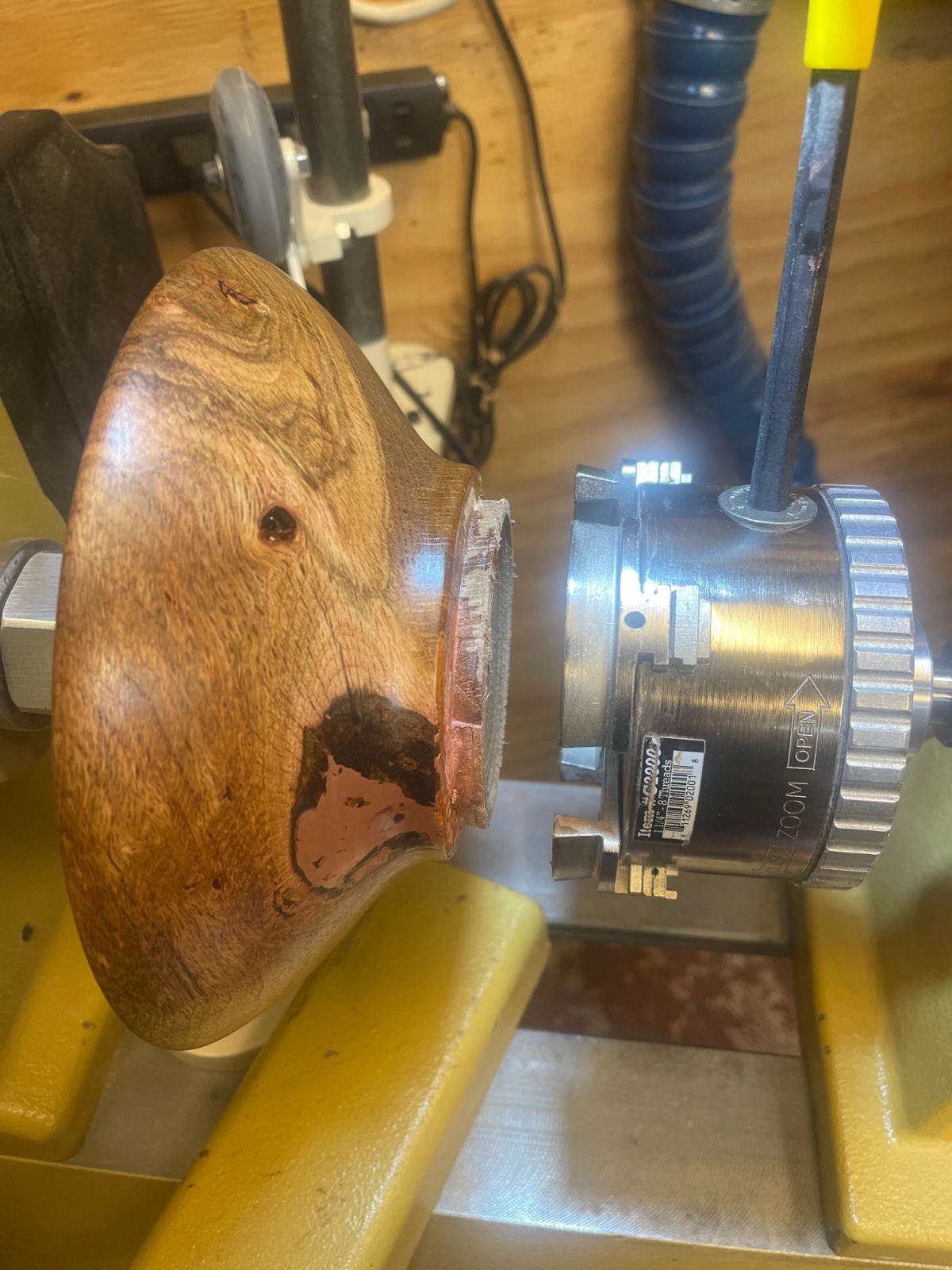

August 21, 20215 yr Author comment_269947 I used the V chuck this morning. While 2nd turning a bowl, I got a bad catch and broke into the mortise. Fortunately, there was enough material to create a tenon. I turned the bowl around and used the tailstock for support and help find the center. Opening the valve on the christmas tree allowed me to control the amount of vacuum to easily correct any wobble. Gentle cuts, with pressure toward the headstock and bada bing bada boom...a tenon. Worked like a champ. Setup was a little quicker than the cole or longworth chuck. The bowl still had a pretty rough finish at this time. I expect that a sanded and finished bowl would have even better adhesion. I think the biggest advantage will be a non-marring way to mount and finish the bottom. That said, I don't think it will ever stand up to any aggressive cutting. .40 Report

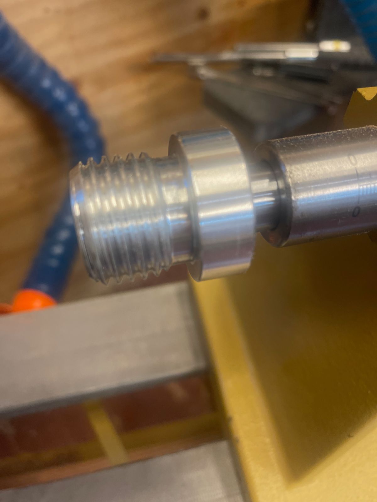

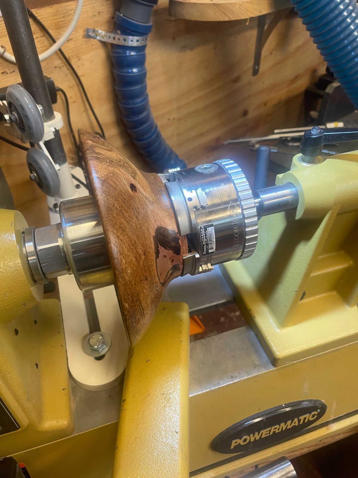

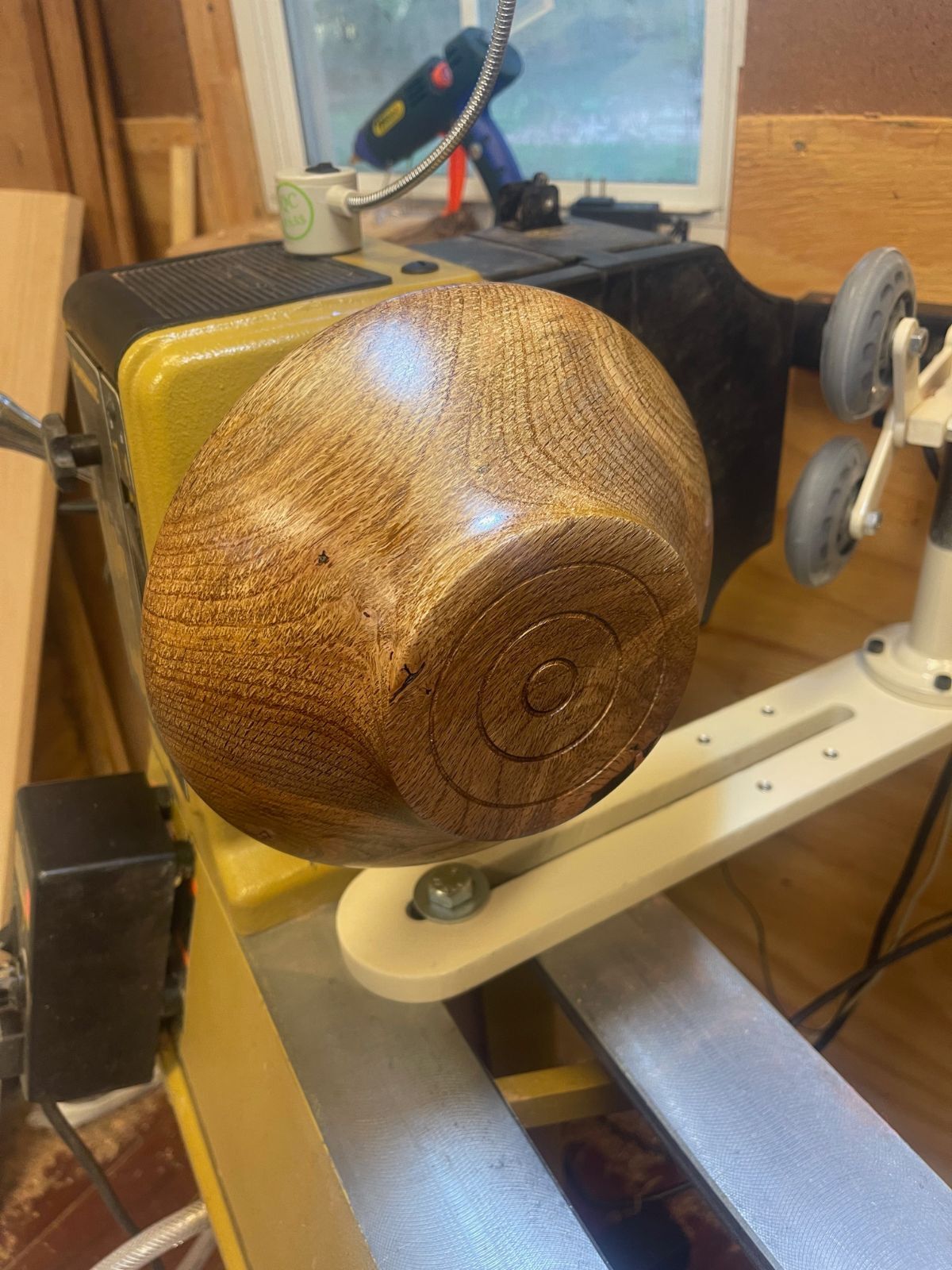

August 22, 20215 yr Author Popular Post comment_269985 Photos showing finishing sequence. Prepare to reverse mount chuck with 1 1/4 x 8 MT adapter in tailstock Screw chuck onto adapter. Fire up the V Chuck and move tailstock forward to engage. Release jaws to free bowl. No wobble. Finished bottom of bowl using V chuck. .40 Report
