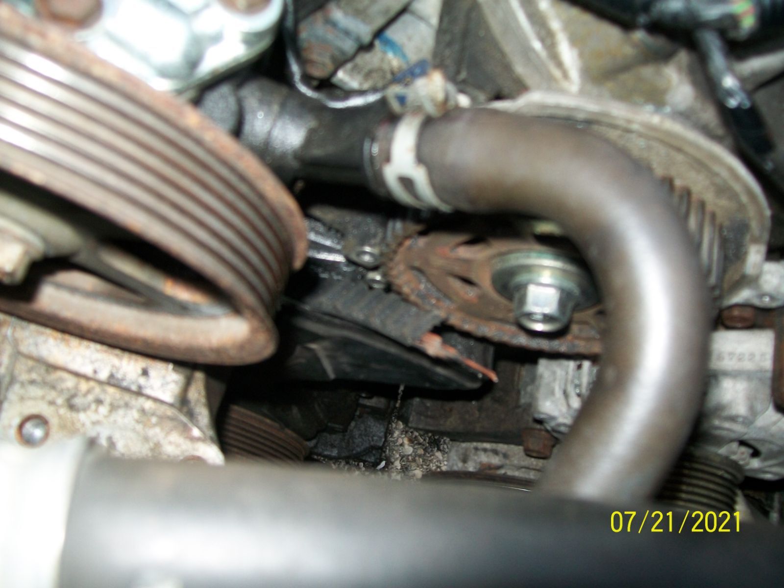

18 hours ago, Gunny said:
Take picture of belt for me.  Might help figure out what happened.

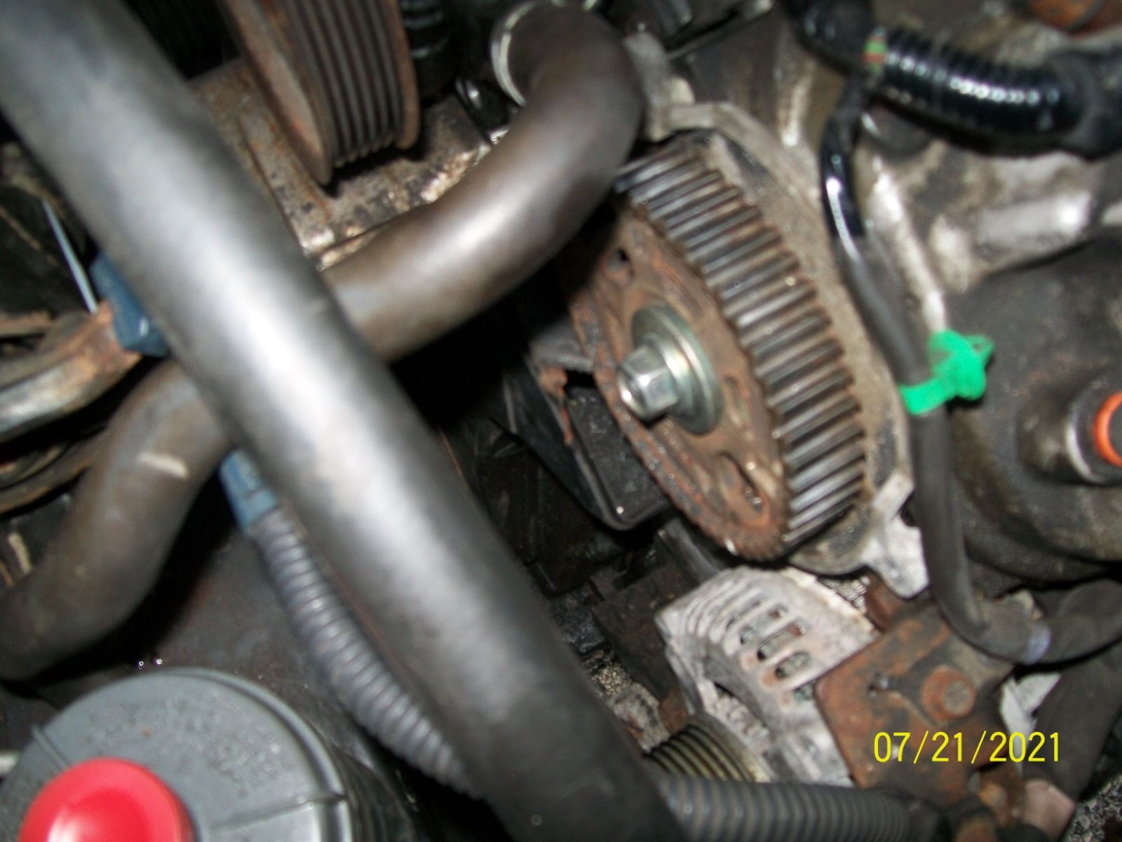

Here's what I've found so far, need to go get that Honda damper socket to proceed further.
100_2159.JPG.1ed94a577b7a65c563feef822f9ec62c.JPG100_2160.JPG.9737191be33ff751373325c89673556f.JPG

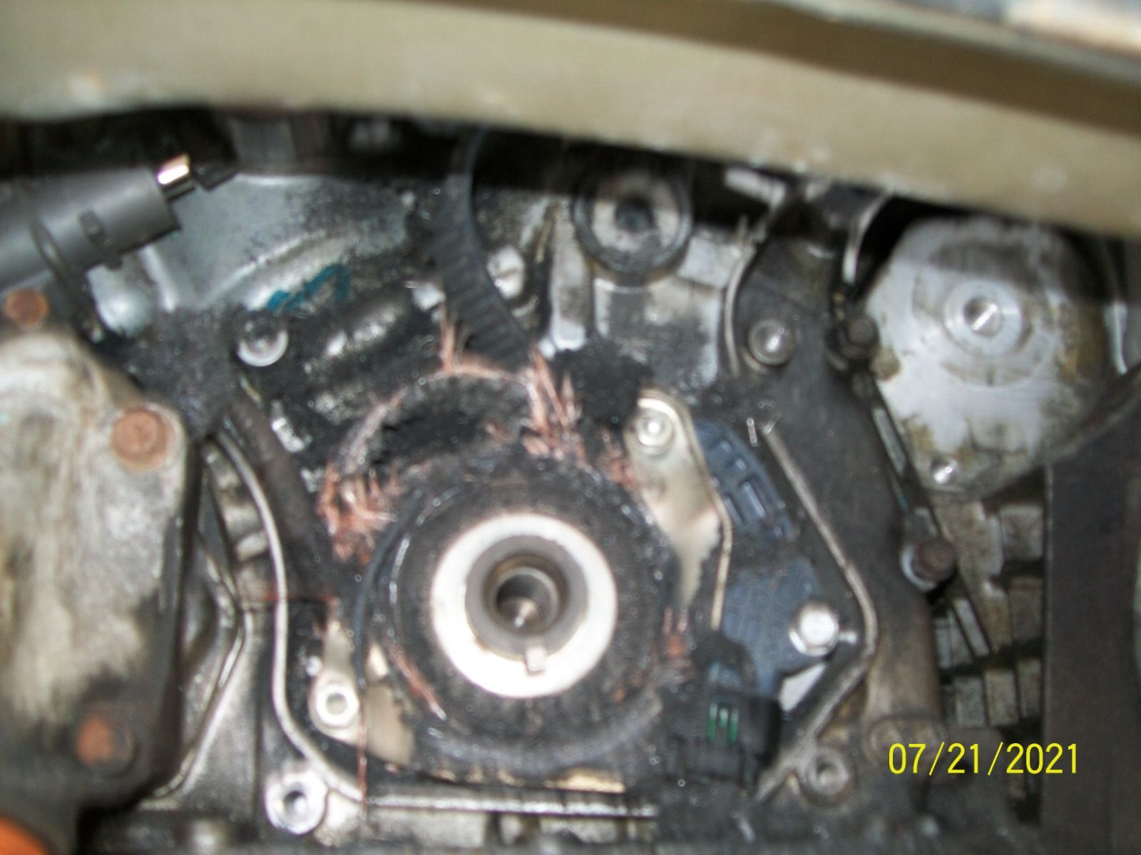

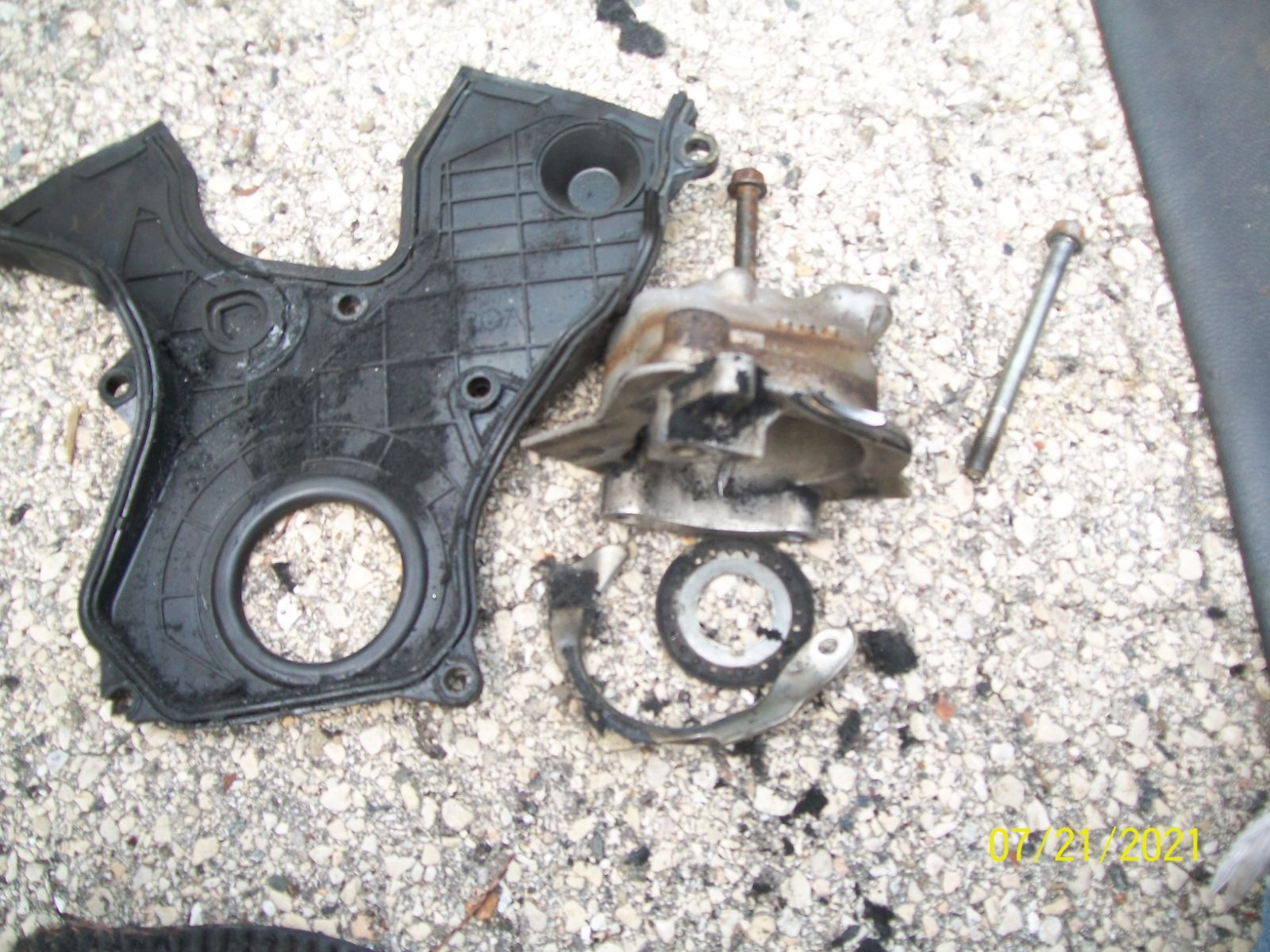

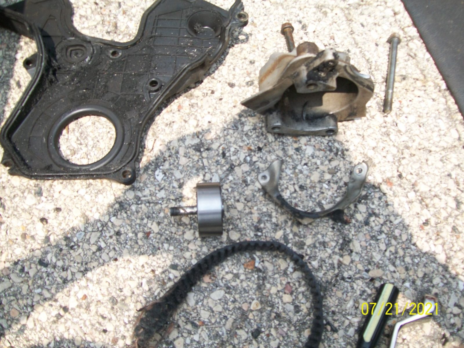

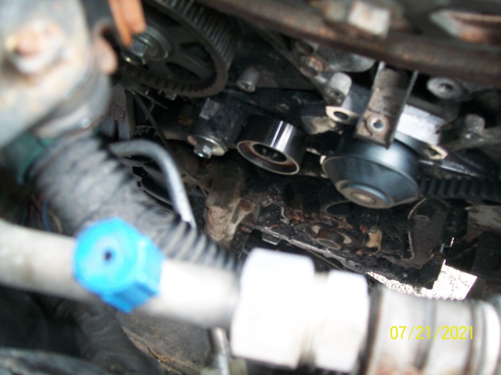

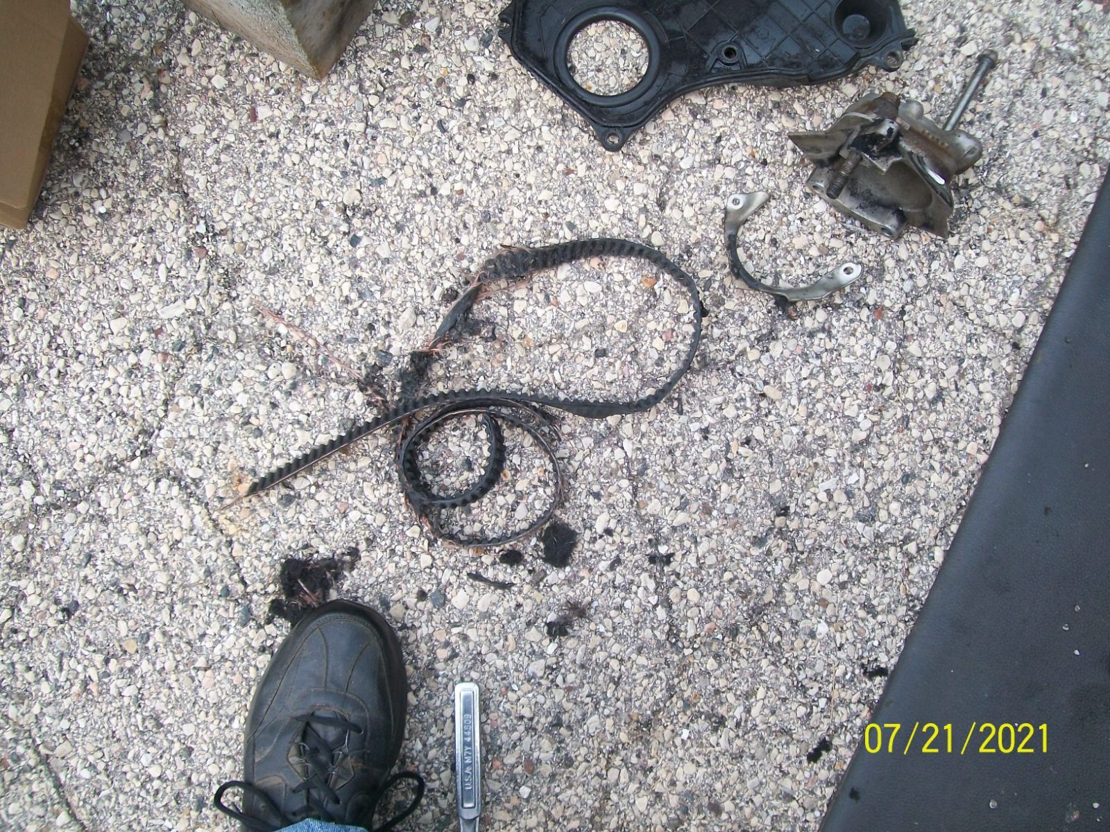

Well Gunny, it appears the idler pulley failed and snapped off it's mounting bolt in the block.
Here's a few photos of what I found.
Just after removing the timing cover.
Made a pretty good mess around the crank pulley. Notice anything missing? It fell out on the ground when I removed the timing cover.
Took out a few other parts as well.
100_2164.JPG.482e81b93be7482929dea9711ecbe606.JPG100_2166.JPG.7052434b15ed35e237424bf4aae4b768.JPG
The bolt is stuck in the idler pulley. Kind of surprised I didn't hear anything, but being in the construction zone I might not have been able too.
:ChinScratch: Kind of how I'm feeling. :throbbinghead:

31 minutes ago, Gunny said:
Bolt fatigue is common in Northern vehicles.  Dissimilar metals don't play well together.
May only be partly related to bolt fatigue, the bearing failed and spun good enough to spin weld the bolt into it.

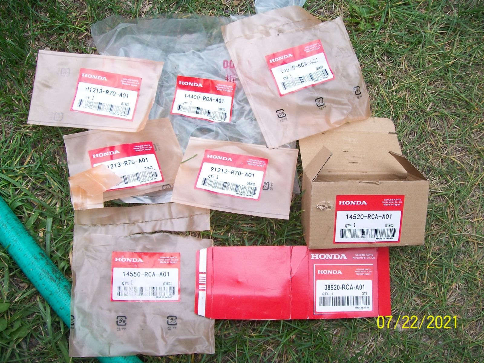

What kit did you buy? Timenko?
On 7/19/2021 at 5:18 PM, FlGatorwood said:
Thad, just curious as to your location along the Gulf of Mexico.  I am up near Mobile, AL, about 50 miles from it.  That appears to be open sea.
I'm on the Genesis platform in Green Canyon.  Deepwater GOM.  I live just north of you, though, in South Alabama
Supposedly OEM Honda, parts all matched what was removed, including the KOYO bearing part numbers.
Water Pump has the cast on HONDA name, parts in separate bags/boxes with Honda labels/part numbers.
If it's a fake, it's a D#%n good one.

Yo, @Gunny

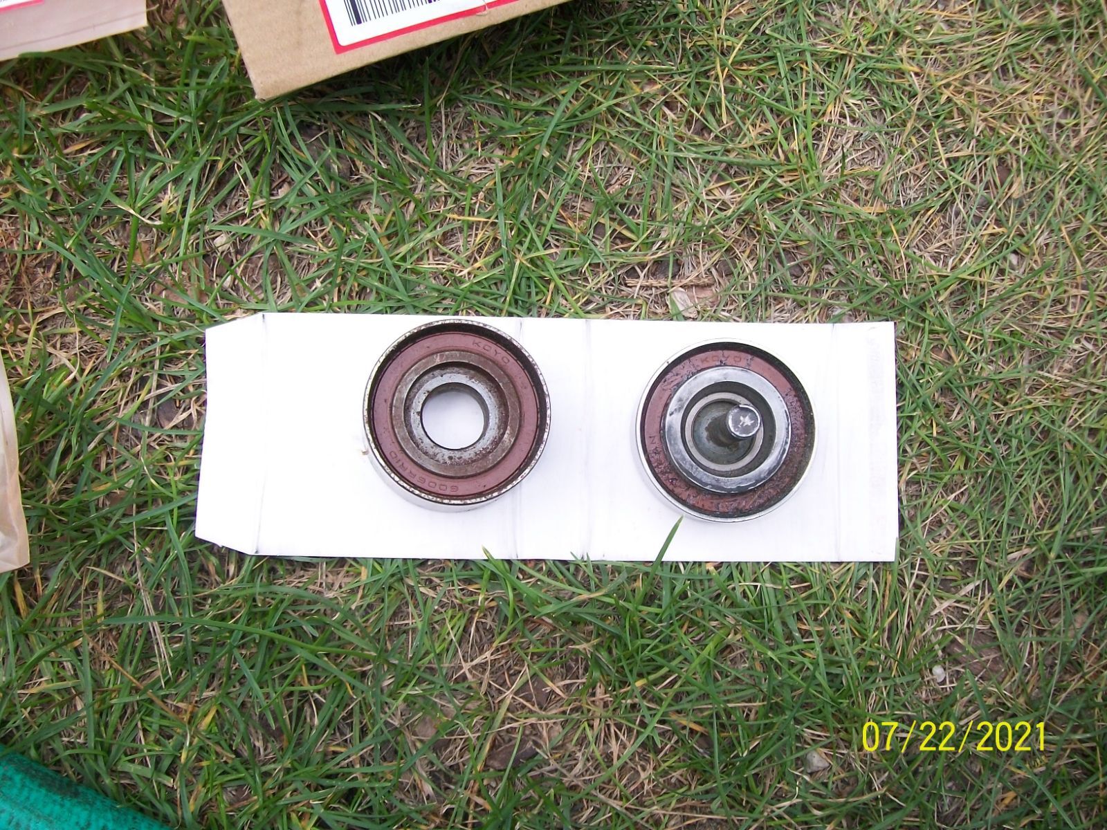

The idler bearing/pulley mounting bolt is spun welded into the bearing. I've tried getting it out.
The remainder of the bolt is broke off in the block, and I'm sure you know where it's located.
Of course I saved everything but the old timing belt, which I could have used to check the valves for damage. :BangingHead:
