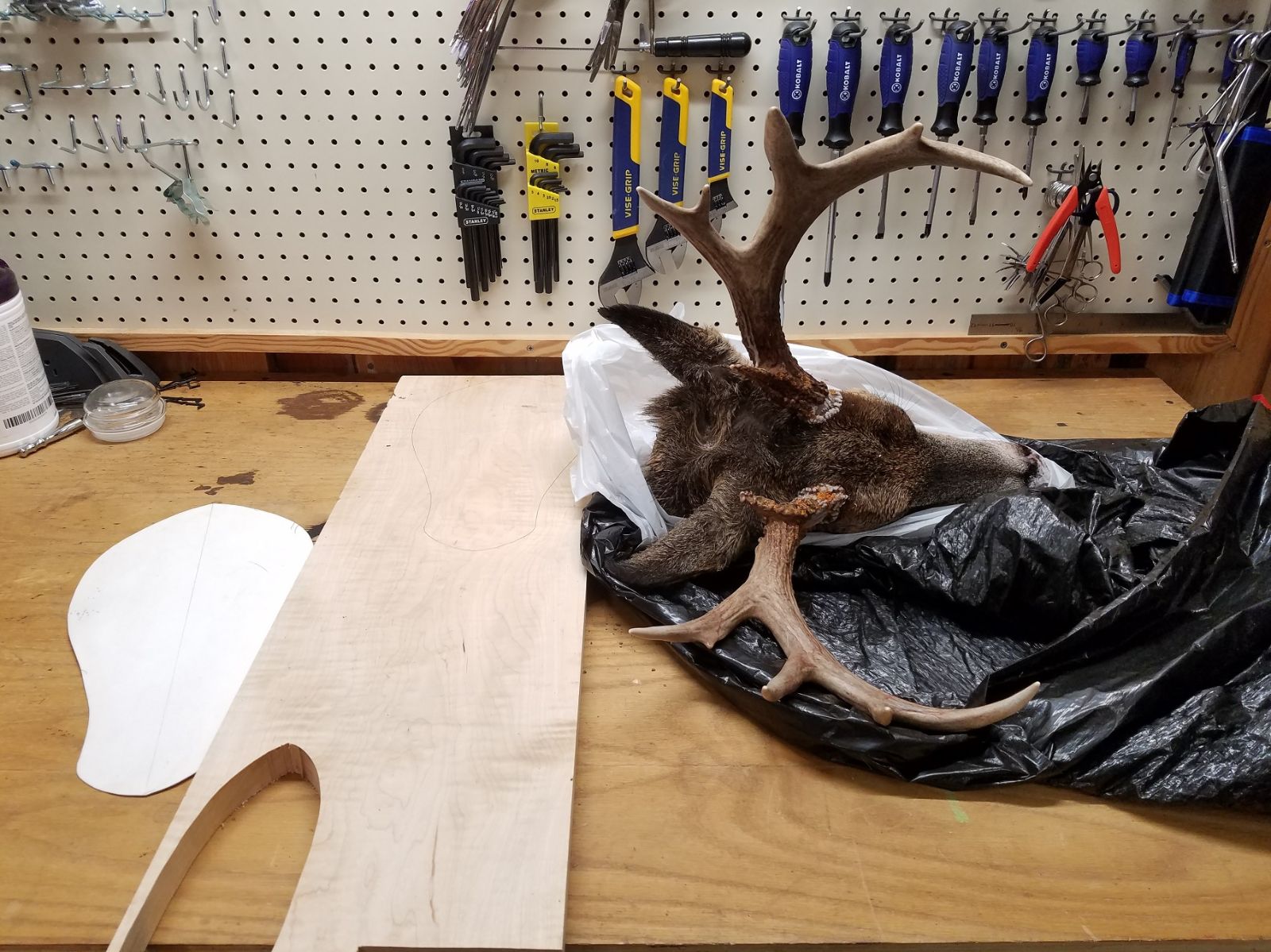

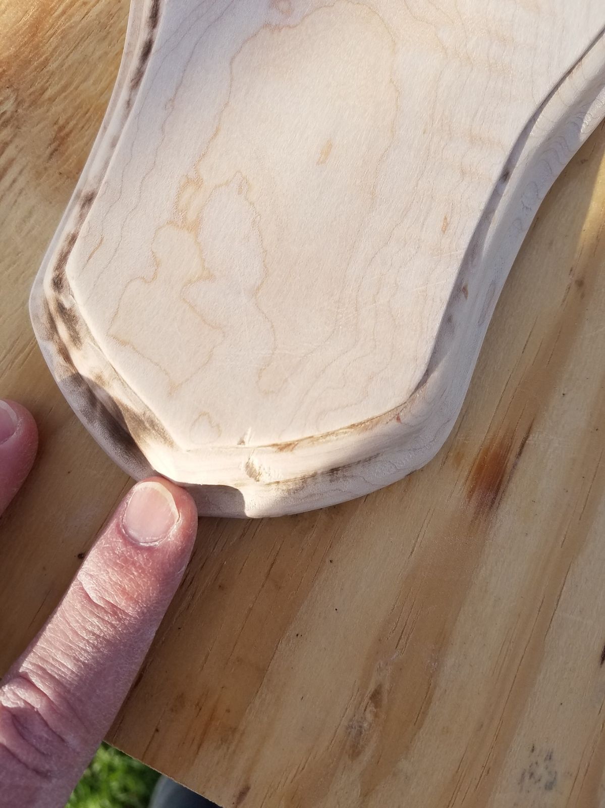

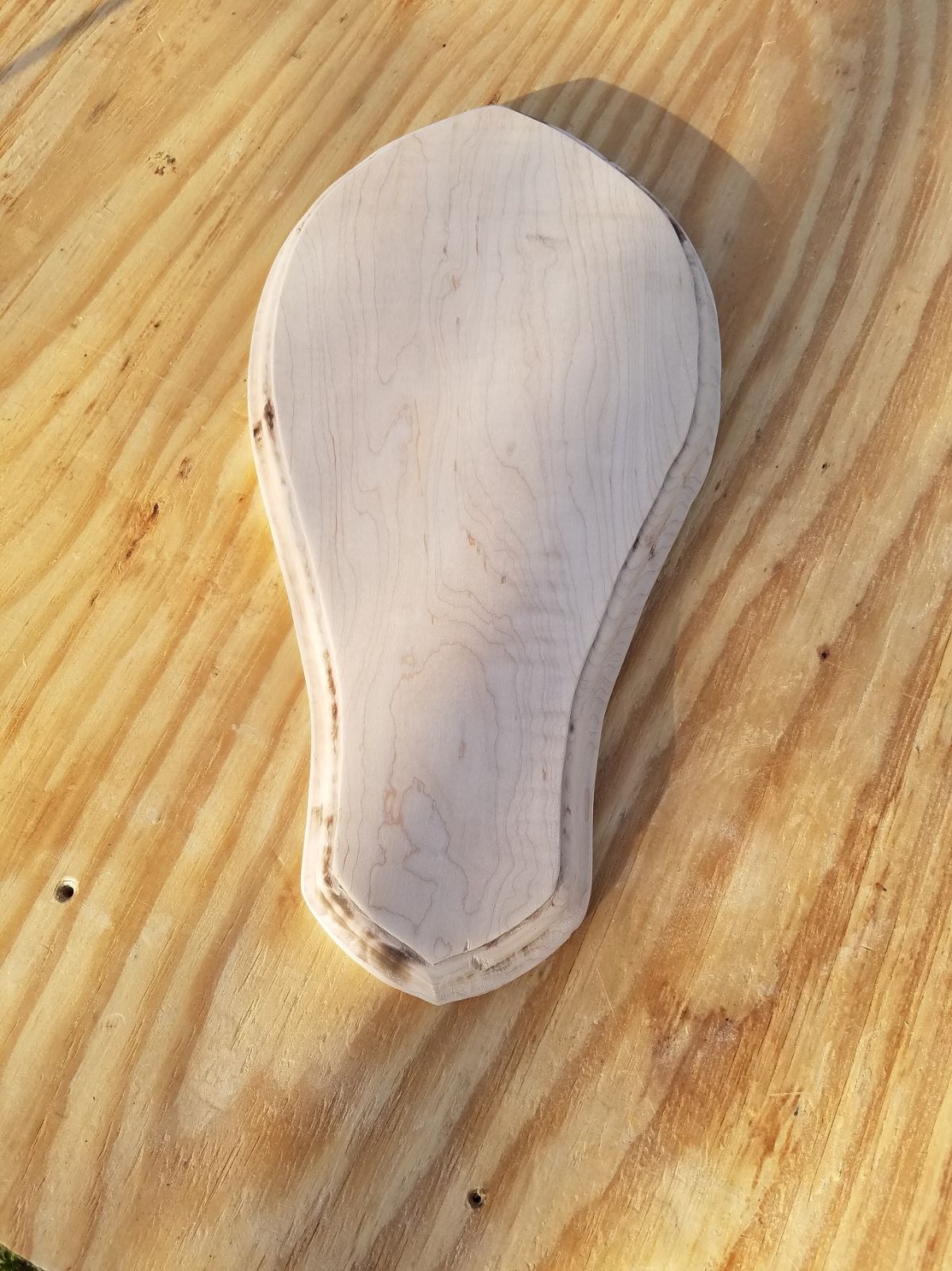

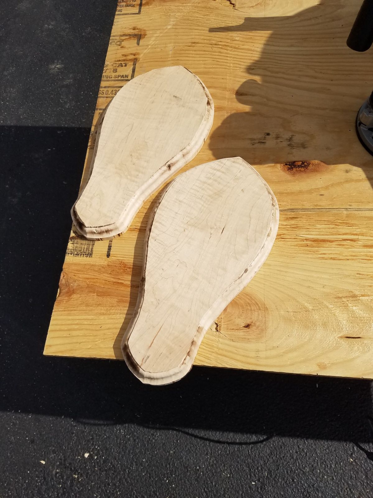

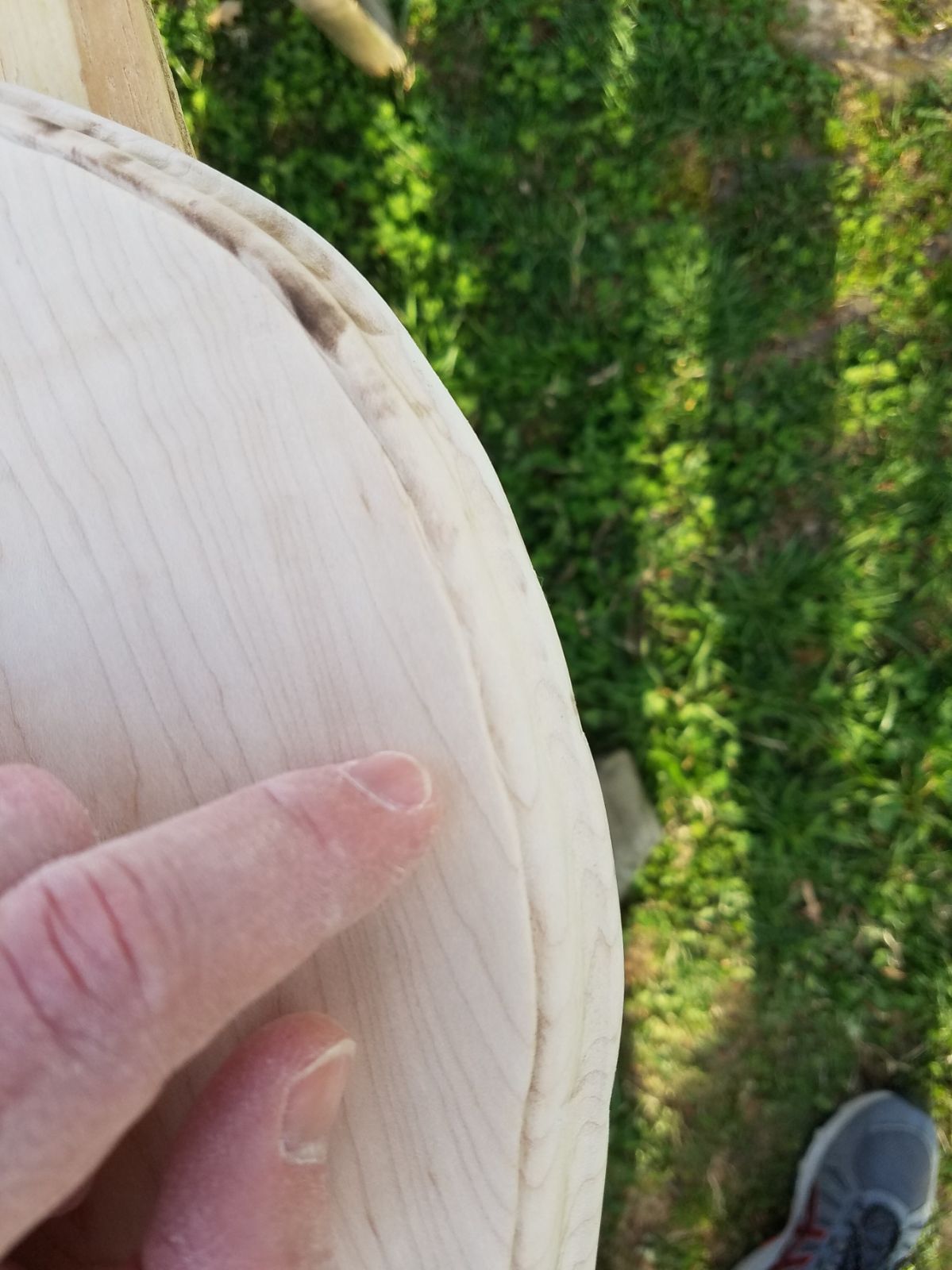

March 24, 20215 yr Popular Post comment_261540 Nothing grand,..just cleaning up some deer skulls for a couple of friends and this is the what they'll be mounted on... So I cut the patterns out of the maple for a few Euros several weeks ago,...Yesterday while I had some tools out I ran the router around the edges. There is a few divets here and there but I'll clean them up a little with a rasp. If you rasp the edge first so your router doesn't hit those spots it's easier ,..but what fun would that be. Also my bit is probably getting a little wore,...leaving a few more burn marks every time I use it,..I honestly don't mind those,..adds a little age for me. Did some hand sanding and knocked the splinters off of the one that is going on this deer today...just ran some 80 over it to deburr it...I'll hand sand it down to my liking and stain. Hand sanding and finishing is something I enjoy. I've never claimed to be a woodworker...just do some piddling related to my interest Edited March 24, 20215 yr by aaronc Report
March 25, 20215 yr Popular Post comment_261596 That looks nice Aaron. I have found with Ogee bits that if you cut most of the waste to within a 1/16" of finish any imperfection in the shape will show up. At this point I will stop and correct those problem areas and then continue the router cut in shallow passes till I get to the finished depth. This also helps with any burn you tend to get on cross grain. Report
March 25, 20215 yr Author comment_261618 8 hours ago, DuckSoup said: That looks nice Aaron. I have found with Ogee bits that if you cut most of the waste to within a 1/16" of finish any imperfection in the shape will show up. At this point I will stop and correct those problem areas and then continue the router cut in shallow passes till I get to the finished depth. This also helps with any burn you tend to get on cross grain. Thanks for the feedback Much appreciated. Report

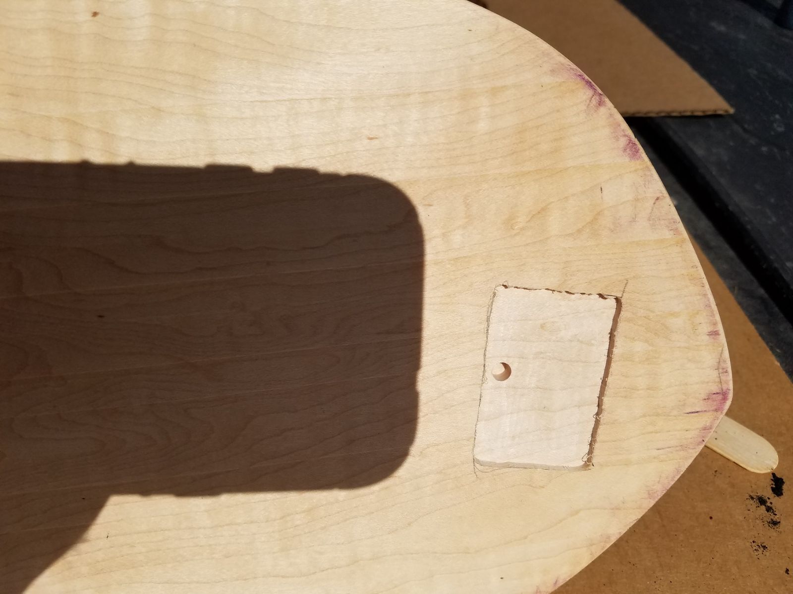

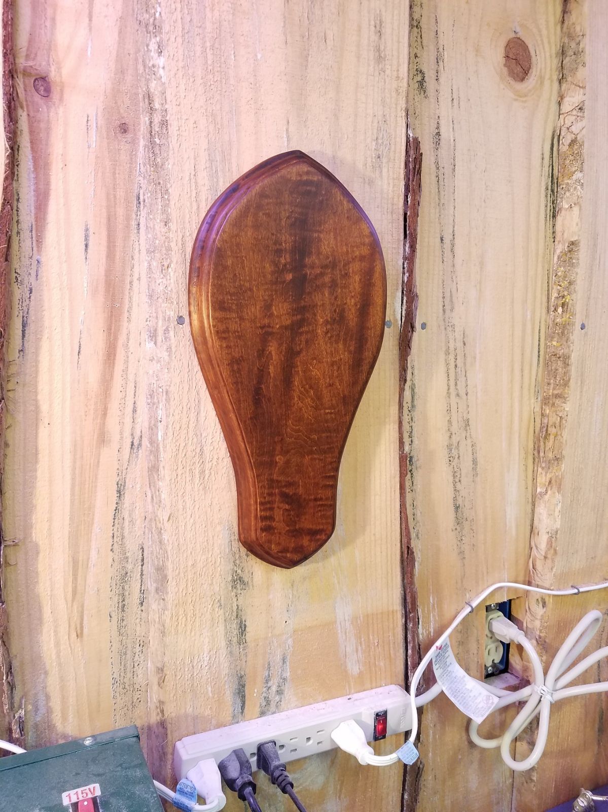

September 12, 20215 yr Author Popular Post comment_271048 Recessed a little spot for my hanger,..have some stain down...may knock back a little more but going to leave this one relatively dark. Oil finish will change the look of it,..final cleaning and whiten up the skull a bit, and then attach. Report
September 12, 20215 yr Popular Post comment_271061 In routing maple, I've had some luck dampening the profile before the final cut to depth. Report

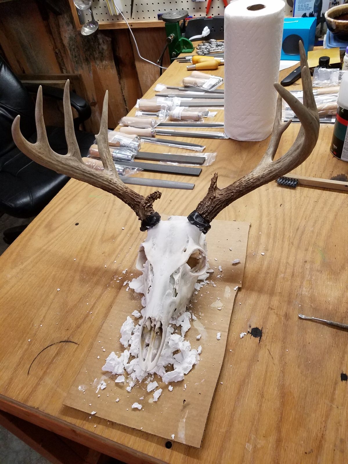

September 20, 20215 yr Author Popular Post comment_271455 Got a little more done today. Skull is whitening tonight, and whipped up some home brew finish for the plaque. Got it applied and done. Sometime in the next few days I'll give the skull a once over and then attach. Last thing I'll do is mix up a little bondo and chopped fiber glass to put in the brain cavity. It will give me something secure to screw into when the skull is mounted to the wood. Report

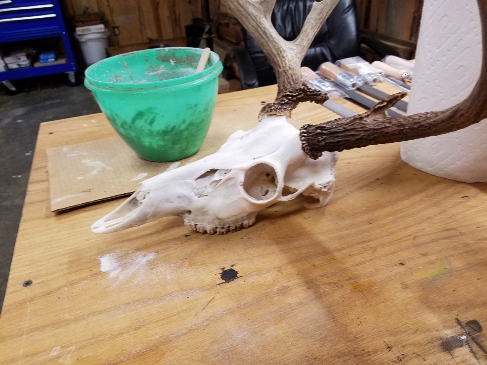

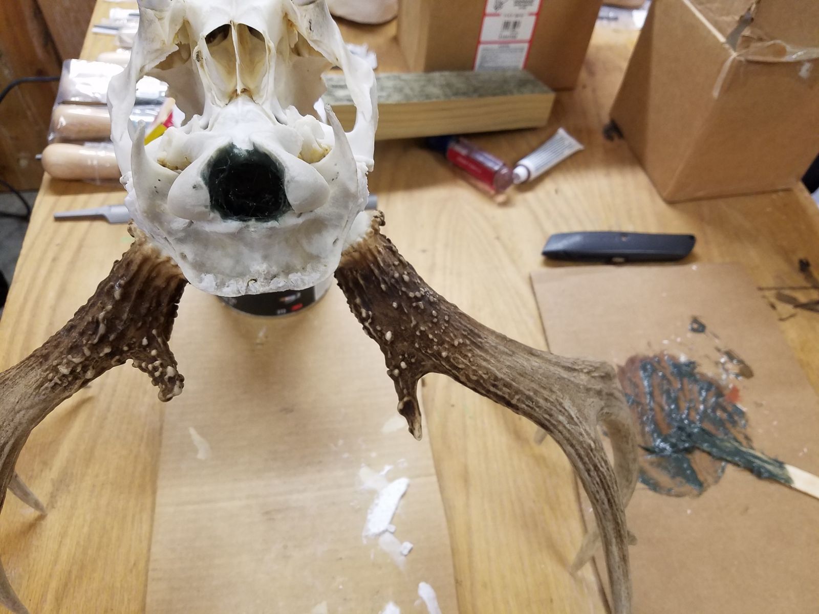

September 29, 20215 yr Author Popular Post comment_271970 Added a little bondo in the brain cavity today..it will give me something secure to screw in to. Just something I saw somewhere and started doing..there are stories out there of various mounts and euros falling off of walls. The bones are relatively thin and brittle anyway,...just depending. Will be attaching to the plague next session. Report

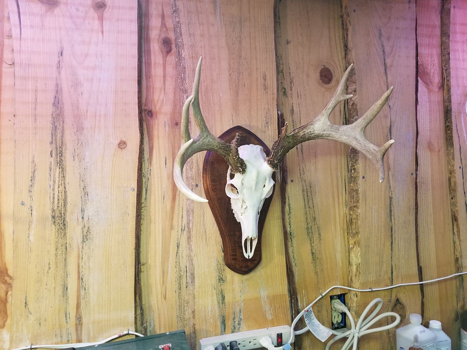

October 2, 20215 yr Author Popular Post comment_272108 Finished today.........on to the next one Edited October 2, 20215 yr by aaronc Report
