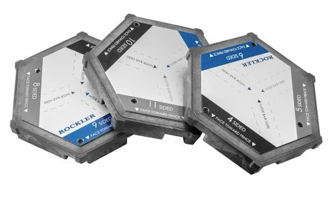

Paul, is this the one you are thinking about?
image.png.ed619f0395b15c936429202b05189afb.pnghttps://www.rockler.com/rockler-perfect-miter-setup-blocks
I have this set, but I haven't tried it out yet.
Edited by PostalTom
Added a thought.
I have a set and use them all the time. Very accurate. It’s a big time saver. The standard ( non segmented ring) version is nice for setting odd angles. You can adjust it in 1/2 degree increments.
