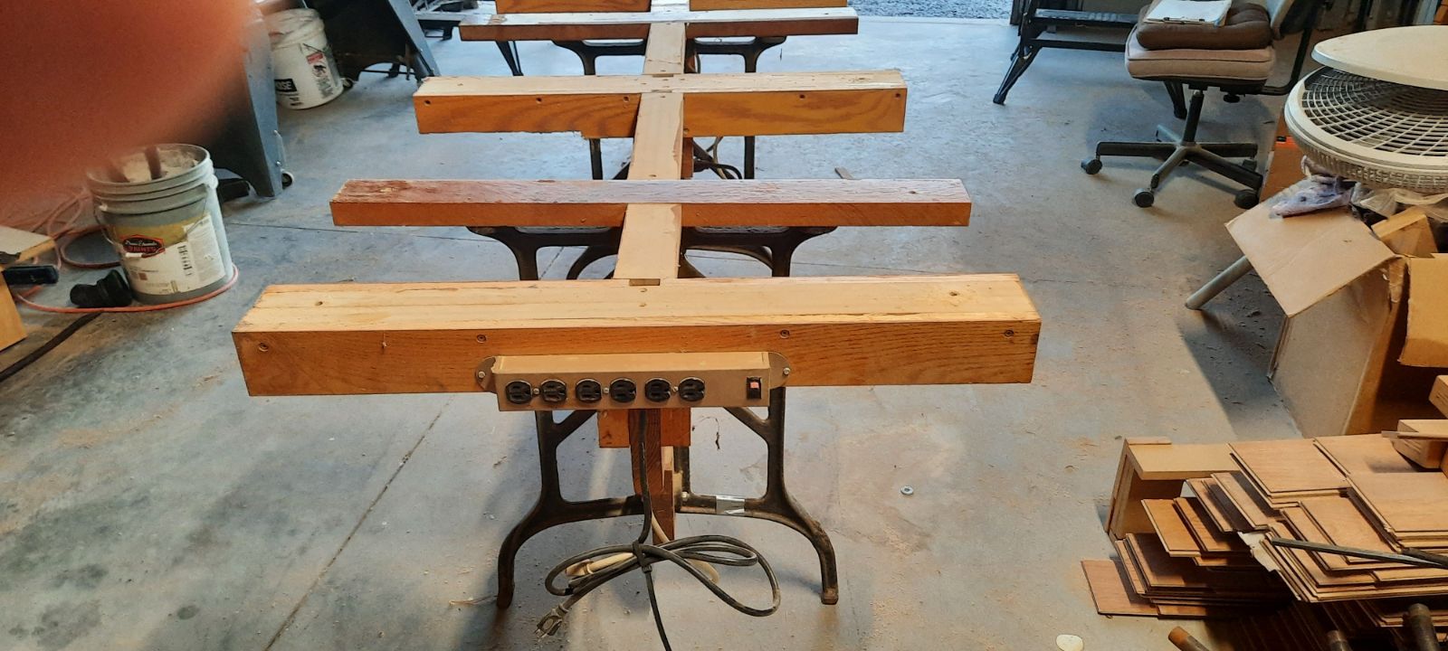

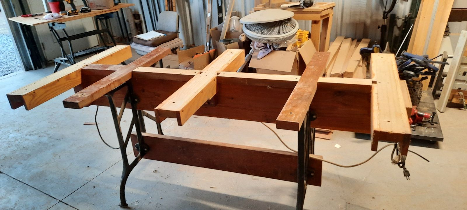

Here's the bench under carriage. The Cast iron legs were a gift from an old machinist, about 35 years ago. They were the legs to his bench. he said they were from the late 1800s.
:ChinScratch:...Must be one of those tropical illusions, in this photo it almost looks like three sets of legs. :unsure:
Holy Sniky!!!!
