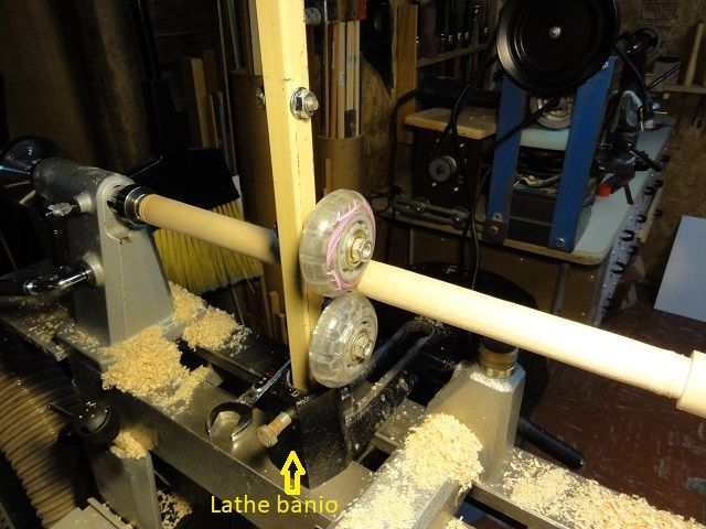

I used roller blade wheels . Git the skates for $4 at mission store. Used the better one as sone were really worn.1312554584_lathesteadyrest.JPG.411e8c1c7fce12ff47a3111bd22a3826.JPG

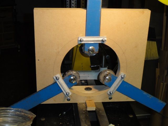

I have one I made similar to Geralds.
I found that for spindles two wheels work just a well but are easier to use.
