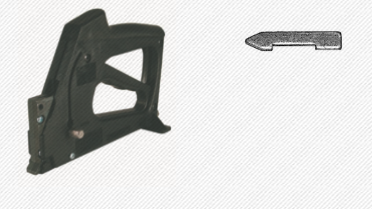

December 28, 20205 yr Popular Post comment_252718 I have one of these. The thin pins don't need a lot of frame "meat" to hold securely. Report
December 28, 20205 yr Popular Post comment_252720 1 hour ago, Fred W. Hargis Jr said: So is that point driver a spring loaded thing, like a stapler? Yes, you squeeze the handle and the point shoots out, parallel to the base. Sort of like a stapler but the fastener goes out straight instead of down. Takes about 10-20 seconds to secure everything. Report

December 29, 20205 yr comment_252755 This is the one I got few years back. Got it off ebay but here is Amazon link for it. Amazon.com: Logan Dual Point Driver Elite and F53 Flexible Point Strips Pack of 600: Arts, Crafts & Sewing Report
December 29, 20205 yr Popular Post comment_252762 14 hours ago, kmealy said: I have a "point driver" that makes inserting fast and easy. https://www.unitedmfrs.com/Framemaster_Point_Driver_p/f07500.htm You can buy a tool that pushes the points in, but it doesn't work for all frame shapes and is not significantly cheaper. It takes both "framer's points" (longer) and "glazier's points" (shorter). The latter you use for securing glass in a rabbet. I also have my own mat cutter. I have done probably in excess of 200 frames, so I think they have paid for themselves. I've also repaired a few mirrors and frames on moving repairs, so used them for business. This looks like one of those tools you don’t use for long periods.....but when you need it nothing else will do the job as well. Report
