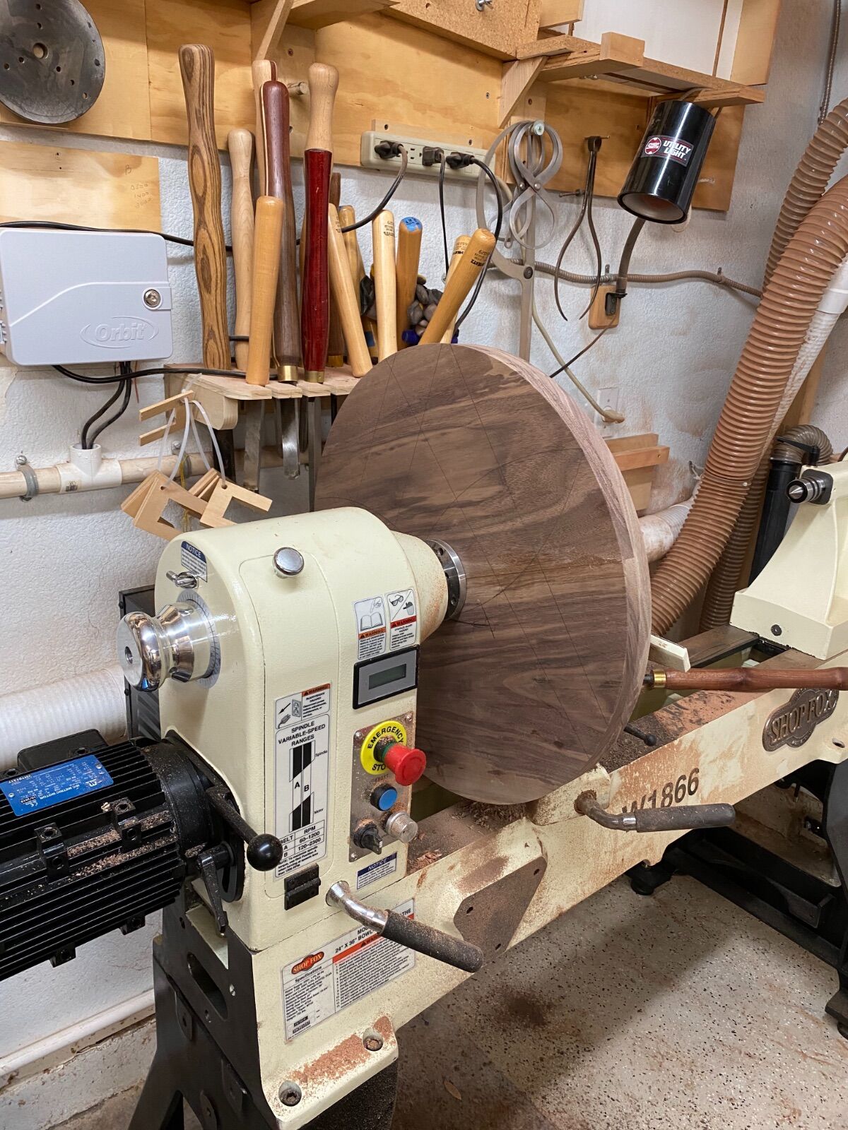

Popular Post Masonsailor Posted December 11, 2020 Popular Post Report Posted December 11, 2020 Got a chance to mount a small block of mahogany on the new lathe and also glue up a larger platter. So far so good on the lathe. As usual compared to the Shopsmith it is very high. It’s solid as a rock and seems to function well. Having the ability to go down to 25 rpm is interesting when applying finish. There is absolutely no vibration. One drawback is that all my faceplates won’t work and Grizzly seems to be out of their 6” faceplates. Also my G3 chuck needs an adapter which is two weeks away. I did get a faceplate from Maxwood but it takes a 1/4” spacer to work on this lathe and it is also two weeks out. So for now no chuck and one faceplate. Paul Gerald, Larry Buskirk, FlGatorwood and 8 others 11 Quote

FlGatorwood Posted December 11, 2020 Report Posted December 11, 2020 Glad to see dust and shavings on that new machine. It is working as desired. And, mahogany is great to turn. That is a beautiful footed bowl. Great job. Gunny, Larry Buskirk and Cal 3 Quote

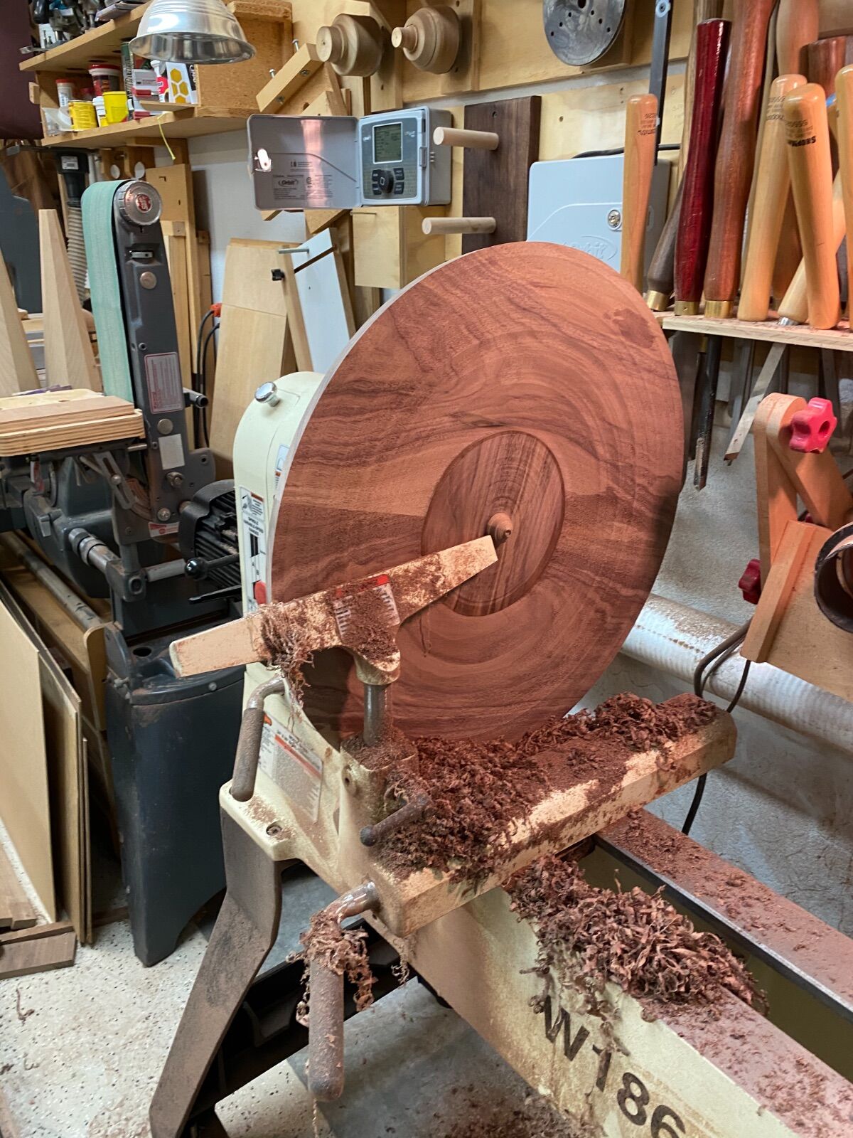

Popular Post Masonsailor Posted December 12, 2020 Author Popular Post Report Posted December 12, 2020 So I couldn’t resist and I glued up a large walnut panel to turn. Paul DuckSoup, Gunny, FlGatorwood and 5 others 8 Quote
lew Posted December 12, 2020 Report Posted December 12, 2020 Is that hot glue holding the waste block on? FlGatorwood and Cal 2 Quote

Popular Post Masonsailor Posted December 12, 2020 Author Popular Post Report Posted December 12, 2020 (edited) No that’s not a waste block. It’s the foot of the bowl. I glued it on with Titebond 3. I only have the one faceplate that fits and one other that works but needs a spacer. The plan is to turn the bottom of the bowl for which I am using the faceplate that needs the spacer. I just drilled a whole in the top of the bowl to compensate for the protruding spindle. The set screw will not work without the spacer so I just need to be aware not to go into reverse. I am going to shape the bottom of the bowl and cut in a 1/4 inch depression to fit the good faceplate which will help center it, turn it around and shape the top. It will also give me a 3 1/4” X 1/4” hole in the bottom which I plan on using the Shaper Origin to create a decorative disc to glue in and embellish the bottom ( and also cover the screw holes) per Patriot Woodworking protocols Paul Edited December 12, 2020 by Masonsailor Larry Buskirk, FlGatorwood, p_toad and 4 others 6 1 Quote

Popular Post Masonsailor Posted December 13, 2020 Author Popular Post Report Posted December 13, 2020 Spent most of the day on the media room but did get a few moments on the lathe. The bottom is done and I carved out the recess for the other faceplate. Tomorrow I will flip it around and start on the top. Paul Cal, lew, Larry Buskirk and 5 others 8 Quote

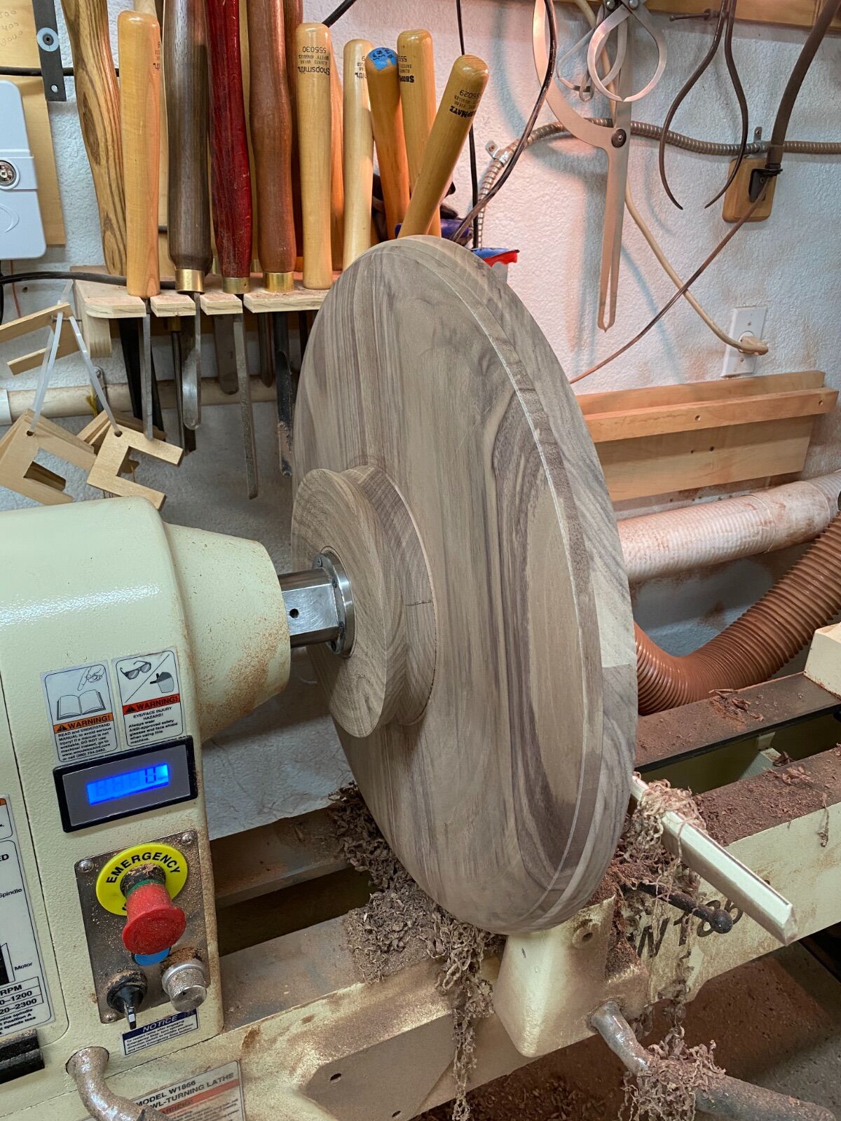

Popular Post Masonsailor Posted December 13, 2020 Author Popular Post Report Posted December 13, 2020 Thanks Rusty. It’s very smooth and very heavy. So far I am very pleased. This morning I did get the other faceplate mounted, turned it around and started shaping the top. Black walnut is wonderful to turn. It comes off in these fluffy ribbons. Paul HandyDan, p_toad, Larry Buskirk and 4 others 7 Quote
