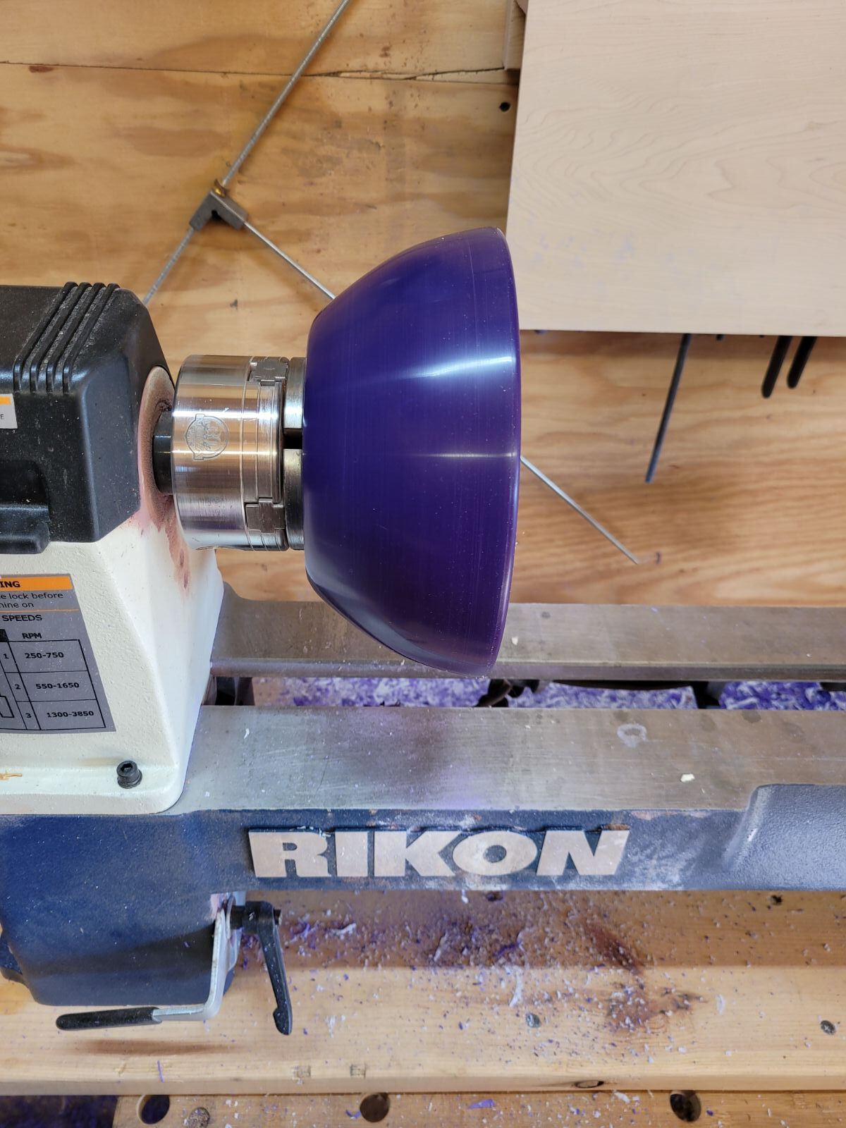

November 22, 20205 yr Author Popular Post comment_248763 Well I picked up six balls. I got started on one today. Report
November 22, 20205 yr Author Popular Post comment_248790 I tried using my vacuum Chuck to get the mortise done so I could chuck it. Did not work too well. Kept slipping a little and vibrating. Next time I will try it with my regular chuck. You have to go slow because it chips easy. I was using carbide tools. Report

November 22, 20205 yr Author comment_248847 Dan not easy to see but in the first picture you can see the large white center. It probably would have shown up better but I took the picture in a hurry. I had to go somewhere. The white center is softer so that should make hollowing it out easier. Paul I don’t have a sander large enough. Next one I do I will use my four jaw chuck and that should keep it in place. I turned it slow to keep the mess in a small area. I will speed it up as I get farther along. Report
November 23, 20205 yr Author Popular Post comment_248913 Here are a few more pics. Started to hollow out the inside. Drilled out the center with a 1.5 inch forsner bit. Then started to work it out with the round carbide tool. Have to go slow. Well the picture of the inside didn't turn out. Will have to take another one. Report

November 23, 20205 yr Author Popular Post comment_248921 The white looks like it will also finish smooth. Report

November 24, 20205 yr Author comment_248978 8 hours ago, Gerald said: Is that a wood center? Think it would be cool to shape the outside so the white shows in some areas. No there is no wood. I think it is some sort of acrylic but not sure. If I go slow it comes off in long strips just like the purple. Report

November 27, 20205 yr Author Popular Post comment_249367 Well it is done. Wasn’t too bad and didn’t make any more mess than a wood bowl. The secret seemed to be to turn it slow for the major rough out and then speed it up to get it smooth. Report
