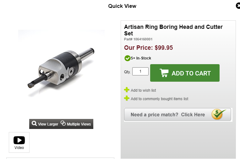

When I went to turn the handles I realized it would be a chore to recess the heads.  I did cut the heads all the same size but didn't think to size them to a drill size, duh.  I ended up using my boring head I purchased from Craft supplies.  @lew posted this video in his January 15, 2020 Wednesday's Wisdom thread and I was inspired to purchase one.
Got it dialed in and everyone was a great fit.

9 minutes ago, lew said:
Looks like that boring head is a really precise piece of machinery.
Yes it is.  It mounts in the M2 tail stock taper.  Had to make adjustments for the small amount of slop in the "tail stock" but it worked great.
How much was it?
6 minutes ago, Gunny said:
How much was it?
Here is a picture of the set.  There are 9 cutters come with it.
