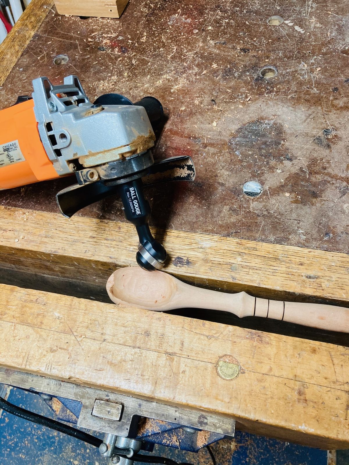

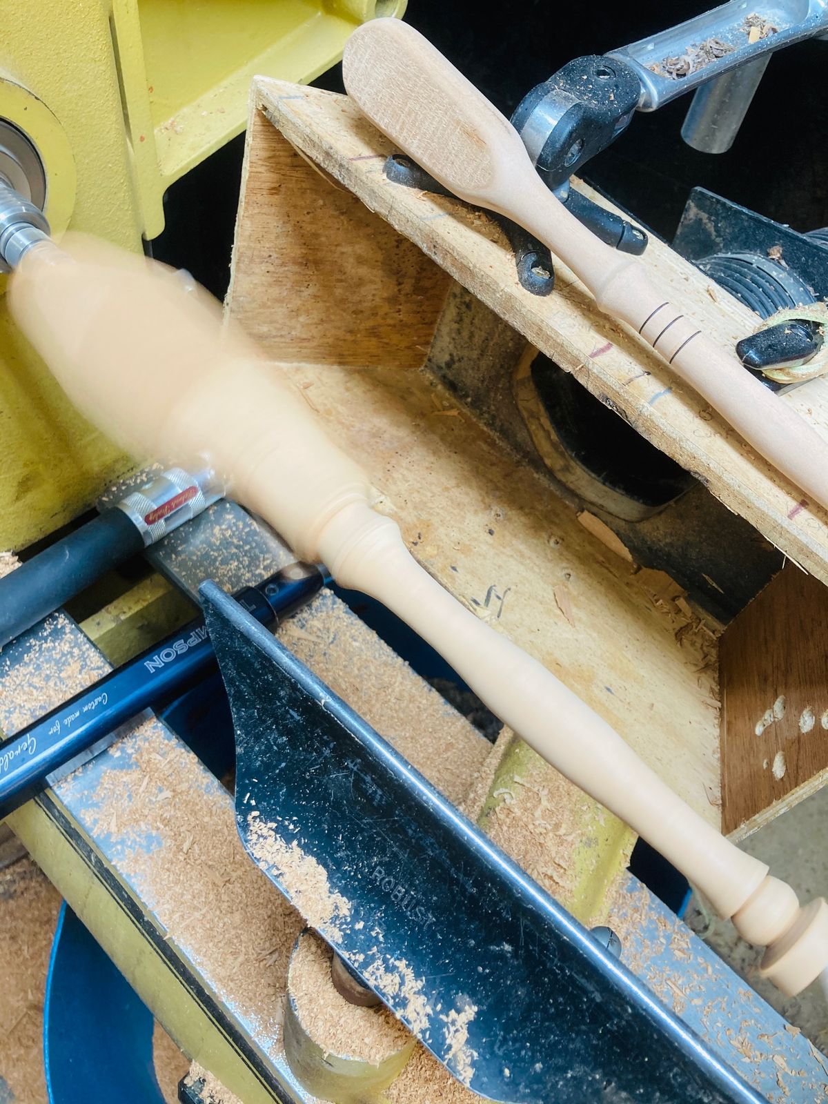

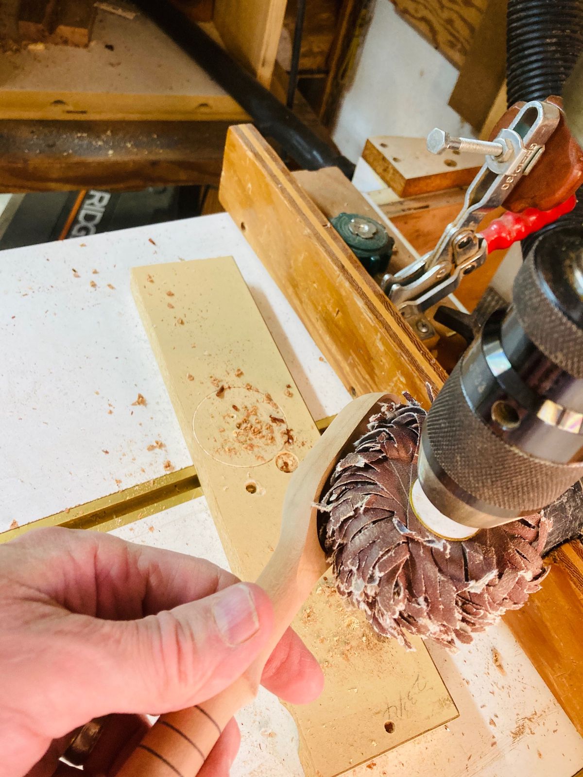

October 23, 20206 yr Popular Post comment_246158 I posted I was doing spoons a week or two ago and @John Morrisasked for my method. Well here it is. I am using dimensional rough sawn cherry for my blanks and saw them out on bandsaw. When I mount on lathe the head of the spoon is at the headstock in a drive spur . The side to be carved is mounted slightly lower than the edge of the spur. This allows the back to be turned almost round. At first I tried for more round but the bowl was a little narrow so I now leave the back flat and sand it and then sand a roundover transition to the sides. Then the handle , knob and back of bowl are turned. Now I carve the bowl using a Arbortech ball carver. Since the end of the bowl is end gran it breaks out easily so after learning that lesson I left that end thicker and then sanded the outside end to get final thickness. Then using a flap sander in drill press I sand inside the bowl . Report
