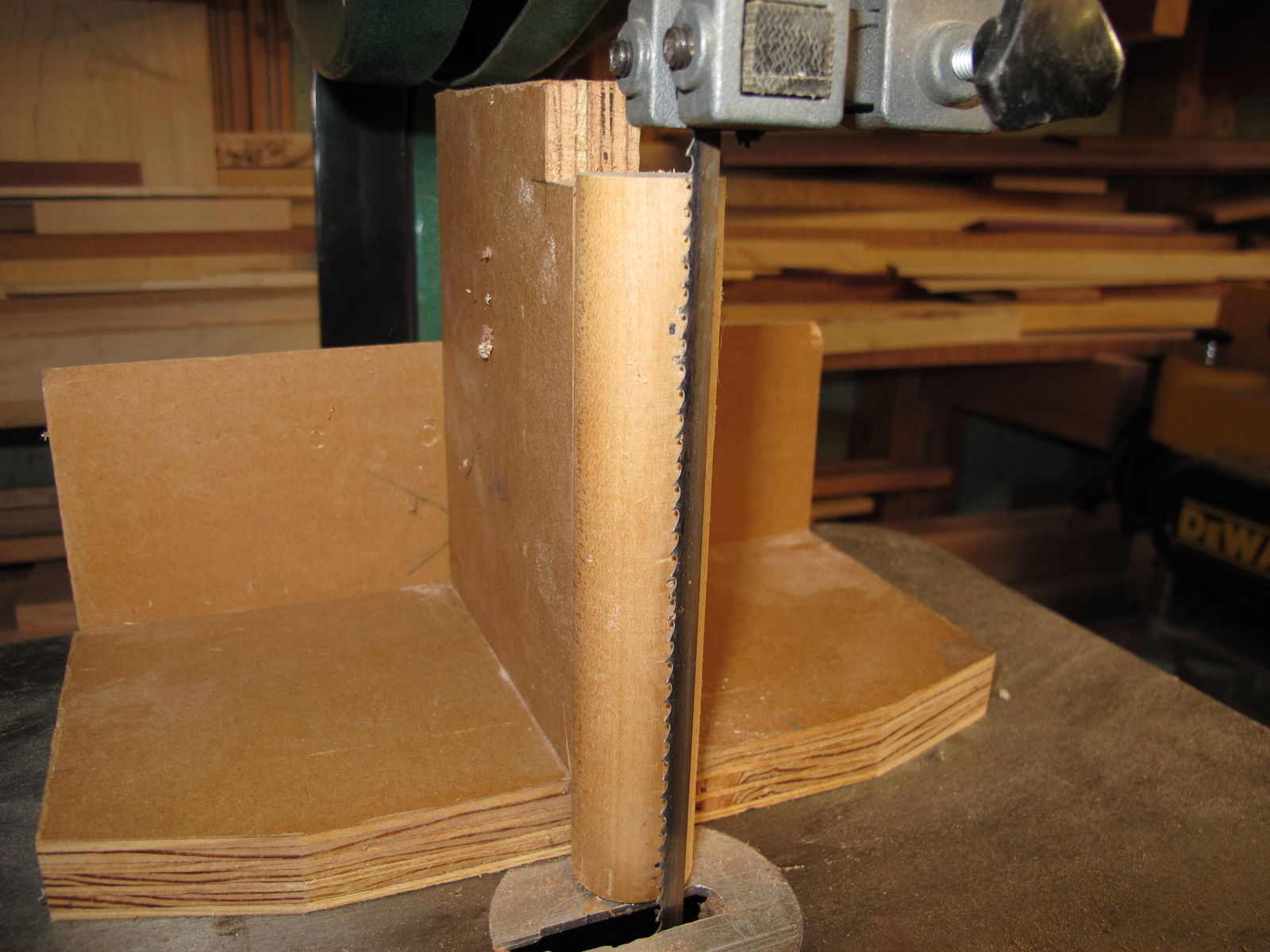

A fence can be any piece of straight material clamped to the table. Mine is a 3" high piece of 1/2" Baltic Birch ply attached to a 2" wide piece for clamping. Unless you are very lucky, you'll need to angle your fence to account for drift.
 to gauge the drift, strike a straight line on a sufficiently long (24" should do it) flat piece of 3/4 X 6" material and cut to the line for about 10-12 inches. You'll likely need to skew the material right or left to maintain your line. Stop cutting at about 10-12 inches, maintaining the boards angle. Shut off the saw. Holding the just cut piece in place, set your fence to match that angle.

Try to get the blade so it runs in the middle of the wheels.... Then you have a blade that is running straight up and down when it enters the wood. This is how a blade is made but when a person has it set to run on the edge of the wheels is when it will not go straight through the wood...
I could never get my Taiwanese bandsaw to cut straight using a standard fence. I made a pivot point "fence" that works pretty good but it's not perfect. Set it so the blade teeth are aligned with the center of the pivot and clamp it to the table.
Kevin, the saw should have two sets of guides on it....one set above table and one set below.  Most are about 1/4” square.  Make sure these are near the side of the blade.  If not, the blade will walk on you.

Got them from Carter. I bought two different sets. One for doing scroll work and one for regular stuff. Changing out wasn't difficult at all. Took about an hour, IIRC.  They make a world of difference.
I will vote with Gene on the Carter guides. Even with a kinked blade they still give a pretty fair cut, with good blade it is amazing. Mine came from Rockler when they had a sale on.
Roller bearings make far more sense to me than cool blocks.  Those blocks seem as if they would provide more resistance to the blade while a bearing would have minimal resistance.  I will investigate that soon.
