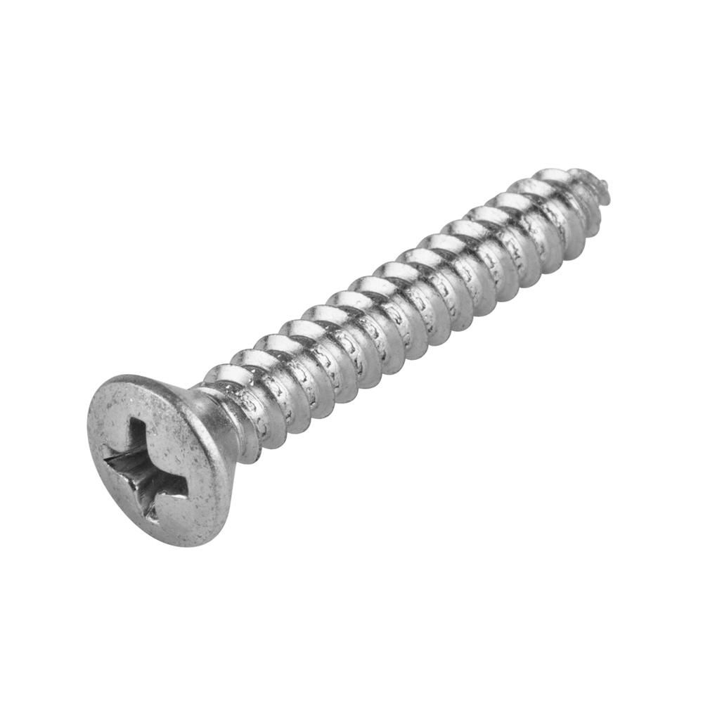

June 4, 20206 yr comment_231158 Okay I'm running into a couple minor problems. I basically ruined a piece playing with the new jaws but that's okay. I was prepared for that. A new piece is being glued up and getting ready to be worked hopefully for later this evening. How ever I'm running into a slight bit of a problem and am in need of some advice. I've been using short screws with the face place in order to make sure it says tight. That worked for a bit now I'm finding that sometimes the screws are actually getting broken off in the face plate which is not a good thing. meaning the heads snapped off. Probably due to operator error. how ever that was solved. I think I am using too small of screw length wise, the piece doesn't get enough grip I guess and it comes loose from the face plate. What would be the suggestion here to solve this problem. Being safety cautious as I am I don't let it make me jump but I don't want to break a hand or worse hurt someone else with a flying projectile. Suggestions would be helpful. Thanks. Report
June 4, 20206 yr comment_231161 I use pan head sheet metal type screws. Try to use screws that have a diameter close to the diameter of the holes in your faceplate. Report
June 4, 20206 yr comment_231162 If your faceplate has countersunk holes, then this type of screw can be used- Report
June 4, 20206 yr Author comment_231163 I don't believe it does fair enough I'll run over to home depot in the AM and pick some new screws up for that purpose. Thank you kindly. I honestly wasn't expecting the v groove jaw attachment wouldn't of been as heavy as it was but it was at least 5 pounds LOL. Report
June 4, 20206 yr Popular Post comment_231165 I am with Lew on the screw and I use a 12 G screw also. Screws will break if you drive them in without predrilling which may be part of the problem here . Also make sure the surface is flat with a slight dish toward the center. You said something about jaws with no explanation. I am guessing you mean a 4 jaw chuck for which we usually just say chuck. For the tenon there are some other things to know. Ask if that is the problem. Report

June 4, 20206 yr Popular Post comment_231178 The quality of chinese screws is very low. I have been having problems with screw breaking and the head stripping far more easily then they used to. Maybe I'm getting stronger Report
June 5, 20206 yr Author comment_231254 Welp pre drilling and better fit screws problem solved. Haven't had one pop off yet this morning. How ever I did have to sand down the piece quite a bit so it wasn't as wonky on the lathe while spinning oh well. Either way issues been resolved. Hopefully it doesnt decide to pop off on me when I start to hollow out the piece. But gotta round it first that will probably take some time. Fortunately I was able to secure the screws with just a regular phillips head screw driver since I didn't have a bit small enough to fit for my electric drill guess I'll have to get a bit for it. Report
