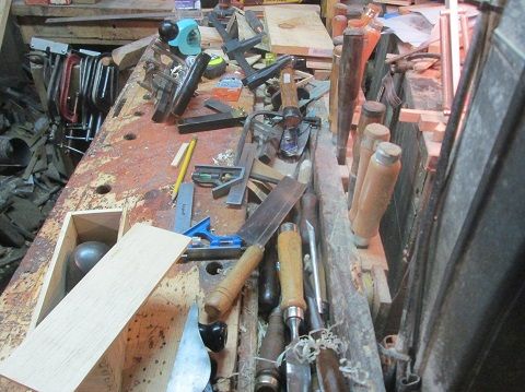

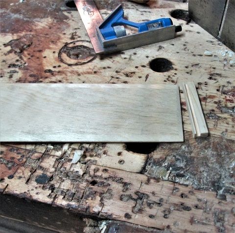

Laid out some more blanks, to make a box for a Stanley No. 18..
Should be enough.   A little bit rough....:ChinScratch: We have ways...:DevilLaughing:

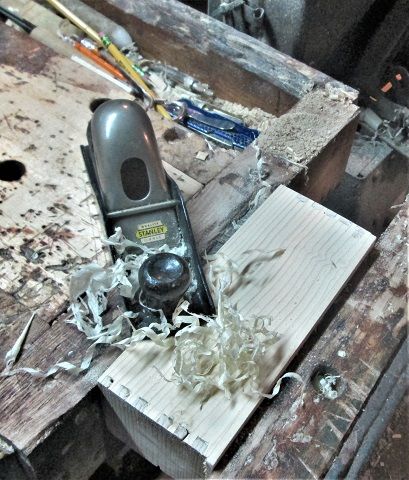

Takes awhile, when you get see-through shavings..:TwoThumbsUp:Then rounded up the Usual Suspects...:ph34r:
Toys?  Seems to fit the scale of the parts, better..pins first..
Yes, I used that toy knife. Was getting ready to trim to the baseline....then used these pins to lay out the tails..
And cut and chop them....repeat for the other corner...

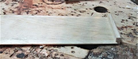

Needed to bevel 3 edges...once I had the width and length figured out..:WonderScratch:..Stanley #110 was still being put to work...more test fits...:rolleyes:
Needed this to size the other end panel...as it will also provide a handle...:ChinScratch:
Big piece will get dovetailed in place, the other will get a rebate, and glued to the lid.  B)

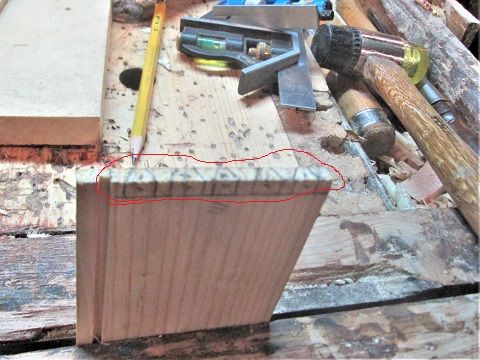

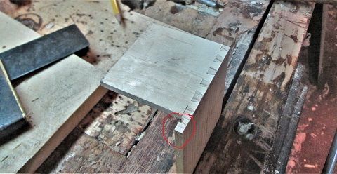

Have had better days in the shop....at first...the corner joints were looking good..
Circled area is the groove for the sliding lid...then came the last corner....laid out for the pins...:rolleyes:
Bad enough I had these backwards..:ArguingSmileys:.then I cut and chopped them out....was wondering why the tails were looking...funny:WonderScratch:..THEN I figured out the problem:BangingHead:
Had to go back and re-do a new side for the box, complete with the groove...and, re-do the end piece from scratch.:ArguingSmileys:

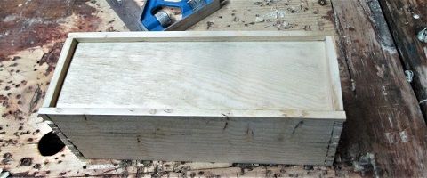

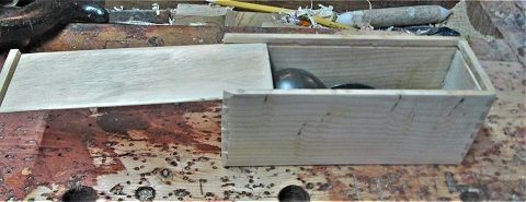

Test fit....then made sure it fit the box...:TwoThumbsUp:
1064744655_DovetailedPlaneBoxtestfitlidandhandle.JPG.5e6d8f72e4bde714f24647b889fb0808.JPG
Seems to fit ( but, which end?:WonderScratch:)

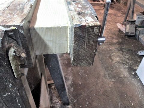

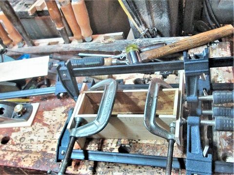

Guess the glue , cauls, and clamps can take over? :ph34r:  Well, after I check that the plane still fits..

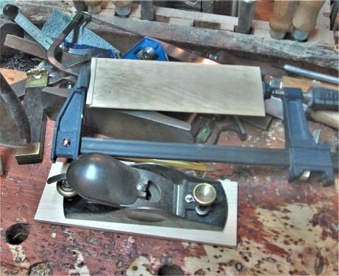

And, that the panel for the bottom of the box is the right size:ChinScratch:
Close enough.   Set the panel aside, with the plane on it, and glue up the lid and handle..:TwoThumbsUp:
Which left the four sides to do...:SaluteandRun:
369860033_DovetailedPlaneBoxenoughclampsmaybe.JPG.d85f849a4b03b45d0b8e9599c9e52ea7.JPG
Hmmm, only needed 5 clamps?   Will let this sit overnight...might try to clean it up, then....:ChinScratch:

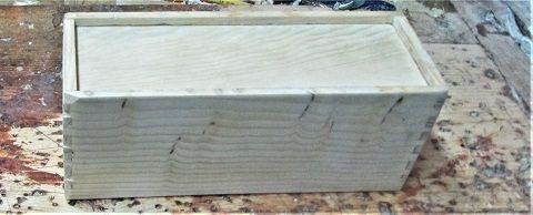

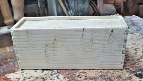

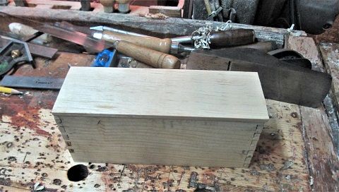

Out of the clamps, for a quick clean up.   Panel for the bottom was roughly trimmed to size....then glue and a single clamp...:SaluteandRun:
Let this sit all day....then, this evening...moved it around and did a bit more clean up...:ChinScratch:

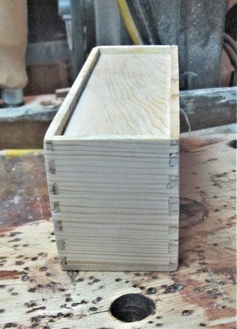

Until the end looks good...:TwoThumbsUp:
And the sides..

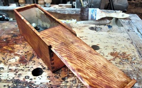

Opened the lid, and waxed the bevels...:SaluteandRun:
And, to make sure the candle wax was spread into the grooves...
Just slide the lid shut a few timesB)
Even after the Brew was added...
And, yes, the plane does fit the box..:ChinScratch:
Letting the stain dry overnight, then see IF it needs a second coat.
Stay tuned...:TwoThumbsUp:

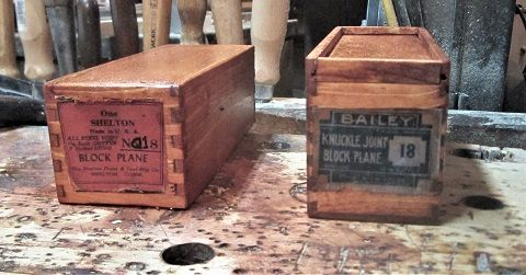

a Label has been found...
21472610_Screenshot_2020-05-28StanleyboxlabelsNo18blockplane-GoogleSearch.png.698e7529727e0815d5eb281f911181c0.png
Printed out, trimmed and glue to the box....waiting on a coat of clear gloss to dry...

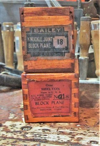

And..installed...
At least they will stack..

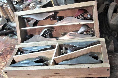

I think I'm done building little boxes....so much easier to recycle a tray, or two..
And just stack these up on a shelf under the bench...
And, that will do it....
